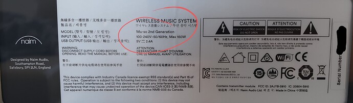

I know it’s a gen 2, the box says so, and also during set up it tells me to go into Google home app to add the device. I also have a photo of the bottom which says it’s gen 2
