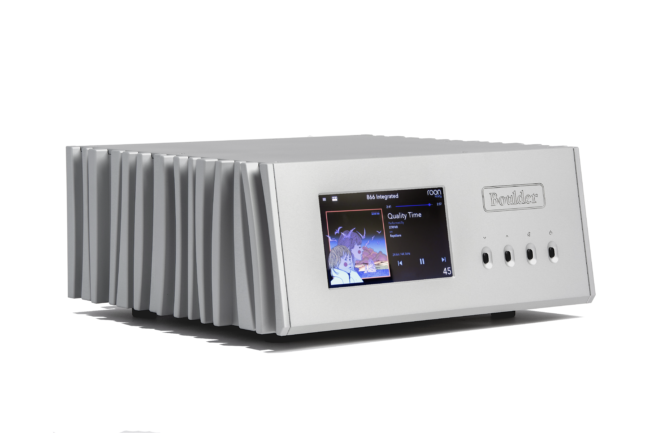

New integrated amp, with streaming dac, phono, Roon, Qobuz, Tidal.
Boulder 866. ( 14k).
Specs look awesome on that! Unfortunately I really don’t want a colour screen on my amp.
