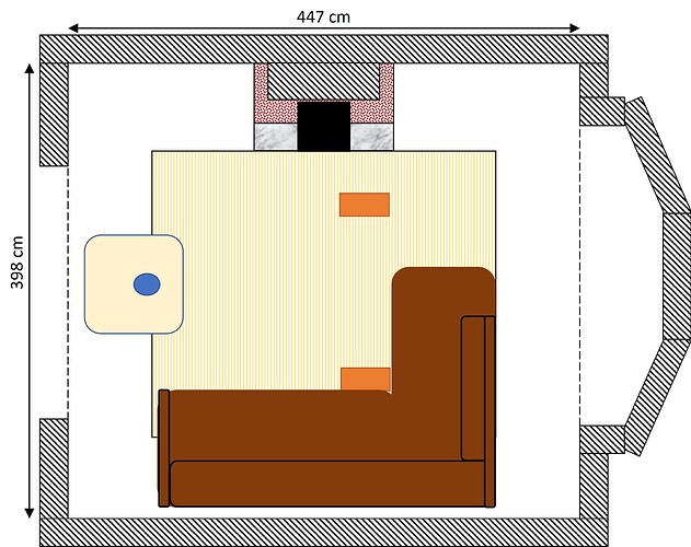

I think the main issue is the speakers are firing down a short length (400cm) and the sofa is placed close to the rear wall. Have you tried pushing the speakers closer to the front wall, say from 133.5 cm to 100 cm, and the sofa pushed slightly out into the room?
I have tried many different placements, even including up against the wall (the distances on the OP figure are just one of the many trials). The deep fireplace in between the speakers doesn’t help with imaging either. There was no significant change in the fundamentals. And besides the B&Ws played quite enjoyably at a similar placement.
Even made an experiment to rotate the speakers by 90 degrees. Suboptimal placement due to constraints by the length of speaker cables, but still no fundamental change/improvement. It was probably even worse like that.

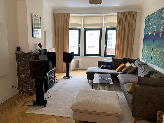

This is how the room looks like right now, so you get an idea. @PeterR Would it make sense to cover the (large) TV with a removable diffusion panel or something when listening to music?
Very nice and neat system. The Dynaudio C1 Platinums look wonderful there. I can’t imagine the music to sound terribly awful there as the speakers have got a lot of space around them. It’s a good speaker placement.
I guess we all have to work with what we have as the room is usually the limiting factor especially when space is limited. With the sofa against the wall, in my experience the listening volume will need to be kept at low to moderate levels to preserve the clarity in the music. The sound will become “messy” when the volume goes above a certain threshold.

The sofa was actually a bit forward in the past. Moved it back into the room by 15 cm now, so when sitting back the ears are at ~40cm from the wall. The theory says optimal position at 38% of the room, which would be ~1.5m, but that’s impossible in any case.
I have thought of rearranging everything by 90 degrees, or even diagonally in the next room, but this is practically impossible with all this furniture etc. Oh well…

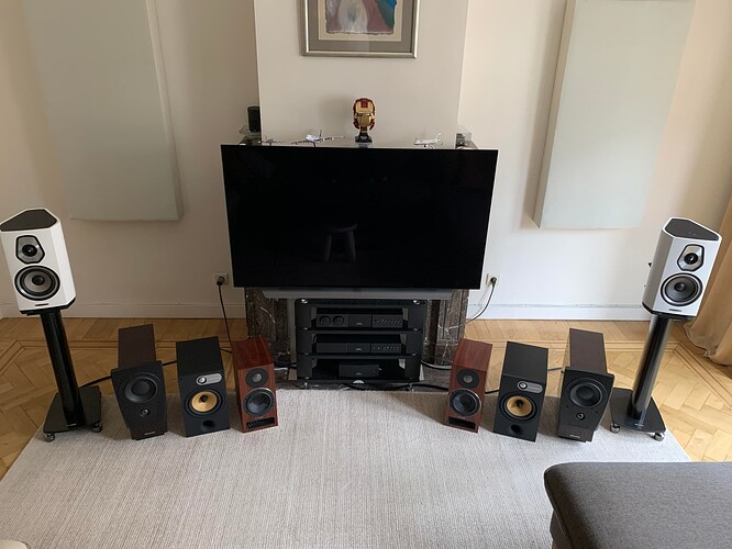

In demo mode since yesterday… The long weekend helped :sweat_smile:
From outside towards inside:
  • Sonus Faber Sonetto I
  • Dynaudio Confidence C1 Platinum
  • Bowers & Wilkins 685
  • PMC twenty5.21 (not i)
Many different price points and very different presentation from each speaker. Still listening so I will summarise my thoughts later this week. Can’t say I have converged to a single speaker yet though.

Based on looks alone, my vote would go to the Dynaudio C1 Platinums with the PMC coming in 2nd although I’m aware that in the end, it’s predominantly the sound that matters. It’s useful that the Sonus Faber Sonetto 1s come with their own stands and have Isoacoustics Gaia fitted below the stands.
The 685 is a pretty old model, I got it second hand pretty cheap for a second system some time ago, and it keeps impressing me with its PRAT! It’s been superseded by 3 generations of 600 Series by now.
The Dynaudios do look the best and their build quality is amazing. Which is to be expected since they cost at least 2-3x the money vs the rest. PMC are the worst looking for my style… :innocent:
The stands are the matching Dynaudio stand (Stand 6) for the Confidence and I have added Gaia III myself. I just plonk whatever speaker I try on them for now. It’s all in my first post but I understand it’s toooo long to read… :sweat_smile: :sweat_smile:
