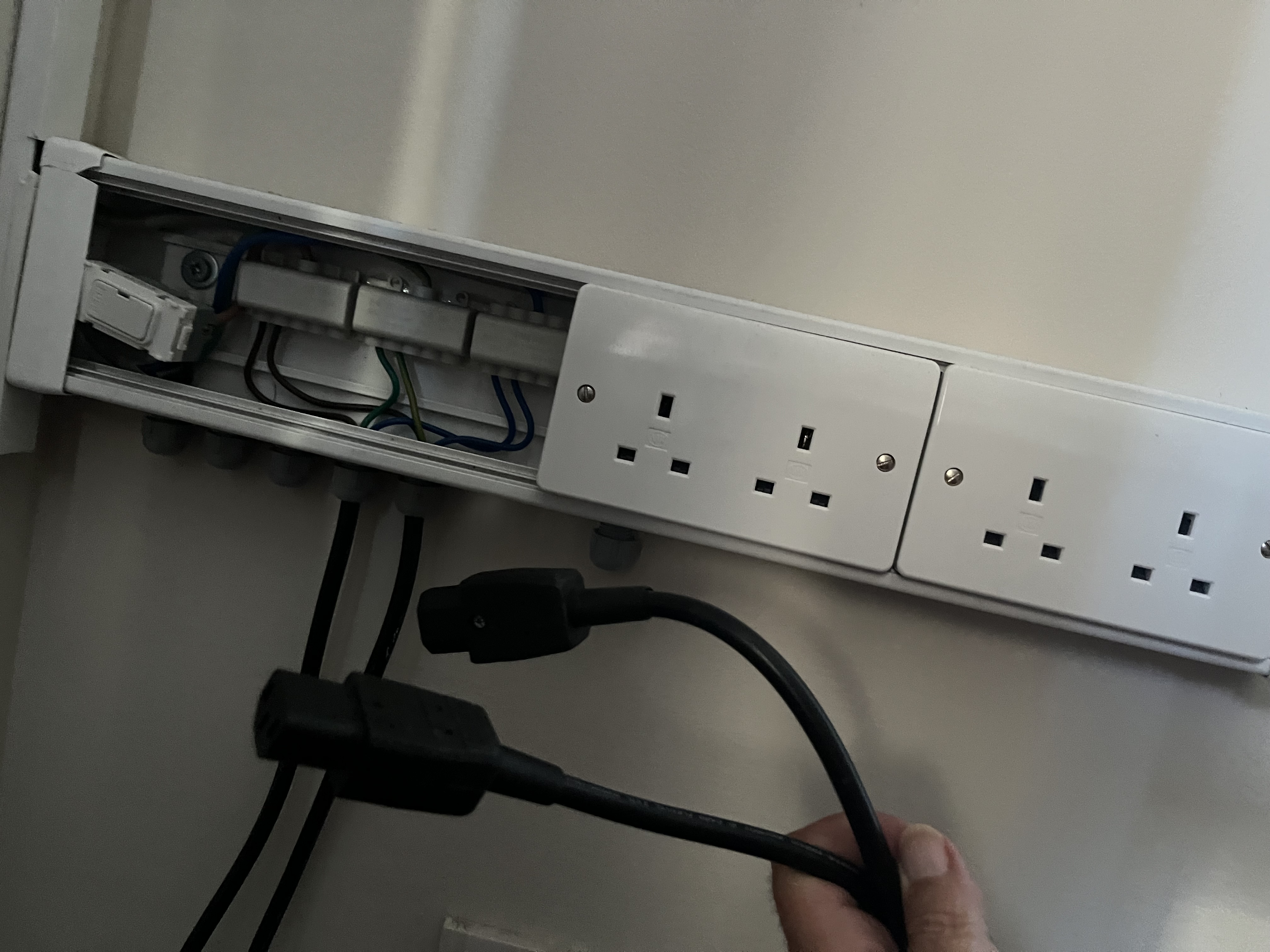

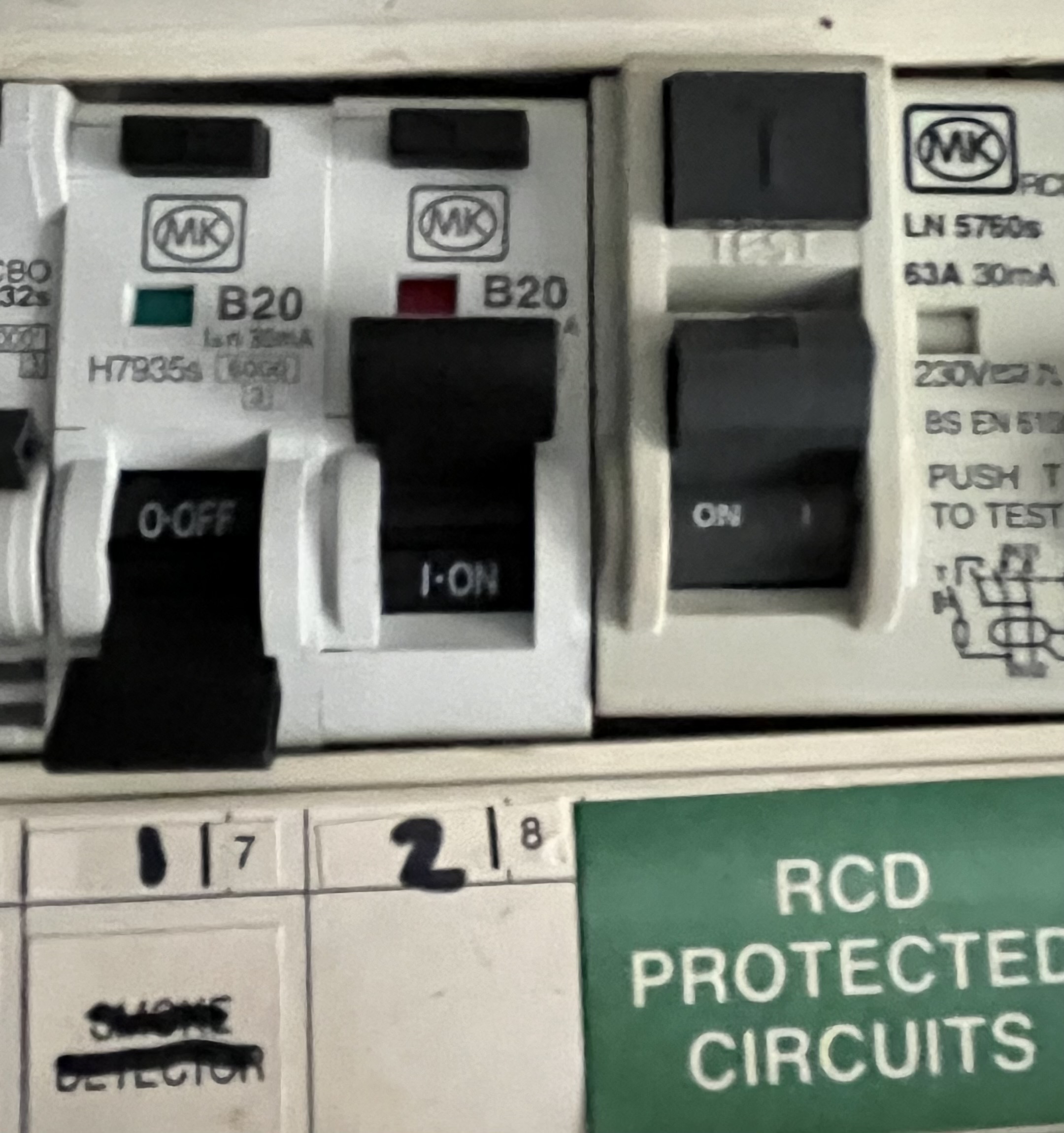

I used 2 runs of 4mm,
1 run for the naim kit
2nd run for Sockets
