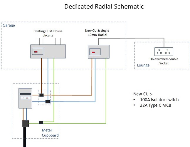

I am a sparky!!! Yes, I really did say that, and I wired a single 6mm radial circuit (not a spur) from a dedicated small RCD protected consumer unit (made by Hager which seem to be good and solid units to me) for my Naim system! It made a massive difference. This cable powers three twin sockets which, somehow, I managed to get all the wires in to (it was a struggle). The main problem with 10mm cable is a practical one rather than theoretical - you cannot get more than one 10mm cable in to the terminals on a socket, so, you either have three separate radials or just the one. Personally I don`t think the extra cost (especially in houses where it is difficult to install the cables) of three radials is worth it. I actually used armoured cable rather than twin and earth which, to my mind, has the advantage of having an earth conductor the same size as the line and neutral conductors. It also has steel armouring that may or may not help to reduce RF interference. Again, the main problems are practical but if you can do it, do it. The main benefits of a dedicated radial circuit are that (according to what I was taught at college) when you plug everything in to one radial circuit you effectively “star” earth the hi-fi - this is a known benefit for reducing mains noise and is sometimes used for IT installations. Also, the big drop in circuit impedance should help your system to deliver current more easily which , hopefully, means more dynamic range, etc.

Exciting times! Mine has been delayed a day so I’ve more time to pettifog over esoterica. I’m going for four I switched sockets. Would anyone have an opinion as to whether this is doable over a single radial or would I need to install two?
As both I and @hoody have said above, you won’t be able to fit any more than one 10mm wire into the terminals, so I don’t see how you could have two double sockets off one radial, unless you use 6mm cable and even 2 x 6mm might be challenging. Why not have a separate radial for each twin socket? This would then give you an option to try using a hydra or MW sparkly block as well as just using the two radials - endless permutations for future tweaking, if that’s your thing! The wire is not that expensive in the grand scheme.

I’d say 6mm single radial, terminated with as many sockets as you require (or even more than you think you need, to allow for possible future system expansion? :roll_eyes:), but, ultimately, it’s your choice.

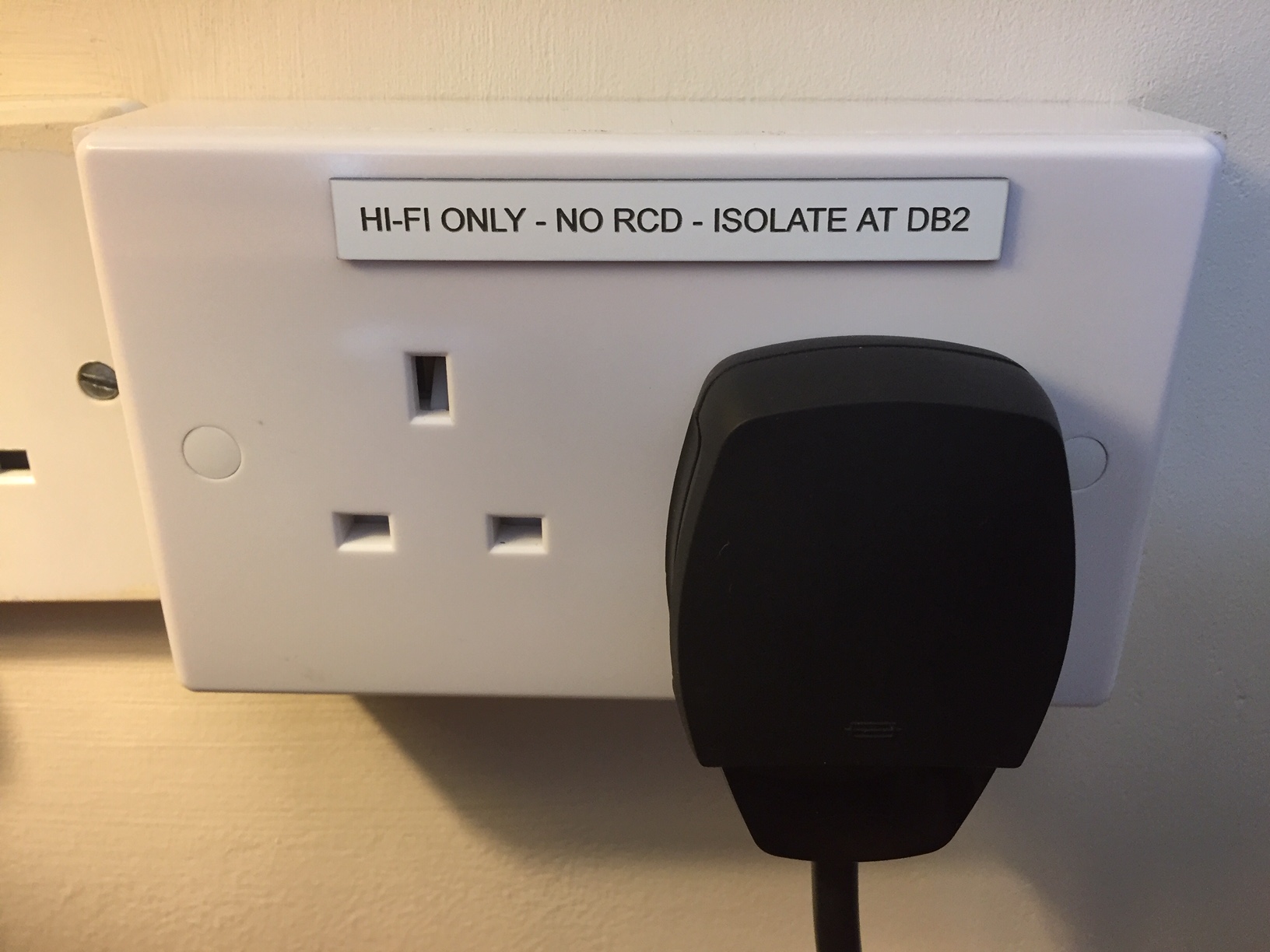

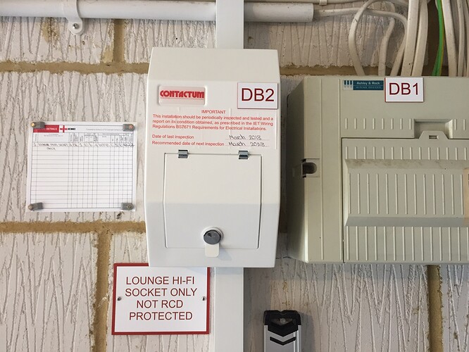

The difference with burglar alarms etc is that they are wired as a permanent installation. The issue with using no RCD protection on a dedicated radial was that it could be used for something other than it was intended for. Ie someone could plug a lawnmower into it and presume it was RCD protected. When I had mine done with no RCD, I had to label the socket as ‘non RCD protected and to be used for Hi-Fi only’ to make sure anyone other than myself and the electrician who installed it knew its intended use. As a few have pointed out this is no longer allowed in a domestic installation in the 18th regs.
