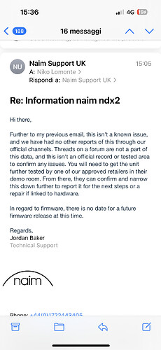

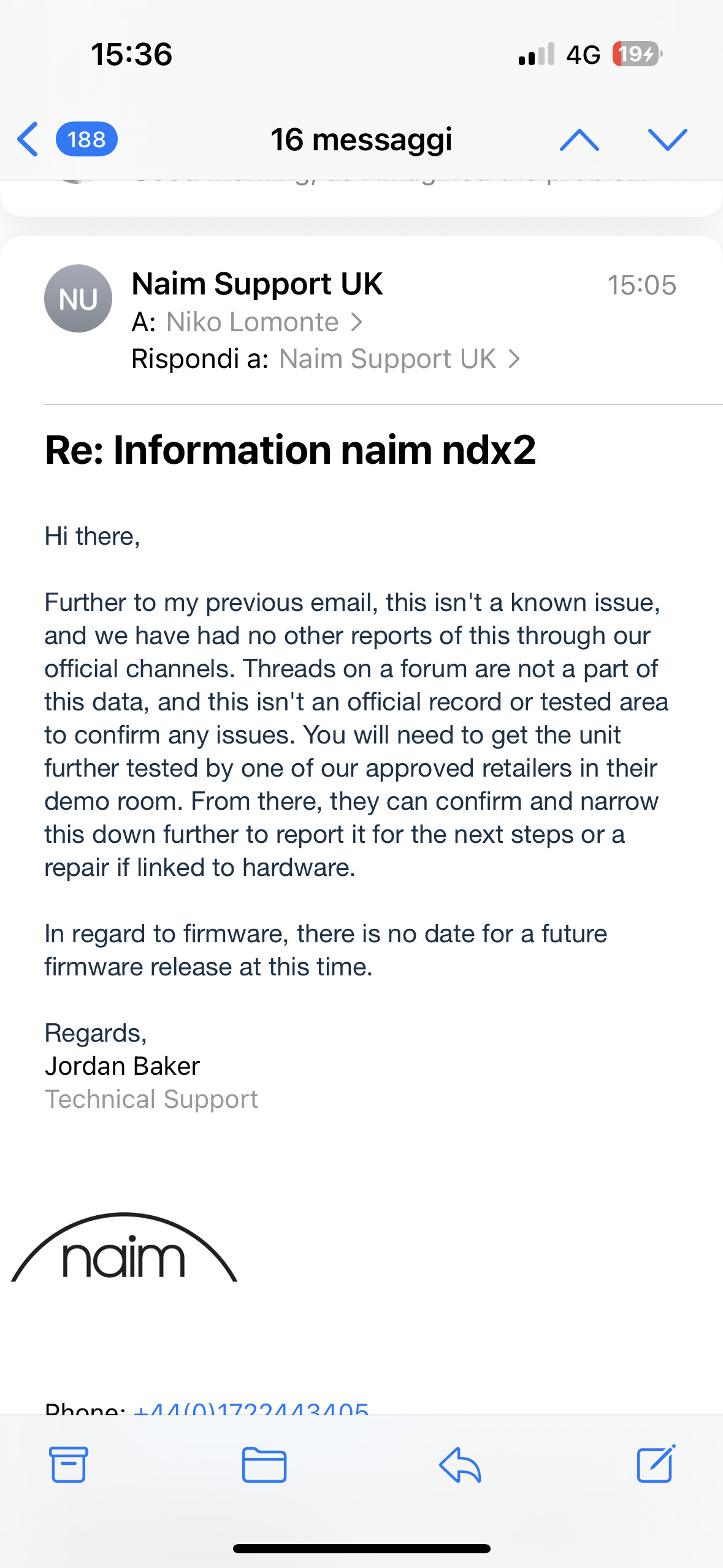

@Protegimus @IainO I pointed out to Naim UK that other NDX2 owners had the same problem as me. They replied like this:
