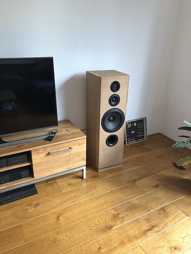

DiY floorstanders for Naim Supernait 2
Read what Troels Gravesen says about 3 way systems you will understand then
Stil in proces to finish.
It’s the vifa vivace 2012
It’s near or maybe better then > 10k speakers :slight_smile:
Later-on i can put my building pics here.
It’s in combination with my SN2 + NDX

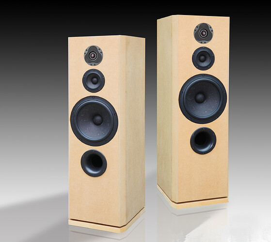

Though I’ve never heard them Wilmslow Audio Prestige at £2850 or £2400 for just the drivers look excellent value. Wilmslow Audio are long established company and very respected when it comes to restoration of vintage speakers especially Tannoy if this means they are good at new and modern speaker designing I do not know but I would give their site a quick look.
Treble: Scanspeak D2905/9900.00
Midrange: Volt VM753
Bass: Volt Rv3143
Enclosure type: 3-way reflex
Frequency response: 25Hz - 25000Hz
Sensitivity (2.83v/1m): 90dB
Amp requirement: 50 - 300w
Impedance: 8 ohm
Internal volume: 70 litres per speaker
Weight: 90Kg per pair
Dimensons (HxWxD): 1050mm high x 360mm wide x 330mm deep
Cabinets come in a variety of veneers and are flat pack. Having been to Mumbai several times and travelled extensively throughout India I have no doubt you’ll find a more than capable carpenter and as there are many hundreds of diy designs available online perhaps sourcing the drivers yourself and getting a craftsman to build the cabs to a plan would be the best option financially.

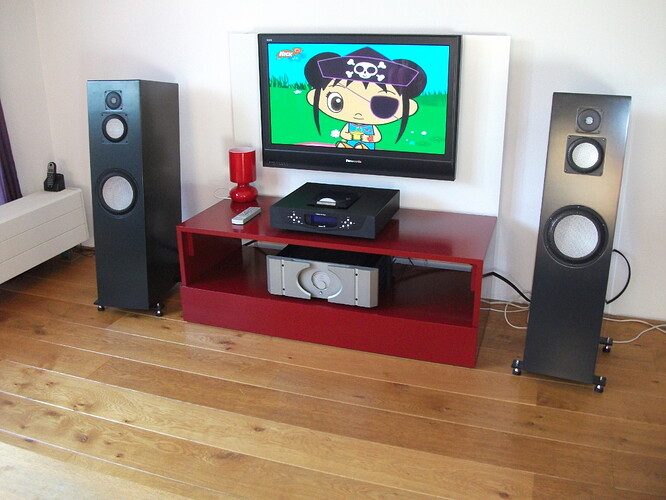

Ik was listening at a DIY store in the Netherlands, (speakerland in Oss (google it :wink: ))

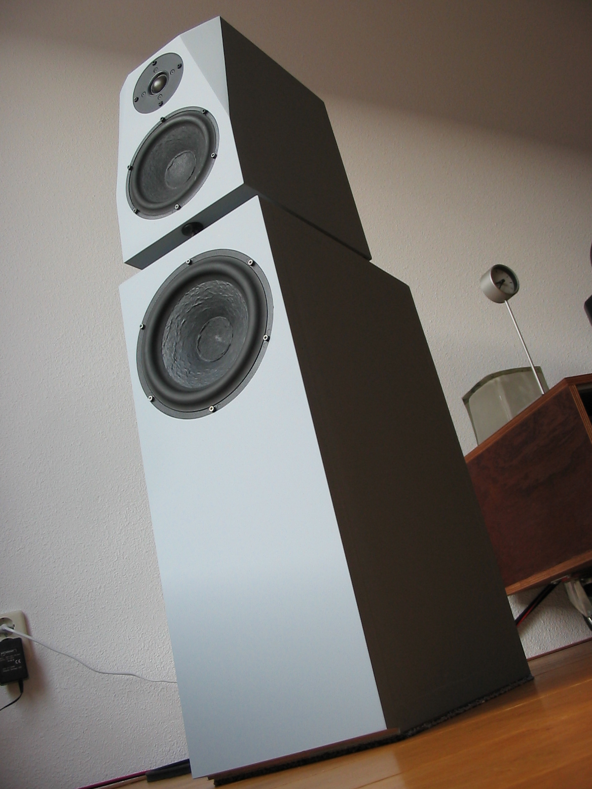

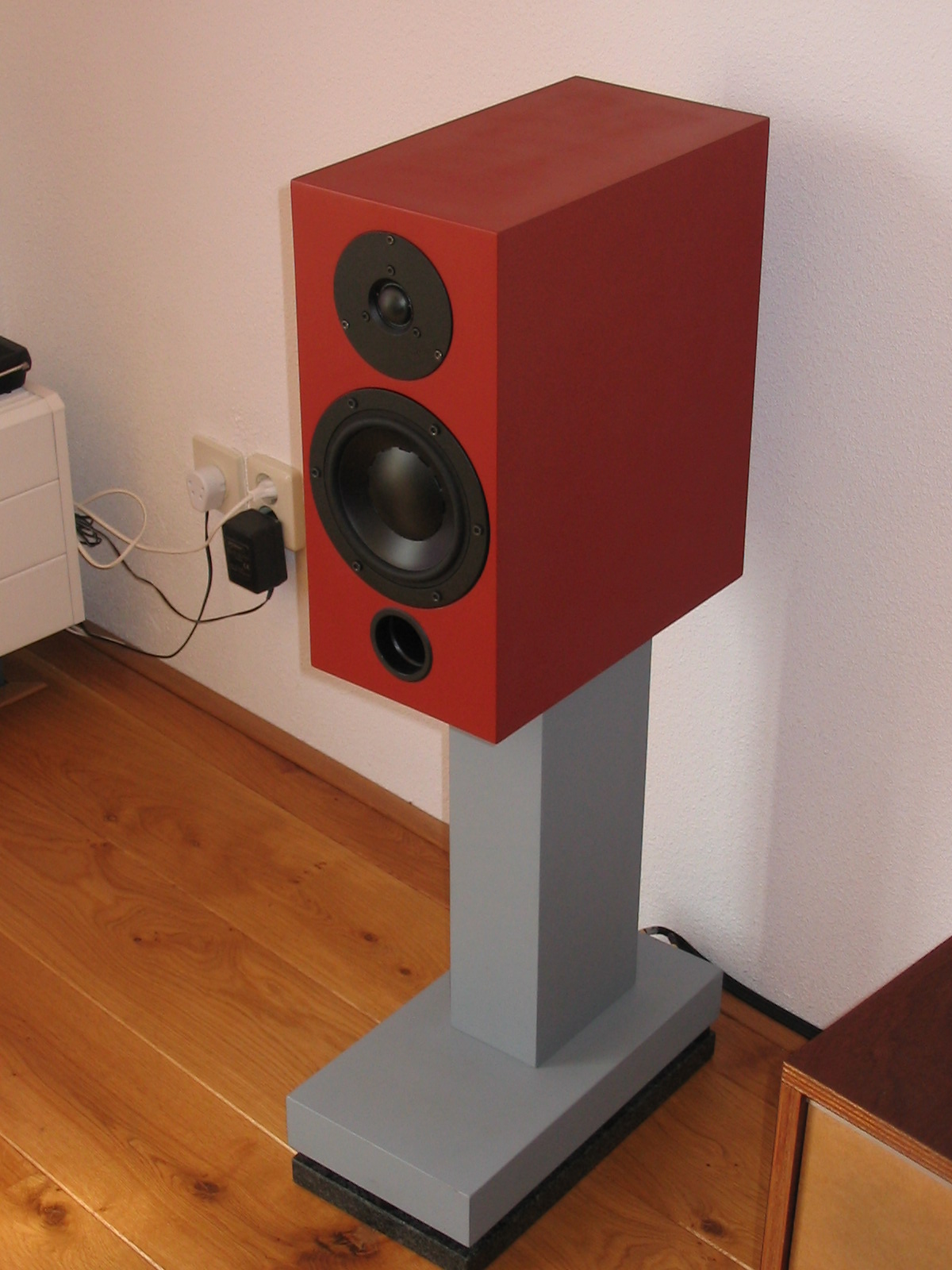

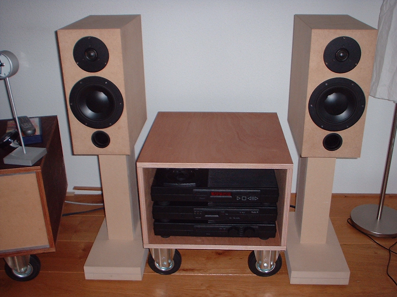

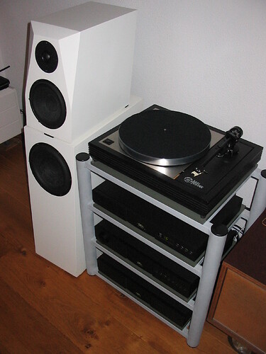

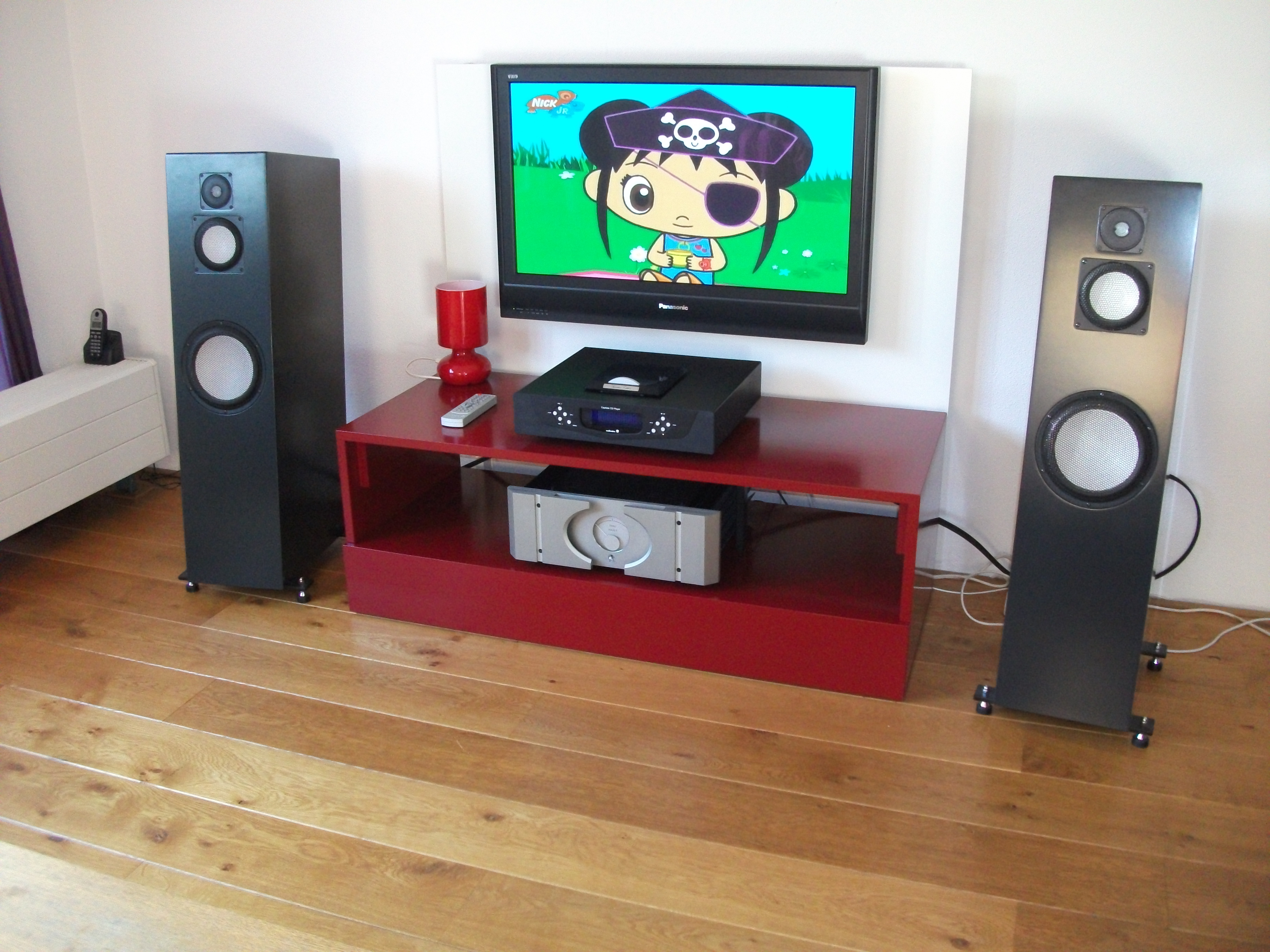

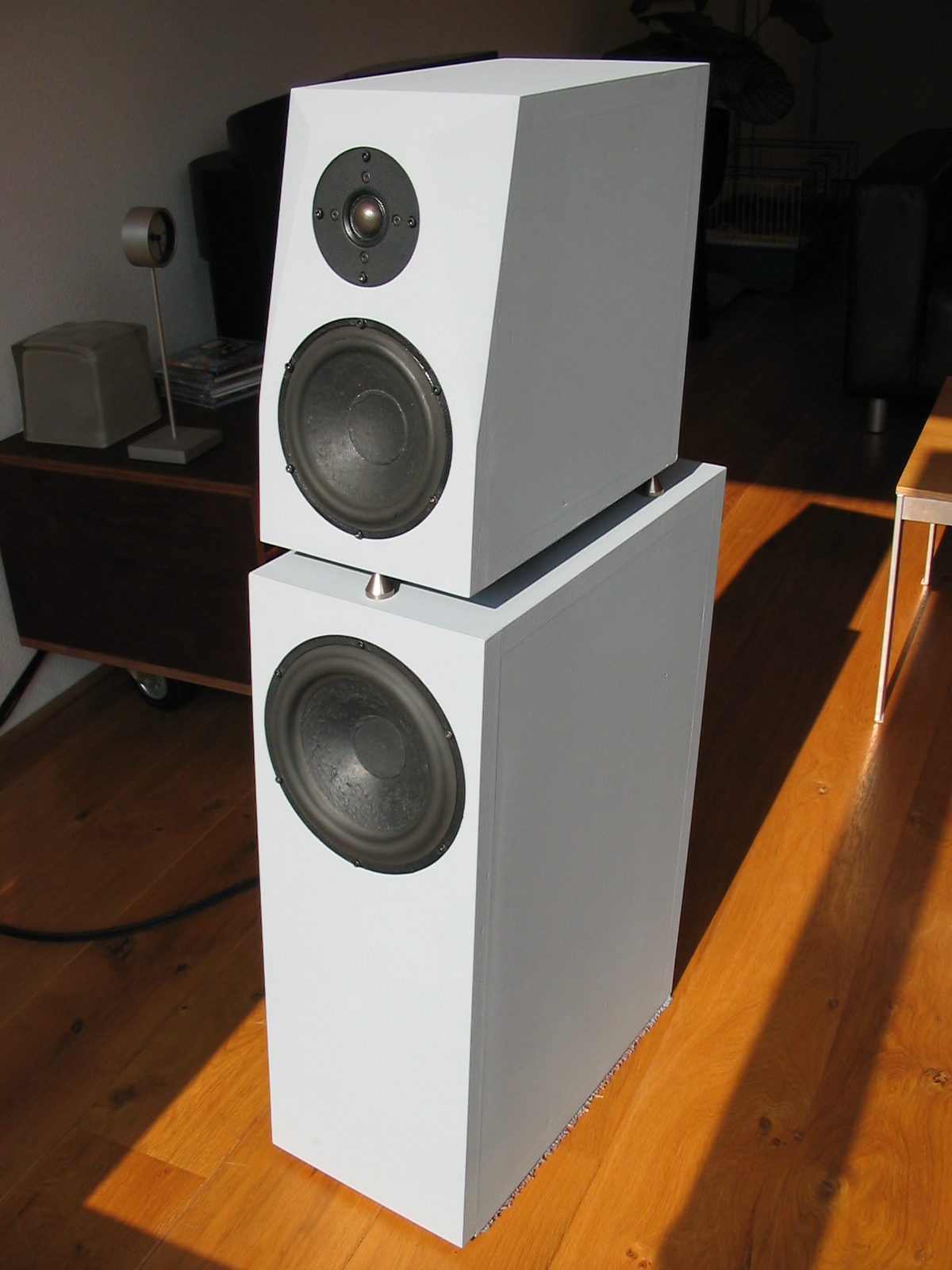

I have built many speakers in the last 20 years. (not every speaker here on the photo’s)

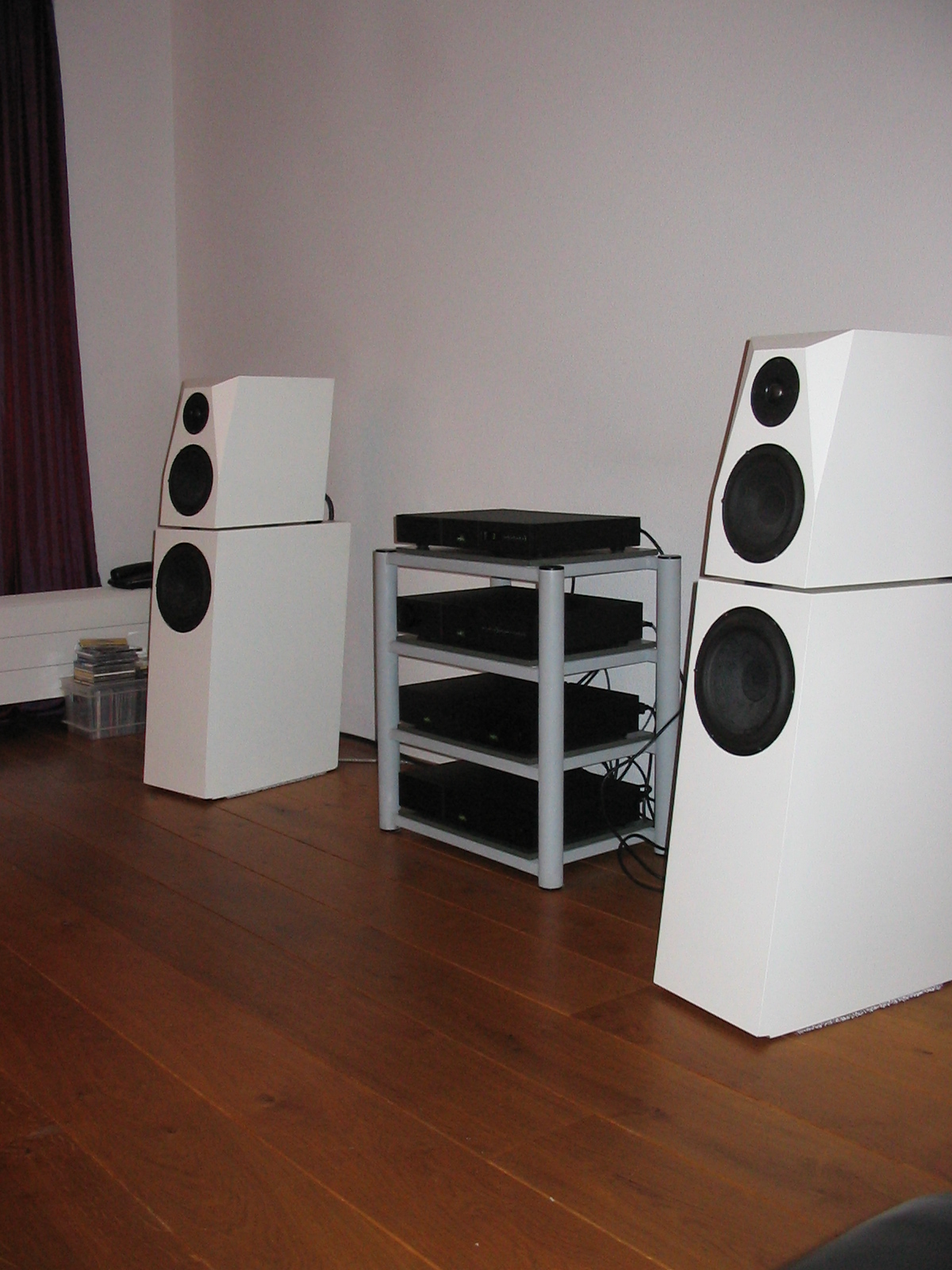

is the white floorstander with a separate bass cabinet - the kairos ?
regards
No it is all DIY
eve II with scan speak units

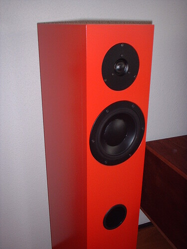

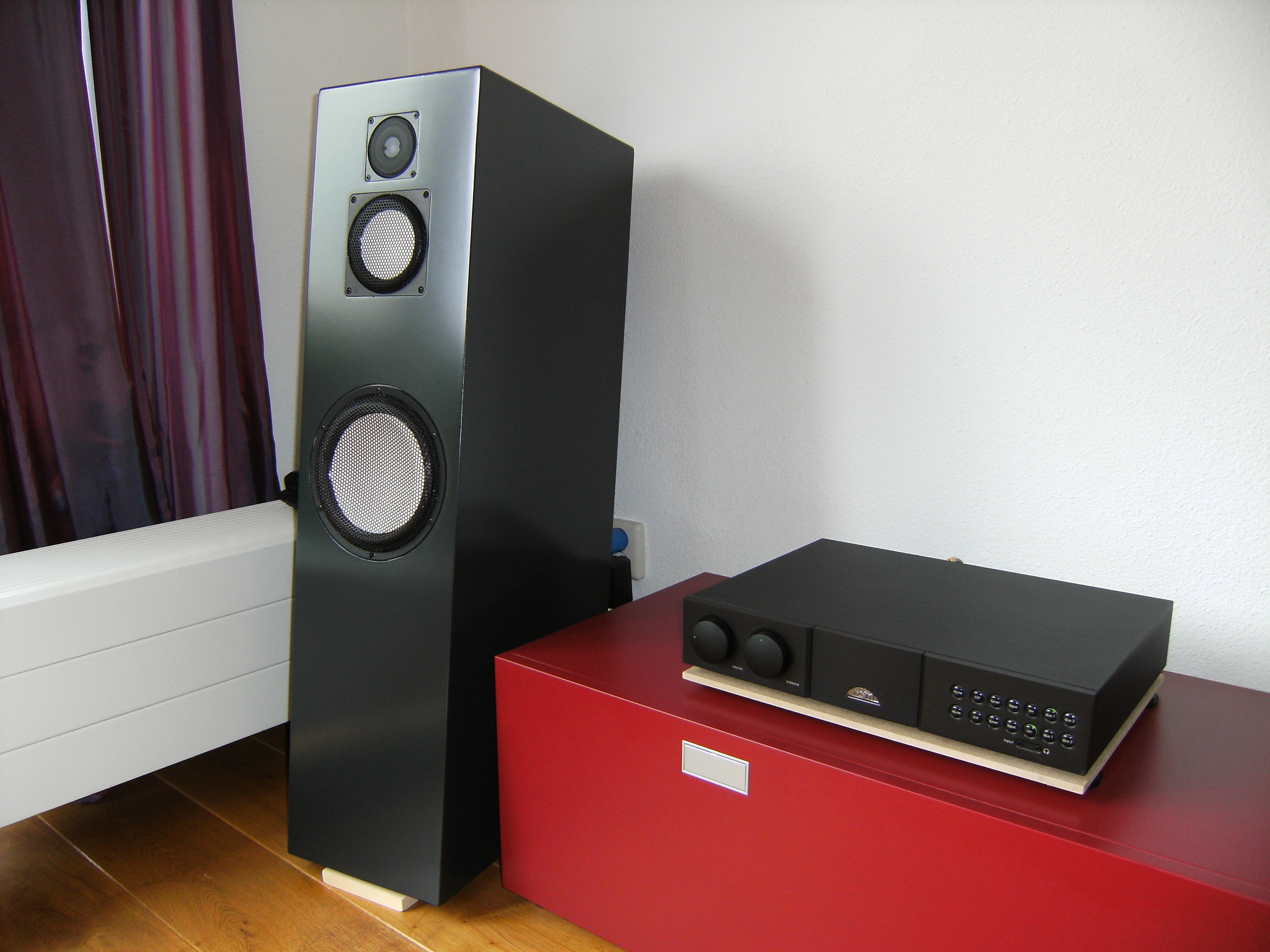

and the Red ones are Morel driver based ?
