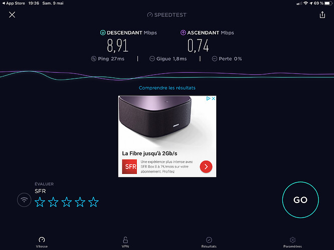

I have Ethernet via ADSL. About 12 Megabytes.

Here a test of my adsl.
