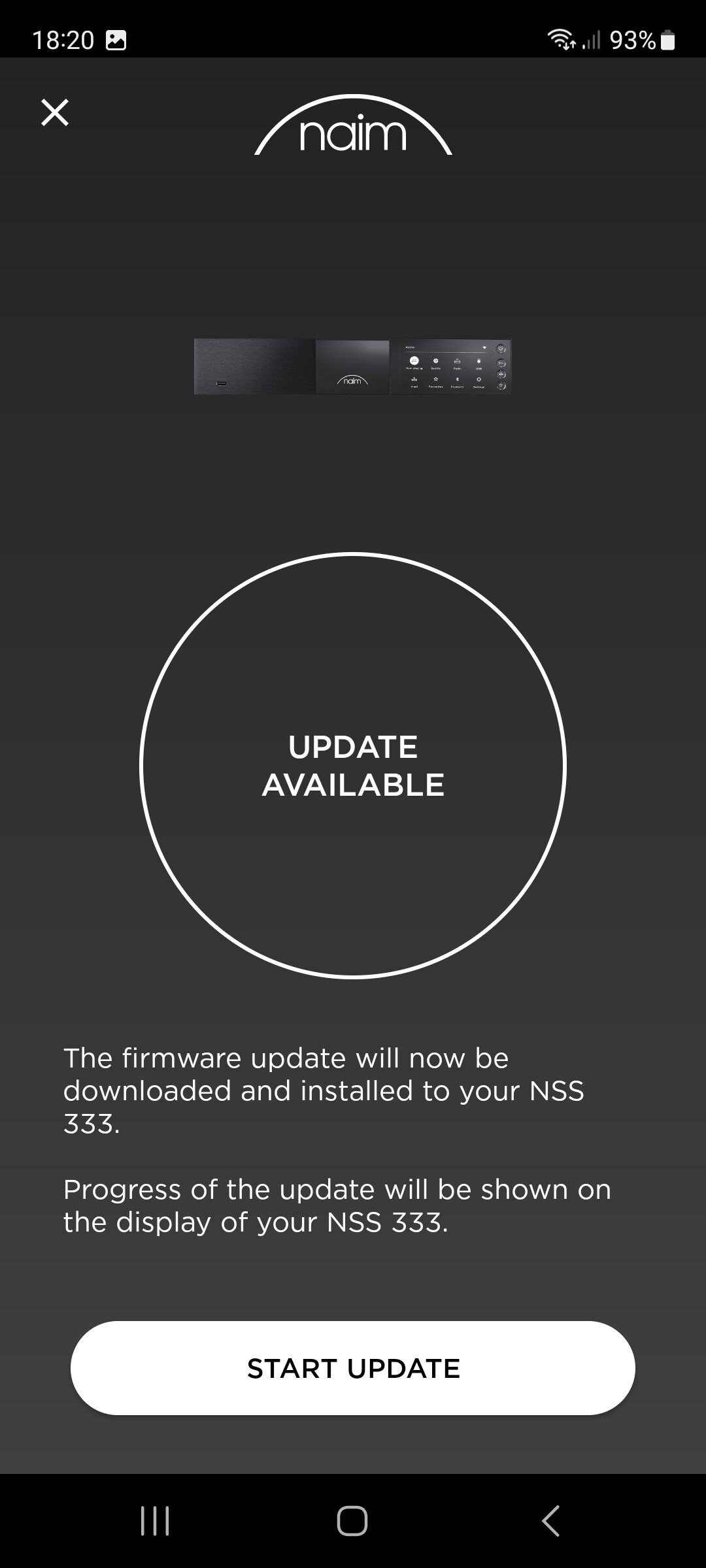

Update to Muso qb2 is clunky with no onscreen feedback on what is happening.
Naim developers should check out how Wiim implement a firmware update with step-by-step feedback in the app on what is happening.
Two Mu-so Qb 2nd generation, a Uniti Nova and a NSS 333 updated. All units sounds excellent :musical_notes::100:

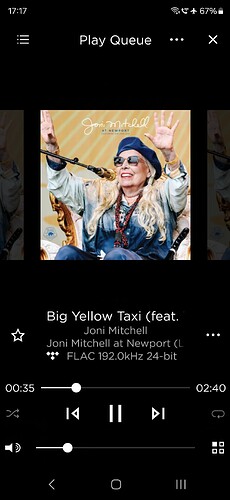

Does tidal connect basically play tidal to your streamer via airplay? And can you actually see the resolution level?
Not by Airplay I believe, and no loss in quality. You can see the resolution in both the Tidal app and the Naim app.

Version 7.1 of the app is available on iOS App Store now. Solves the max issue
Thanks @HungryHalibut
