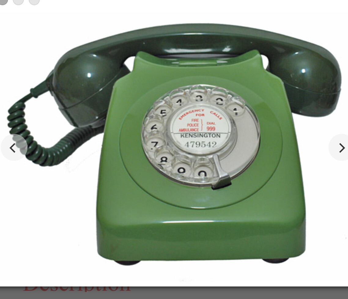

Oh yes if like me you like the old fashioned rotary dial phones with a bell … one can get a little adapter for those to work as well… other than I don’t think pulse dialling will be supported anymore… unless you find an ATA converter that does.

Ah sport. I obviously wasn’t clear. I meant the “old fashioned rotary dial phones with a bell”.

LOL… this one is pretty similar to the phone I have that I referred to
Mrs SinS found one for me in an antique shop.. I stripped it down and serviced and replaced some of the components (REN resistor and lightning limiter as well lubricate all mechanisms) and it works a treat.. it sounds superb when ringing and in use….
Donkeys years ago we put together a little circuit to convert pulse dials to DTMF. It’s 30 years ago now and I can’t, honestly, remember why we designed this.
