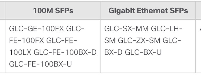

Remember you should match the transceivers for optimum performance. I don’t know if the Sonore product can use SFPs.. but for best performance I would match the SFPs.
These are supported transceivers for the 2960 platform

Absolutely. And choosing the wrong SFP transceiver can result being a nightmare.
I’d go for a pair of 100 Mbits Cisco modules. Are these compatible with the Sonore product? No idea. I see no useful information on their webpage:
