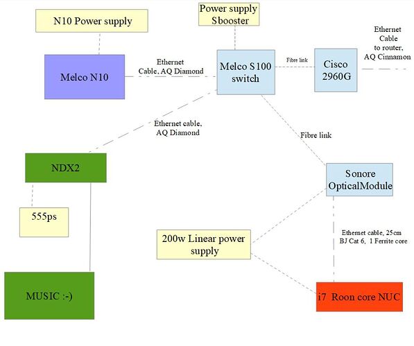

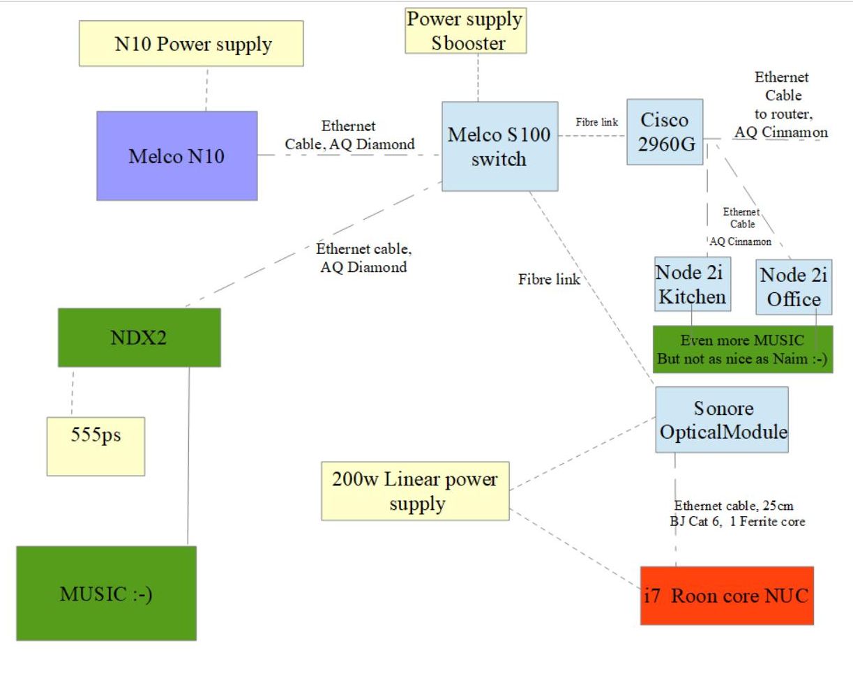

So your chain is Melco S100 > fiber> Sonore optical module > Ethernet cable> nd555. And Melco switch > fiber> Cisco switch with SFP module > other components ( Nas, tv…)
Like this:

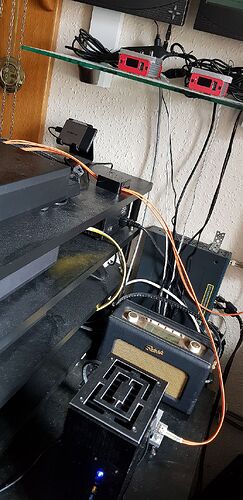

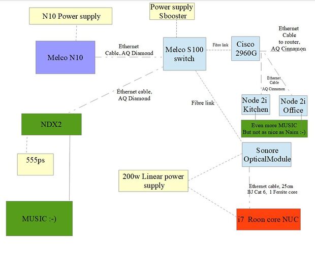

The only things that go into the Cisco are the ethernet to 2x Bluesound Node2i in other parts of the house. The TV and many other things are on a separate switches out of the router, each room in the house has a switch, the Asus RT-AX88U has 8 gigabit ports so ther are 8 switches in the house.
The black box on the fibre links is a cable holder which works nicely to damp any vibration coming up them. The OpticalModule just behind the Roon core on the bottom right is on an aluminium heat sink on spikes.
Tweakers heaven :wink:

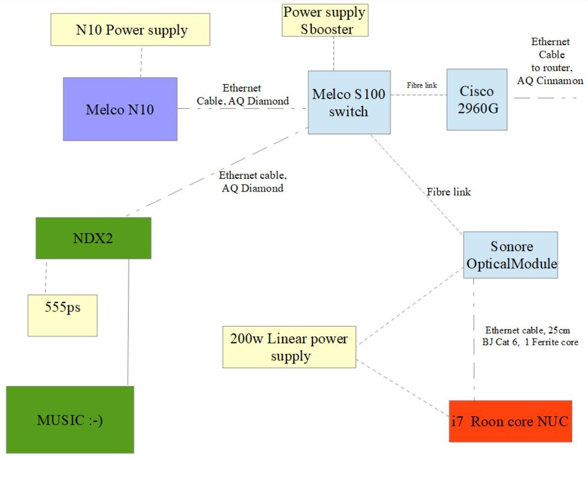

On your schematic, nothing goes from the Cisco 2960 G, ?
Thanks - this diagram makes it clear why the optical module isn’t making a huge difference - because while it does stop noise coming from your Roon Core, it doesn’t stop noise from your Melco server, your Melco switch and its psu, or your Cisco and the network attached to it from entering the DAC.
I was imagining that the opticalmodule was between your last hifi box and the DAC, which would then block noise from almost all your equipment.
If you had a dac with a usb input, I suppose you could feed the OpticalModule directly into it - presumably that’s its ideal usage situation.
@charlesphoto - does your optical module feed directly into the DacV1’s usb input?

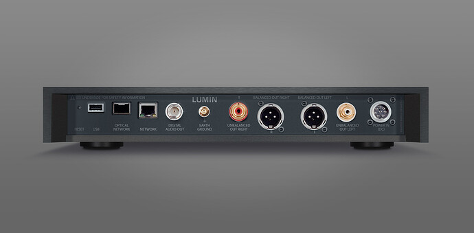

Or better yet a Lumin N1, though I’ve not had a listen to one yet.

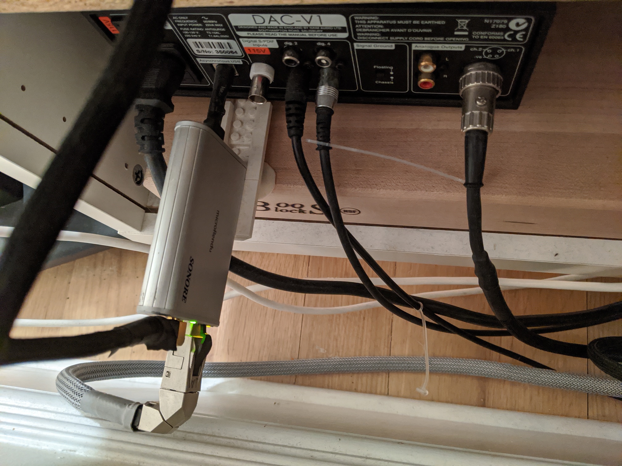

No! The opticalModule is a Fiber media Convertor - i.e. it goes from RJ/45 in to optical out, and then vice versa on the receiving end (op in, RJ45 out). There are a few streamers out there with optical in, namely the opticalRendu and Lumin I believe. The second, receiving oM, goes to a microRendu 1.4 via Ghent Cat6a JSSG, and the microRendu is plugged into the USB on the rear of the V1 via an Uptone USPCB hard adapter.
The USB input on the V1 is one of its main features (and costs) so the microRendu was a great solution for streaming when it came along vs the SPDIF in I was using before with the UQ as streamer only. The mR (esp with the 1.4 clock and board upgrade) is/was much better and the UQ better as an all in one. The mR also casts Roon via its Bridge app to the UQ which is now in the office, so performs a really valuable function in making the UQ ‘Roon ready.’

Here’s what the back of the V1 looks like. Had to go with the 45 degree Metz connector on the Ghent cable to make it fit. And I raided the lego bin to make a little holder for the mR. :slight_smile:

I do like your creative use of Lego for your microRendu. I hope you cleared it with your kids first and that they’re not now missing a couple of vital parts.
