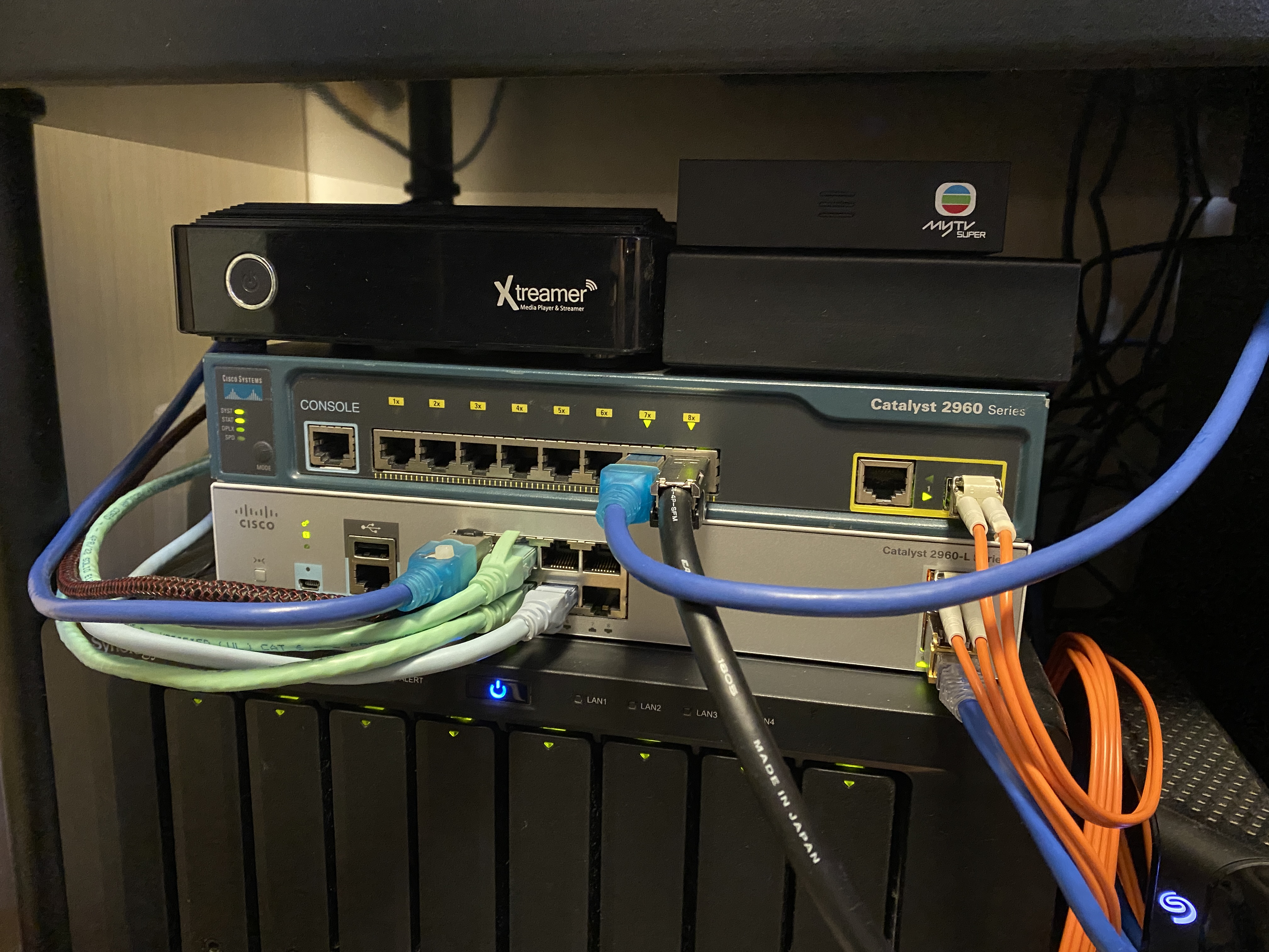

Hi All, just finished the setup, the NDX and Core connect to the upper 2960 and use fibre connect to other 2960L.
How do you think use the fibre instead of RJ45 for isolate noise ? :slightly_smiling_face:
There are lots of posts about that above.
if you can find them
e.g. by Charles Photo et al
perhaps search for Sonore optical module - but some also have tried other fibre optical solutions
Noted and Thanks
