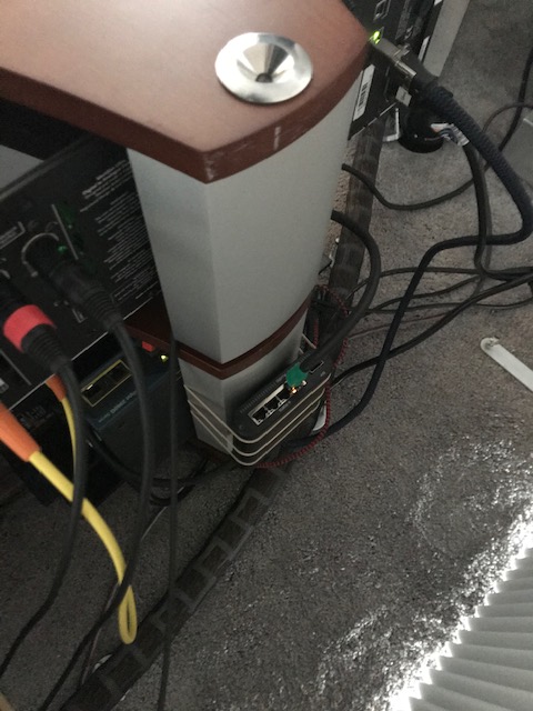

Had the same problem with placings these ā€œaccessoriesā€ā€“maybe we should call the ā€œNecessitiesā€. I have enclosed a pic of what I did with my eR, using the rear post of the Fraim. Cost was cheap–just 3 rubber bands. Its accessible! and out of the way and not dangling in the air as I had it for some time. Perhaps one could do the same with the SOTM Clock. Got me thinking.
BTW: If you look carefully, you can see my Cisco 2960 tucked neatly, in vertical position, on the other side of the Frame, leaving the glass shelf for Nucleus+, Naim Core, and LPS’s. I put some soft rubber bumpers on the side of the Cisco, since its sensitive to microphonics according to this/other threads.
Very nice and compact. I specially went and got an extra Fraim shelf, initially for the NAS I no longer use, but found that it and then Nucleus and Cisco all sounded better away from the stacks, as does the EtherRegen, although it’s a little less fussy (the difference is subtler)…
