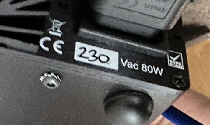

However, the power supply shows a power rating of 230Vac 80w.
So I’ve swapped the fuse out for a 3a fuse which is suitable for up to 720w.

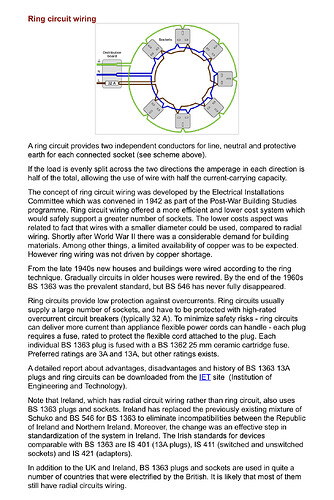

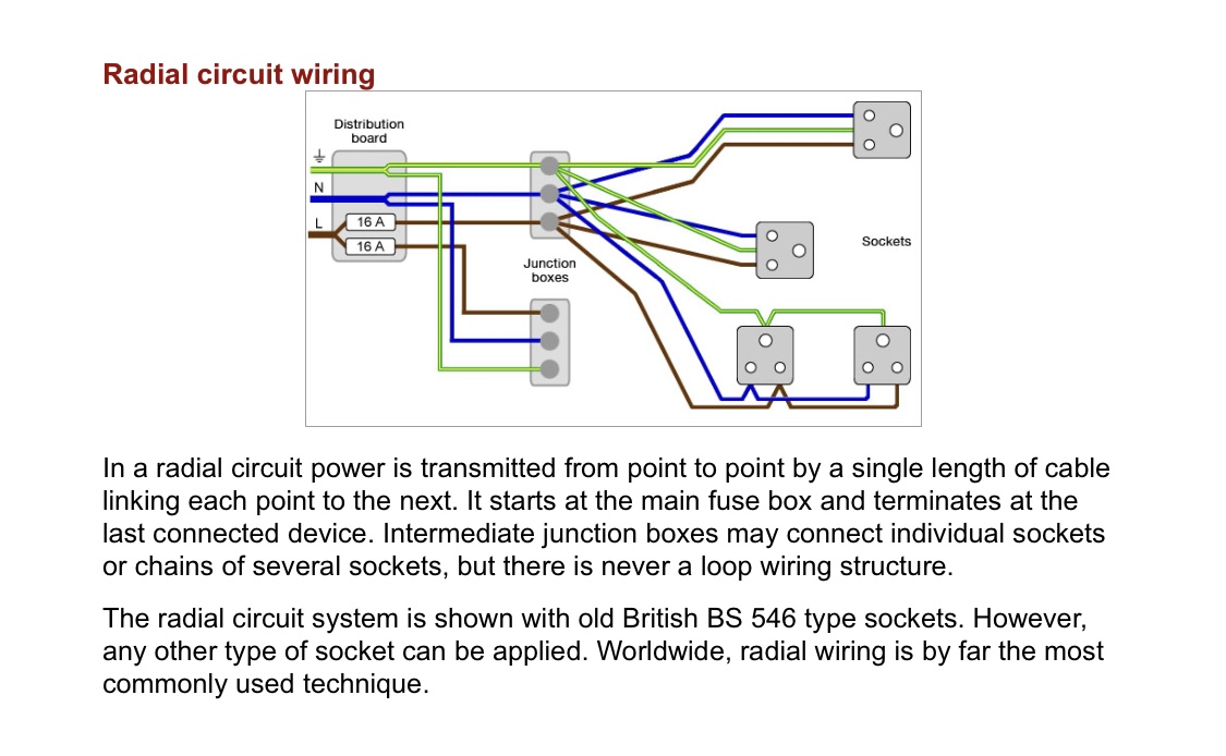

Some information explaining the difference between UK Ring Mains and Europe Radial Mains.
DG…
