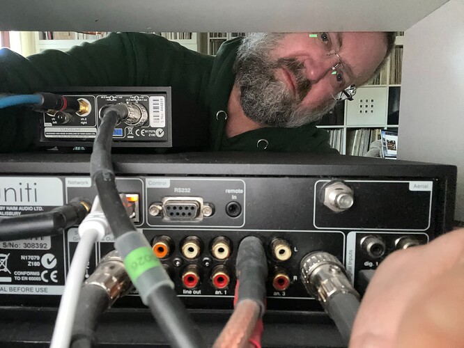

Finally managed to update my old Uniti 1
Well, I’ve finally done it. I bought an RS232 cable and updated my aged Uniti, the original version.
I couldn’t get my RS232 cable to work with my Mac. My partner’s windows laptop came to the rescue and it was surprisingly easy.
It seems that my old Uniti lives to fight another day.
