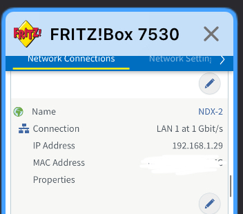

Do you have access to the control panel of your router? (Often the router is 192.168.1.1 but might not be). What’s the make/model of your router? The control panel will list the attached devices and the assigned ip addresses.
Then you’ll see something like this.
Obviously you’ll need to have the streamer wired to see this.

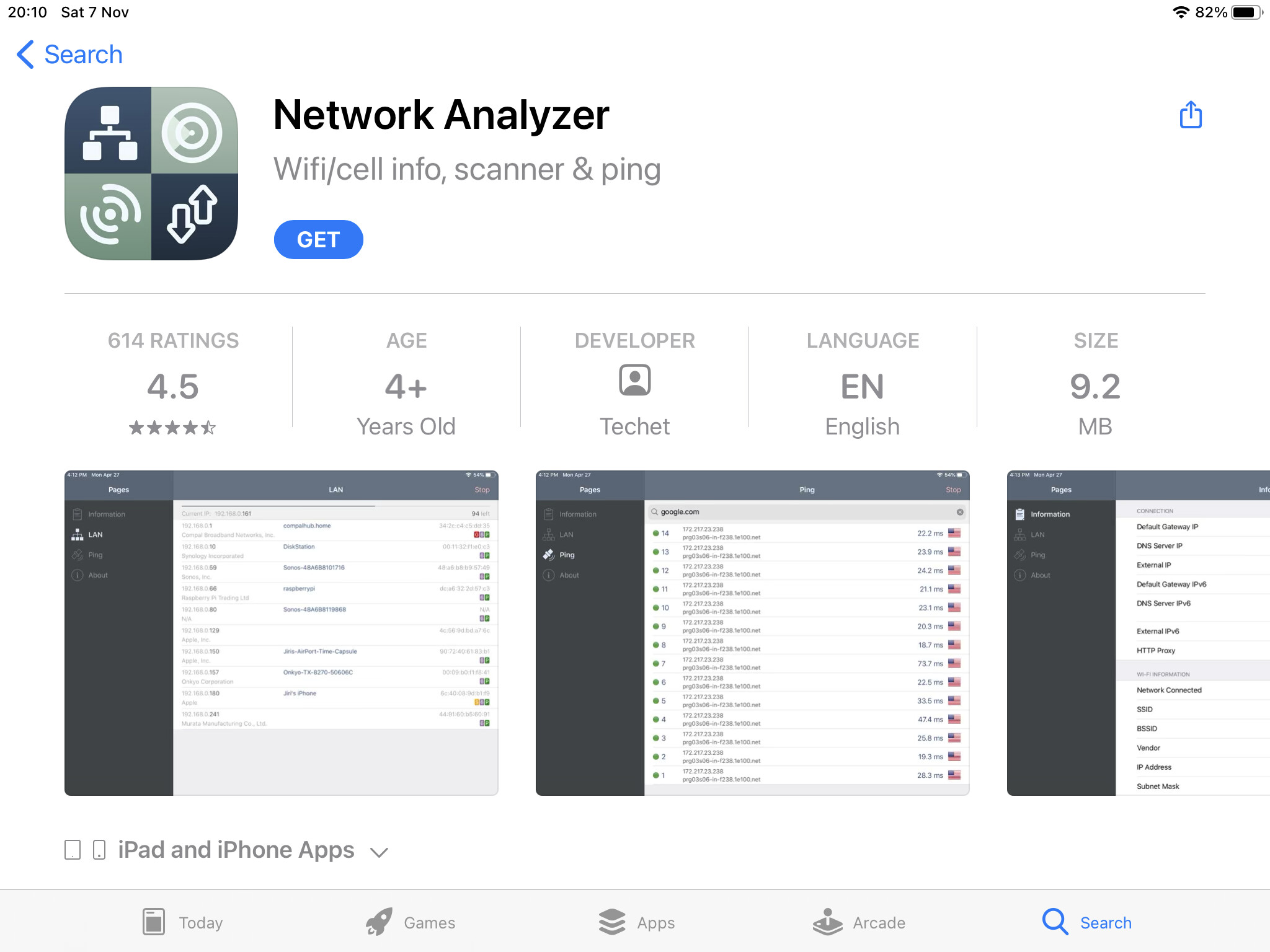

If you are on IOS try this
Free app and works a treat.

As others have said, there are free apps such as on Apple iPad / iPhone, Net Analyzer, which uses a simple discovery technique to see what is responding on your network… if you don’t see the streamer… then in it’s either
