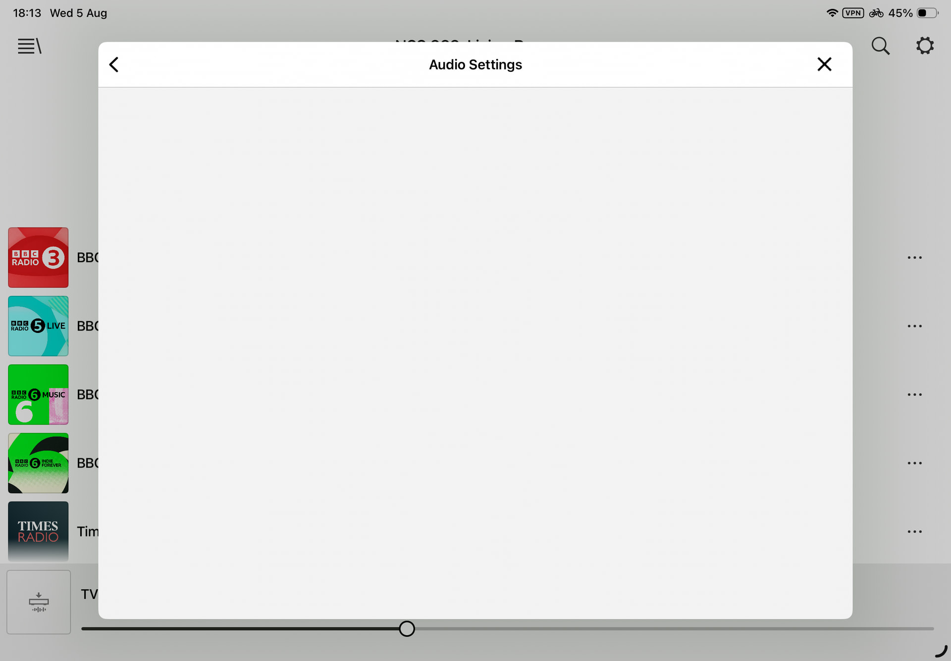

EDIT
should there be something in this window?

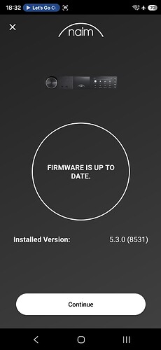

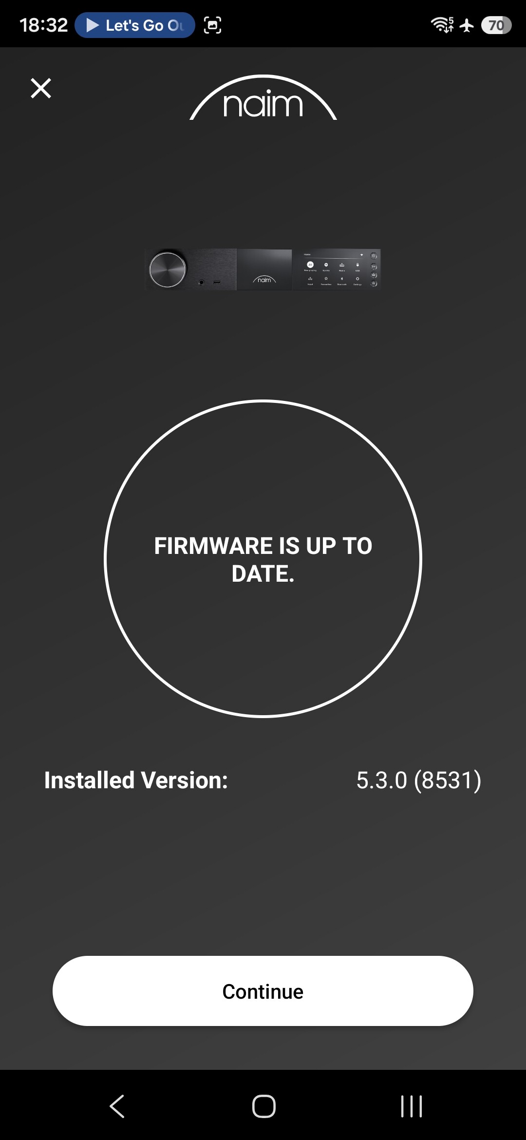

Is this a phased rollout? NSC 222 is saying it is on 5.3 and firmware is up to date

I’m not sure why; you just unplug it and plug it in again. I’d try ‘check for updates’ in the App. If that doesn’t work it may be a case of waiting a while. New firmware does seem to appear slightly later in some parts of the world on occasion.
Hi @elverdiblanco Odd! But considering what I’ve just been through with the 333, were it appears the update half loaded anything could be happening :joy:
Assuming your app is up to date, probably a case of just waiting :man_shrugging:
