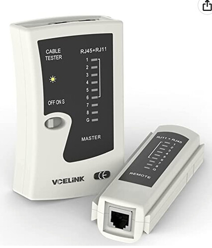

Having, more often than I care to admit, wasted hours with networks to only discover it’s a simple patch lan cable fault, investing in a cheap lan tester (which you can use for patch leads and infrastructure cabling) is a well worth while investment. It’s particularly important, where you’ve done the termination to test infrastructure cabling. A decade or so ago lan testers were up to a hundred quid (in fact we made our first one 'cause they were so expensive to buy), now they’re a tenner!
