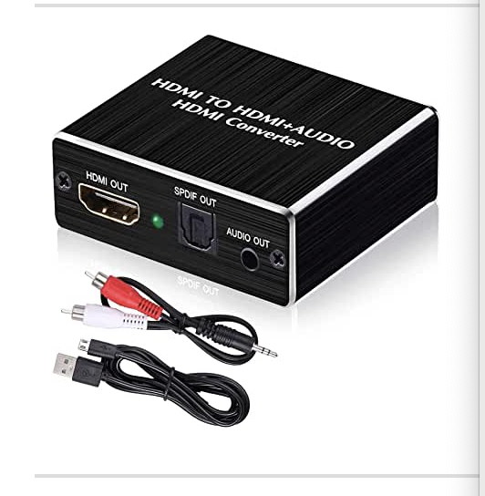

I connected an Apple TV to a UnitiQute via an HDMI to Coax/Opt adapter
Something like this , you can get them in all flavours , such as HMI to USB

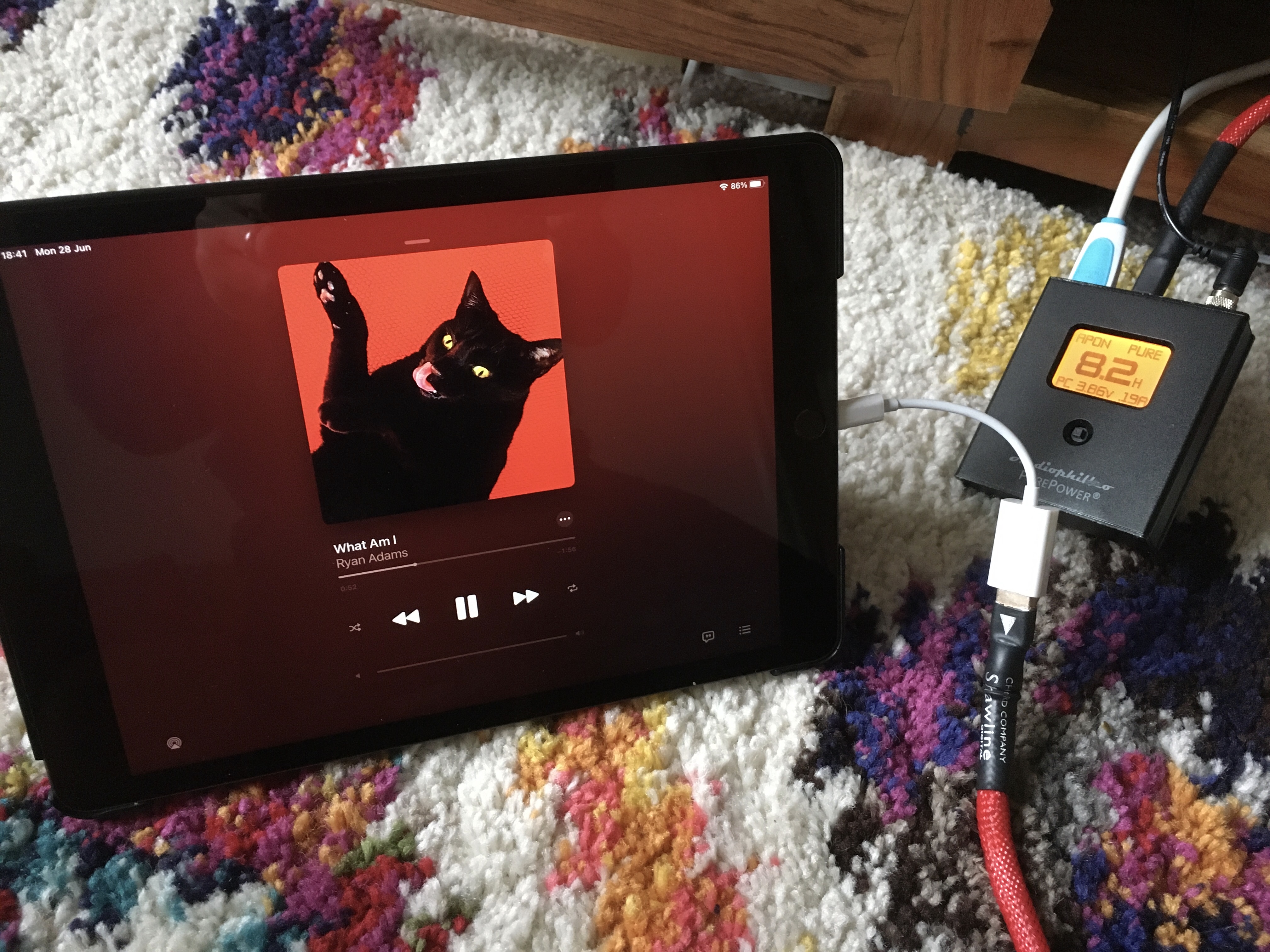

  • iPad->USB adapter->USB to SPDIF converter → Nova (BNC in).

So all you have is two adapters essentially?

Yes, two adapters as pictured.
