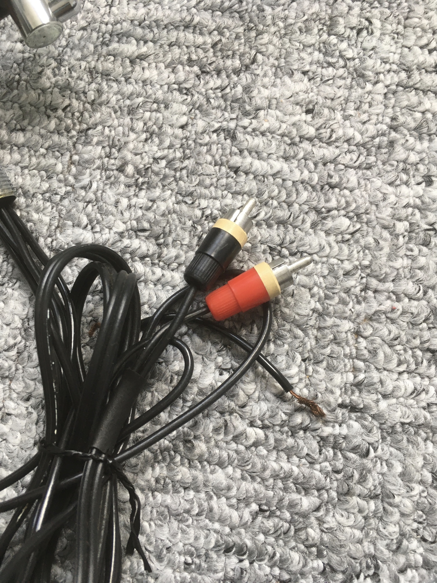

It has a detachable headshell and finger lift which dates if after the mid 80’s I think other than that I’m not sure until I get it in my hands, it has had a couple of variants over a couple of decades but as soon as I have it I’ll post some potographs and seek your help dating it. My gut feeling is mid eighties as it has quite stubby RCA plugs a bit like early Linn arms where as later ones have a more conventional plug.

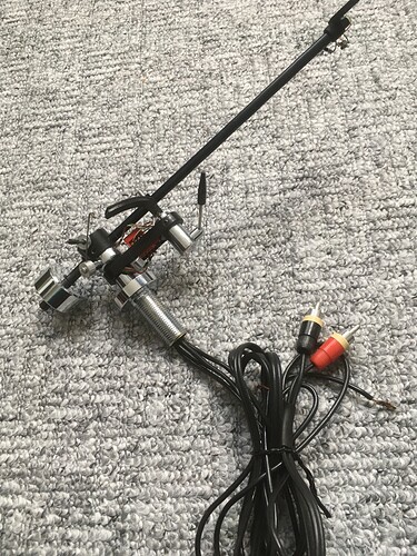

At first I thought it was missing it’s second counterweight but looking on line there was an early version with a single counterweight so hopefully this will help one of you eagle eyed analogue experts to date it.

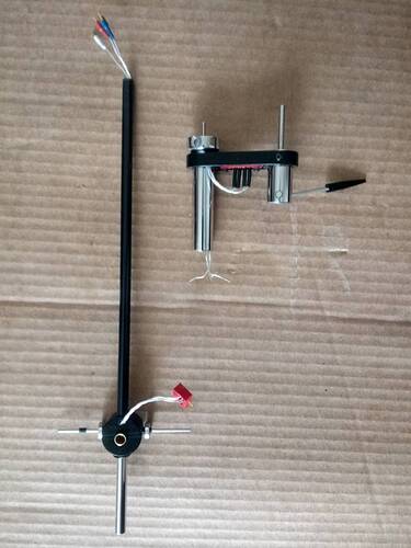

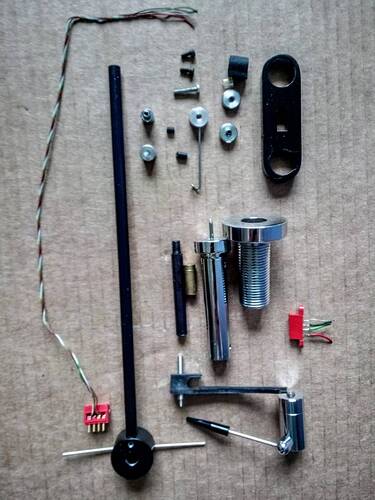

I’ve posted pictures on another forum and someone there though it might be either a Super Export D or Super Export E. Further inspection reveals that the arm tube can be lifted off completely after unplugging the red box that contains the wires so that another arm tube or more with different carts can be swapped over.
I was aware the arm tube detached but thought it was pulled through beneath the counterweight.
Armboard is due at the weekend then after I’ve had a listen as is I’ll probably go for a rewire and will decide between a 99% pure silver litz or a Cardas.

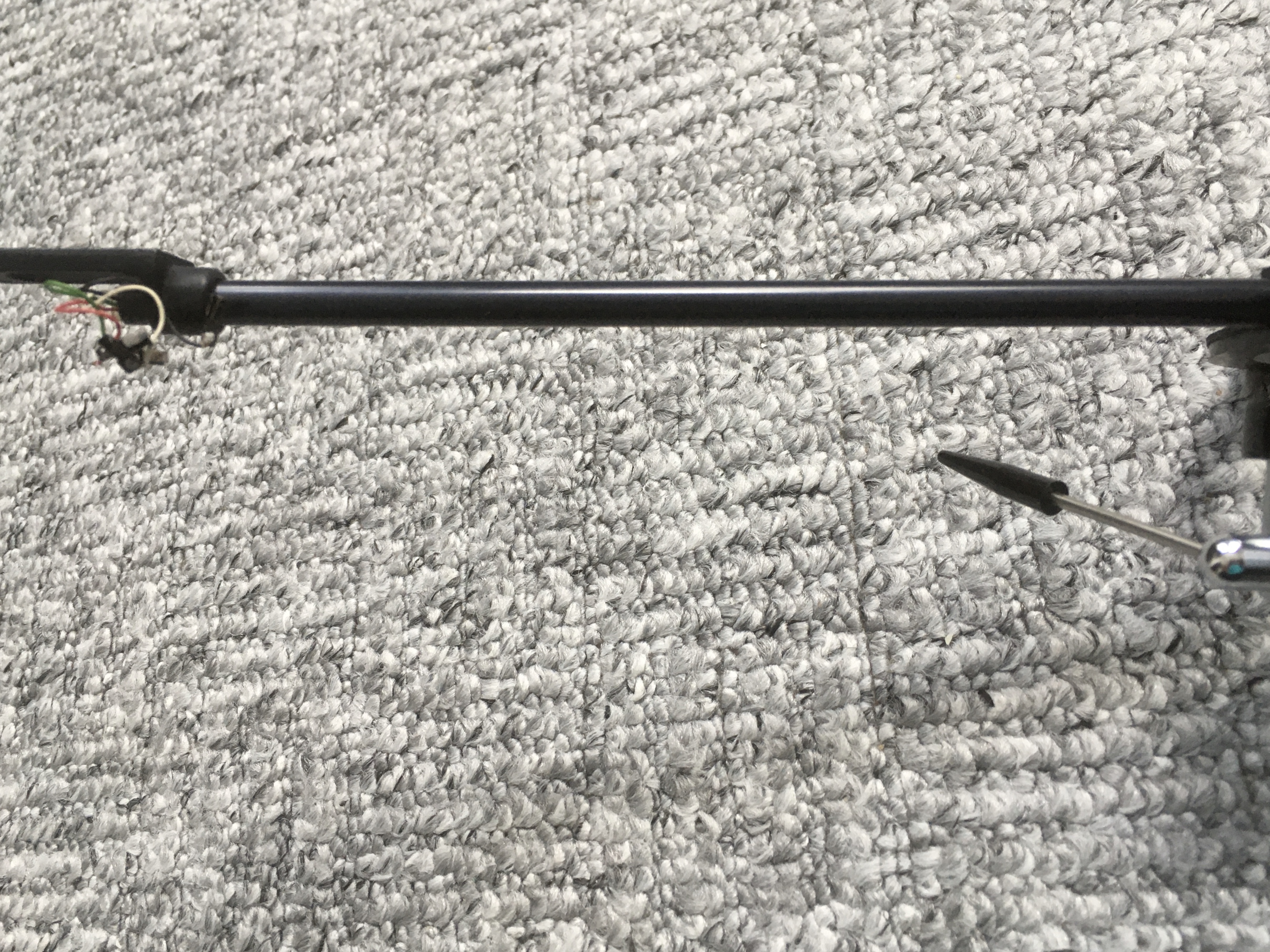

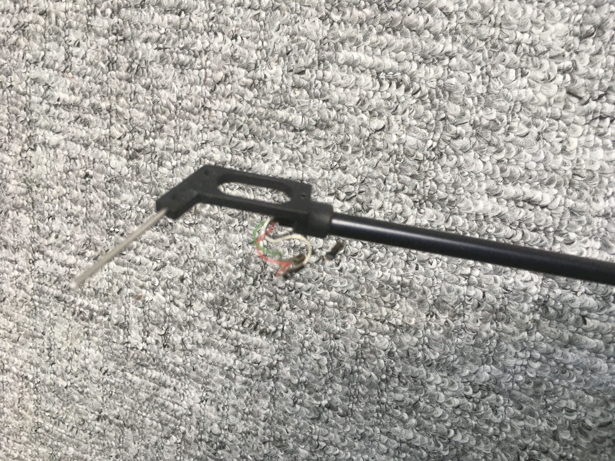

The Hadcock is in bits before being rewired.
I went for a 99.999% pure silver litz to try and add that little bit of sparkle that’s missing from my Technics 1210.

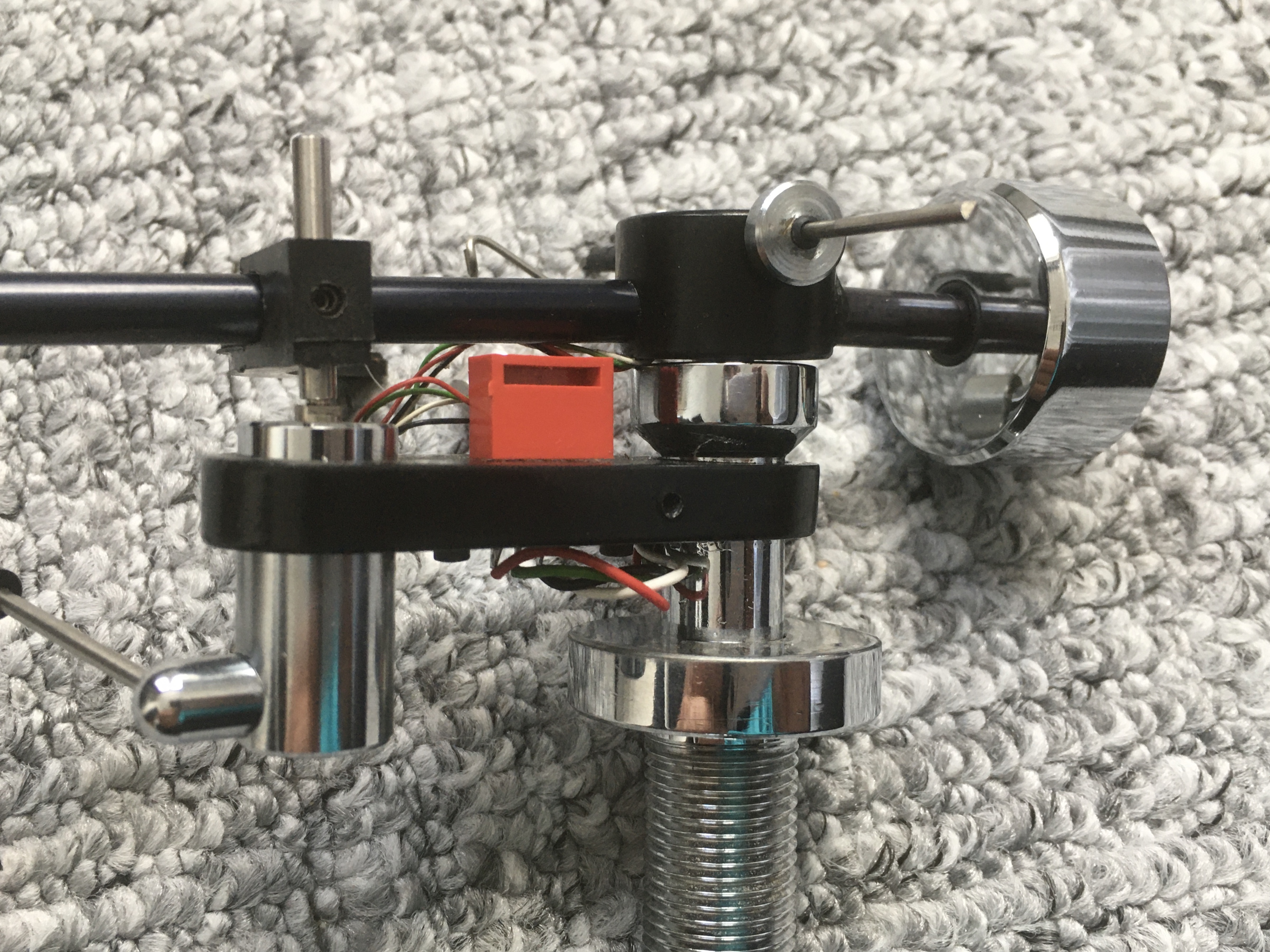

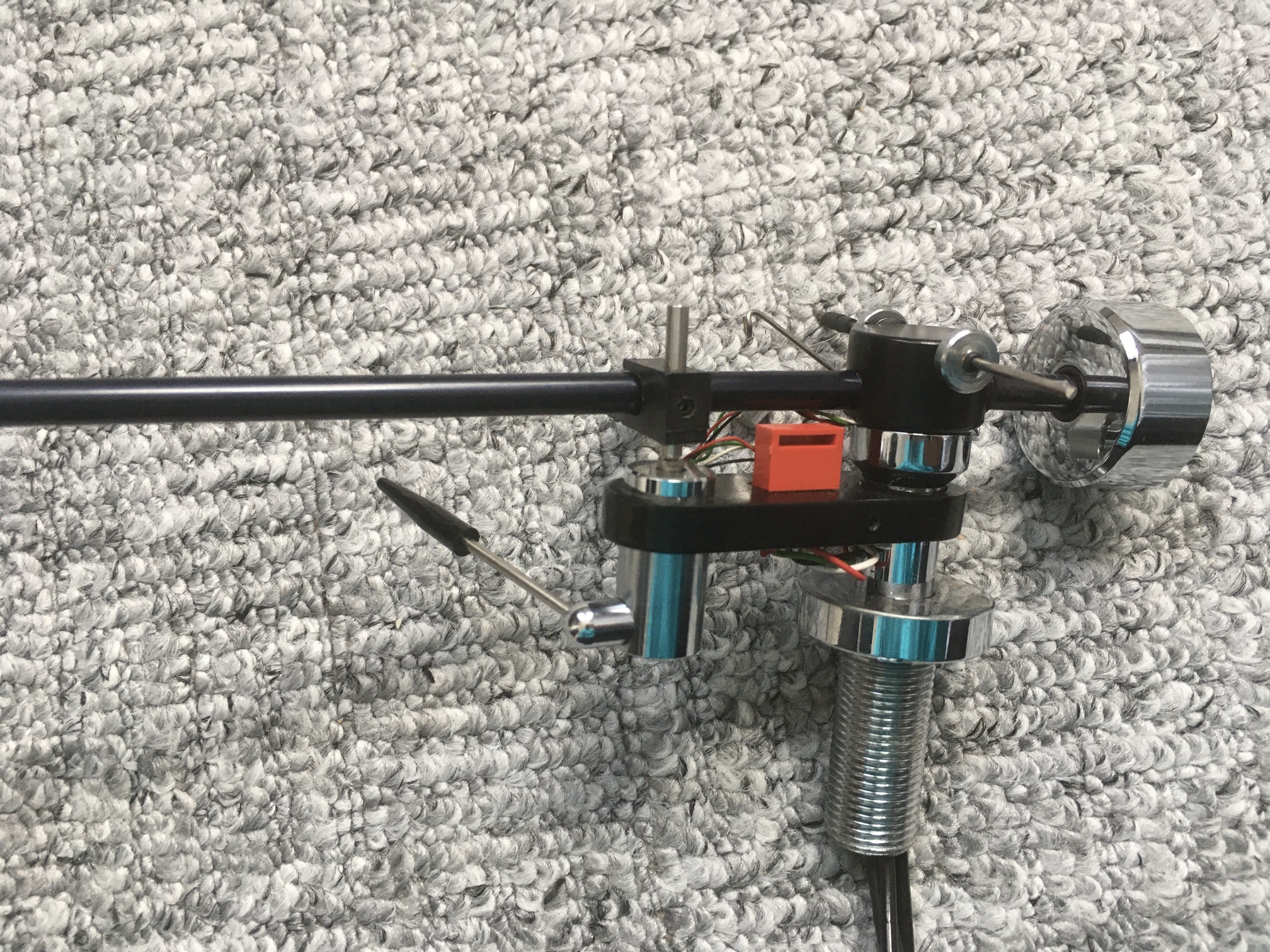

The Hadcock now has a new silver litz internal cable fitted and has benefitted from a good polish.

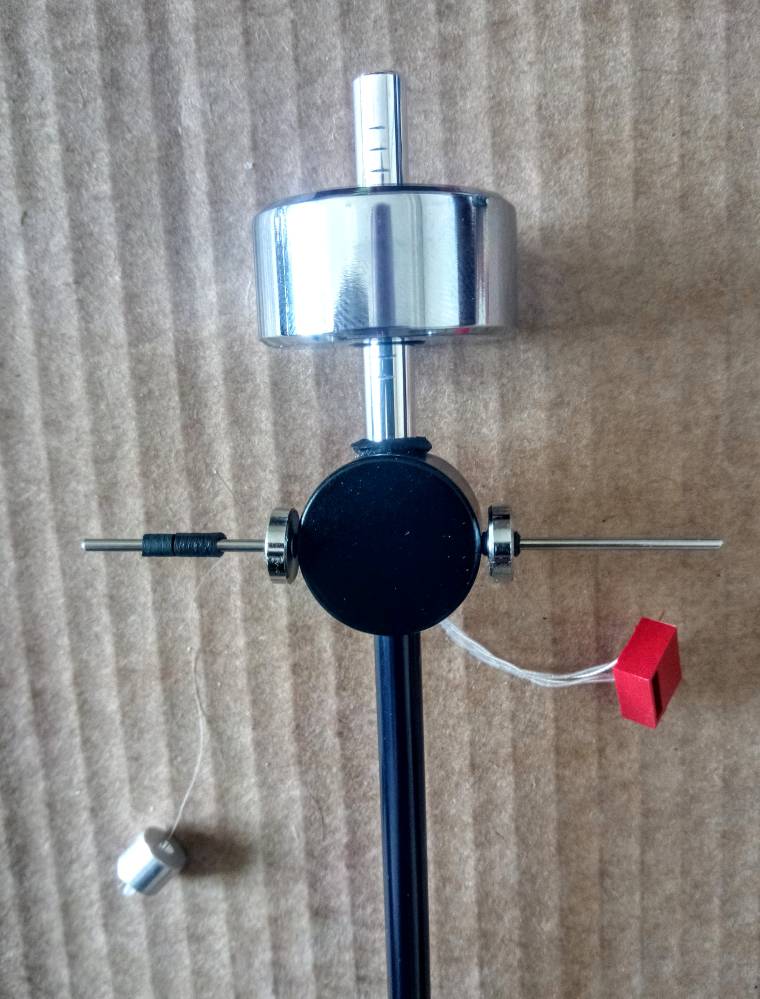

As you can see this Hadcock uses two outriggers with small weights to balance the arm horizontally which was usually done with an apparently very annoying second of centre counterweight so hopefully it will be easier to balance.
