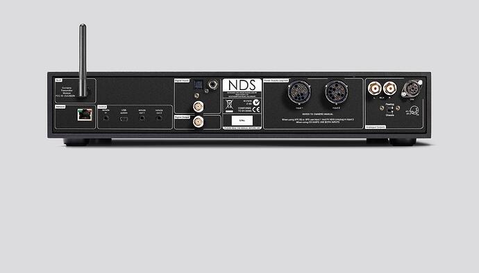

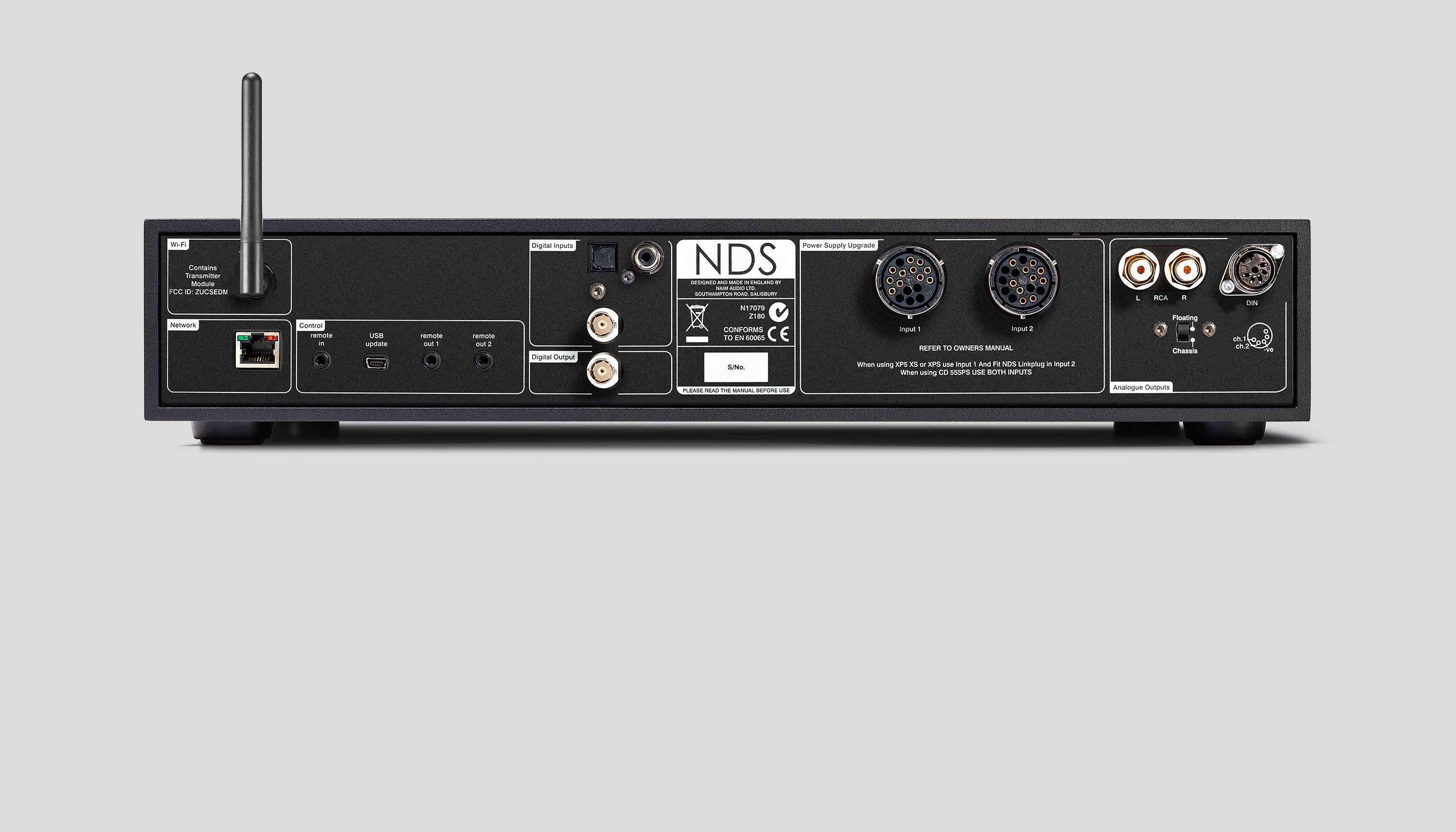

Have you connected it to the correct BNC on the NDS (i.e. not the bottom one)?
Regards
Neil.

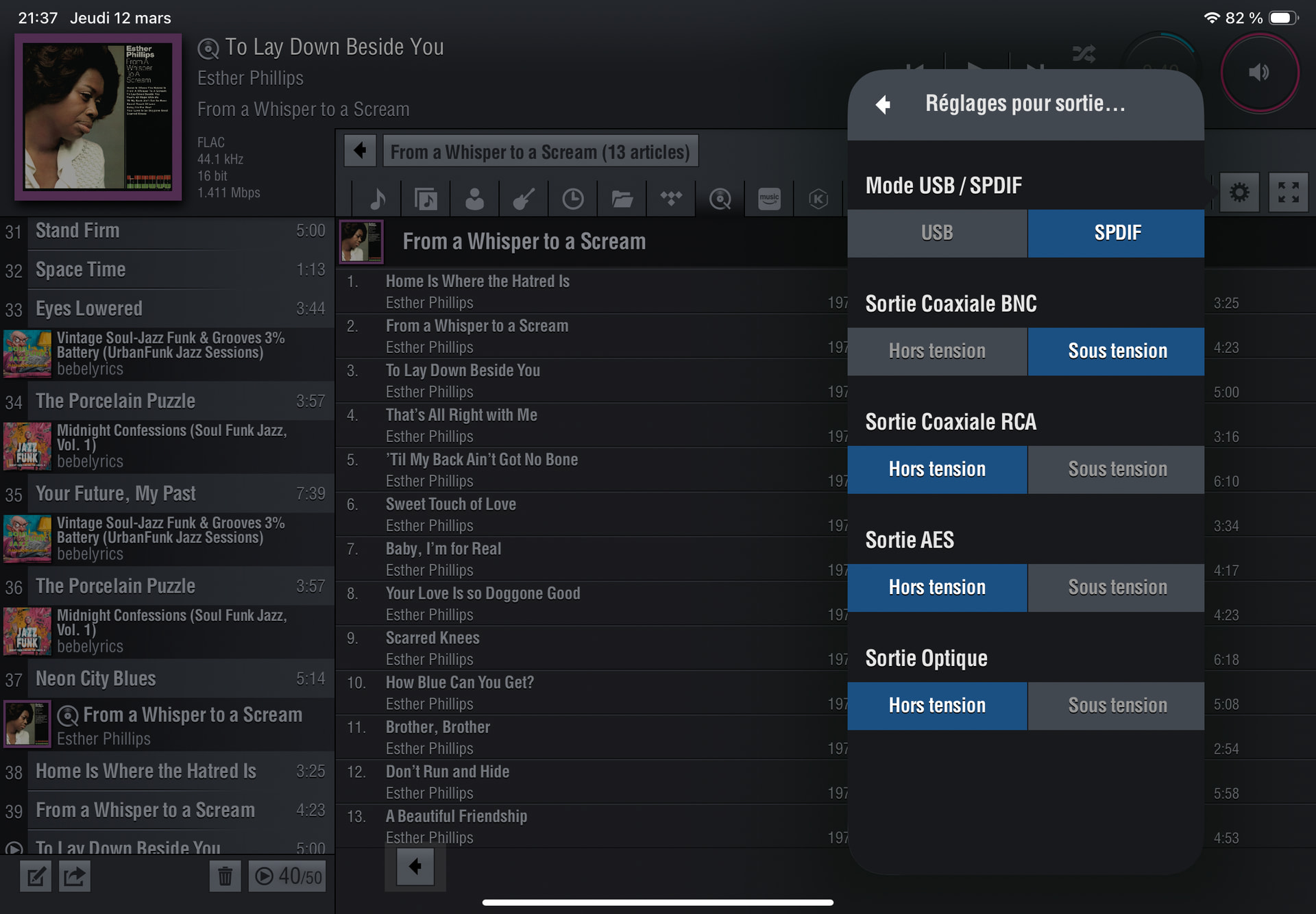

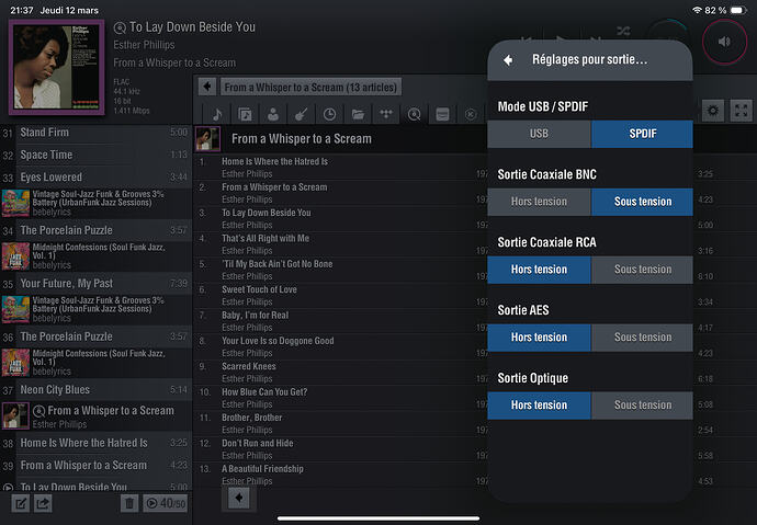

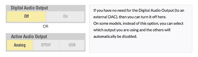

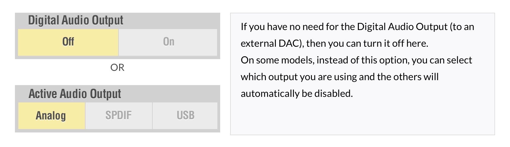

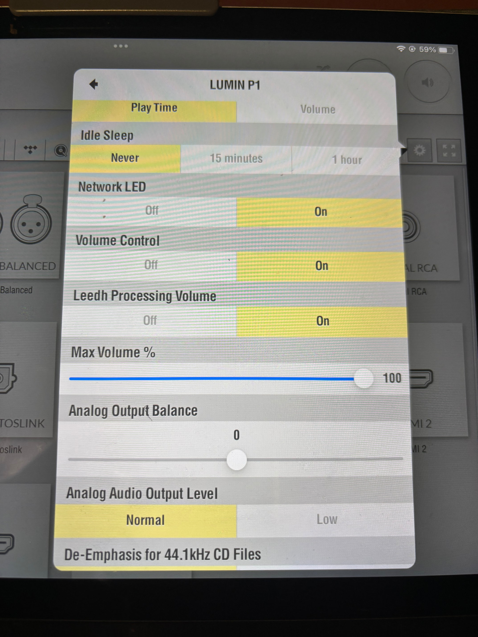

I’m assuming you’ve enabled the correct SPDIF output settings on the Lumin (and the Digital Audio output is set to on)
I have this on the Lumin app:
That looks correct FR. Have you got a different digital cable you can try to eliminate that as an issue ?
FR, do you have the volume set to max on the Lumin? Does yours use Leedh digital volume control?
Or, you might want volume control off, giving maximum output to the NDS which will then control the volume rather than two volume controls in circuit.

Yeah, he also has a separate preamp, so nothing like what I use my P1 for. He just needs the Lumin to be a streaming source into the NDS as a Dac, into his EAR preamp.
The NDS, in this configuration, would probably also need to be set for fixed output to allow volume control only by EAR Pre-Amp.
Settings should be checked to ensure all is configured correctly for inputs and outputs of U2 Mini and NDS.

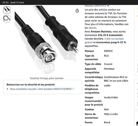

I ordered this one , a basic cable from Amazon.
Should work ?
I tried both.
Yes
The NDS only has a fixed volume line out, so there is nothing to adjust there. Worth experimenting with the Lumin output levels, though.

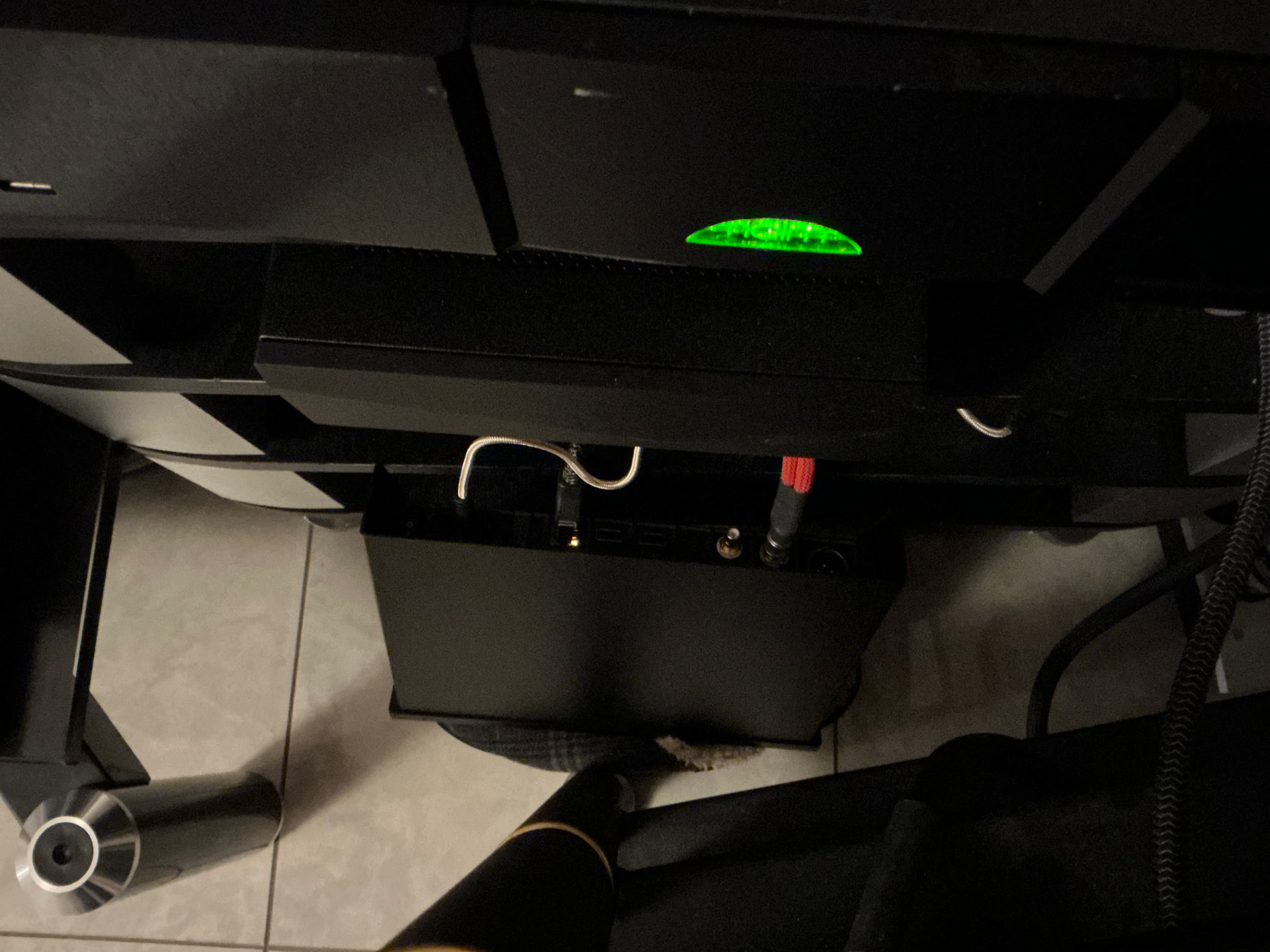

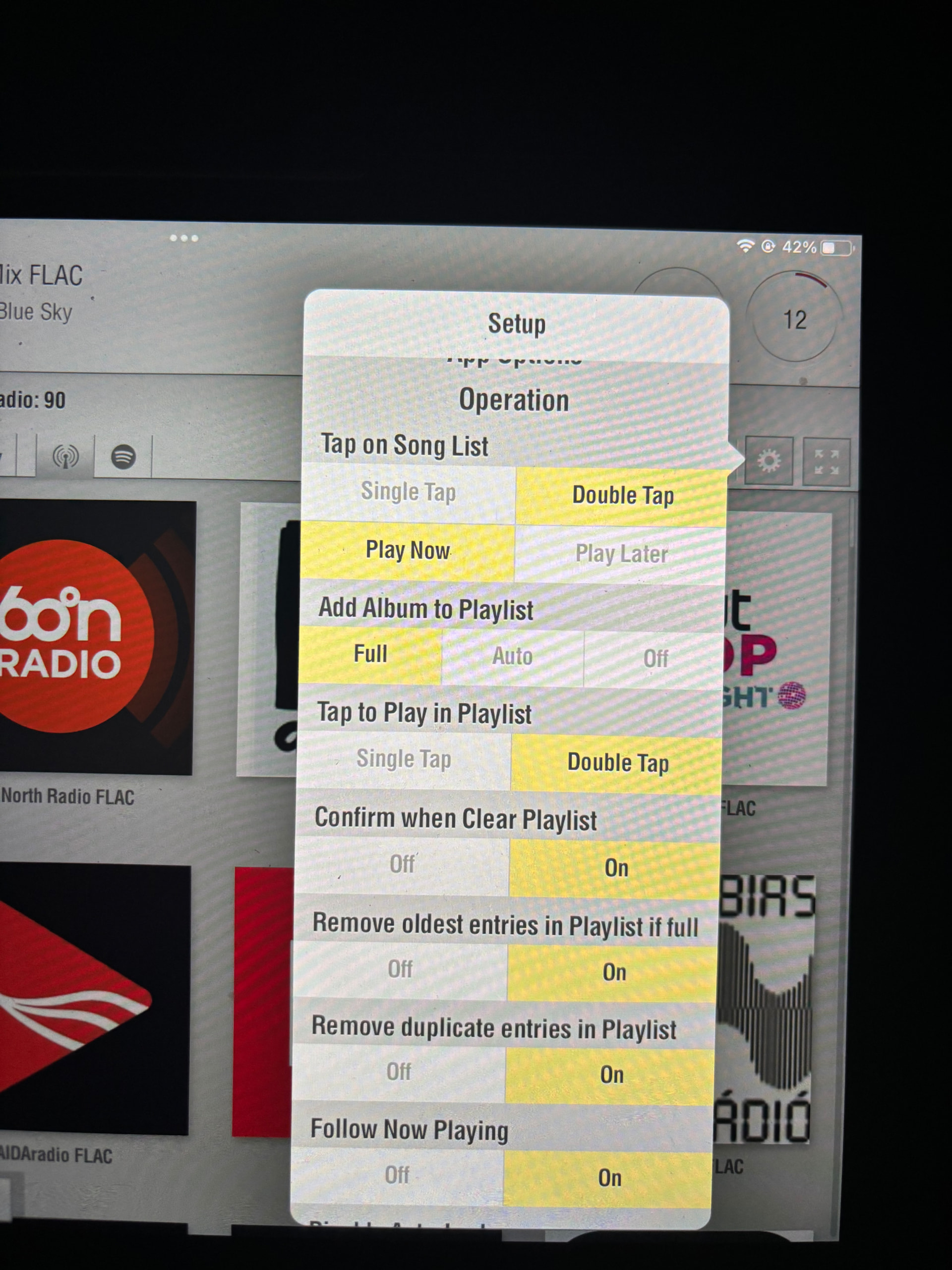

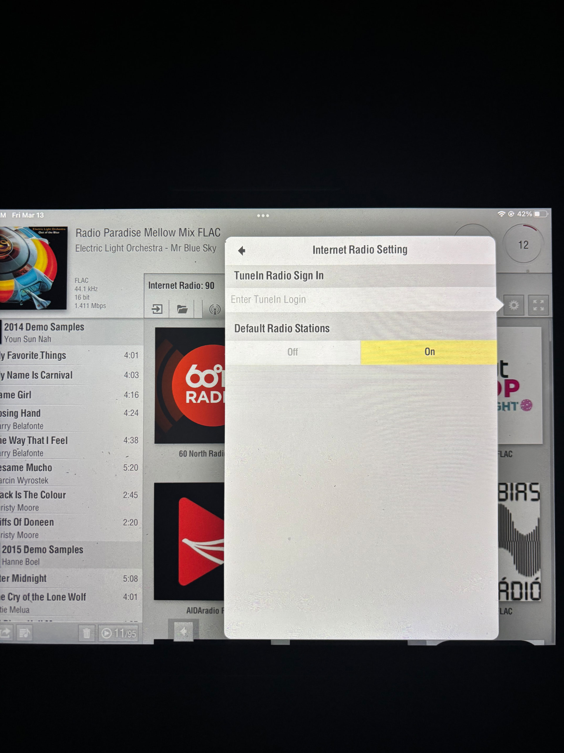

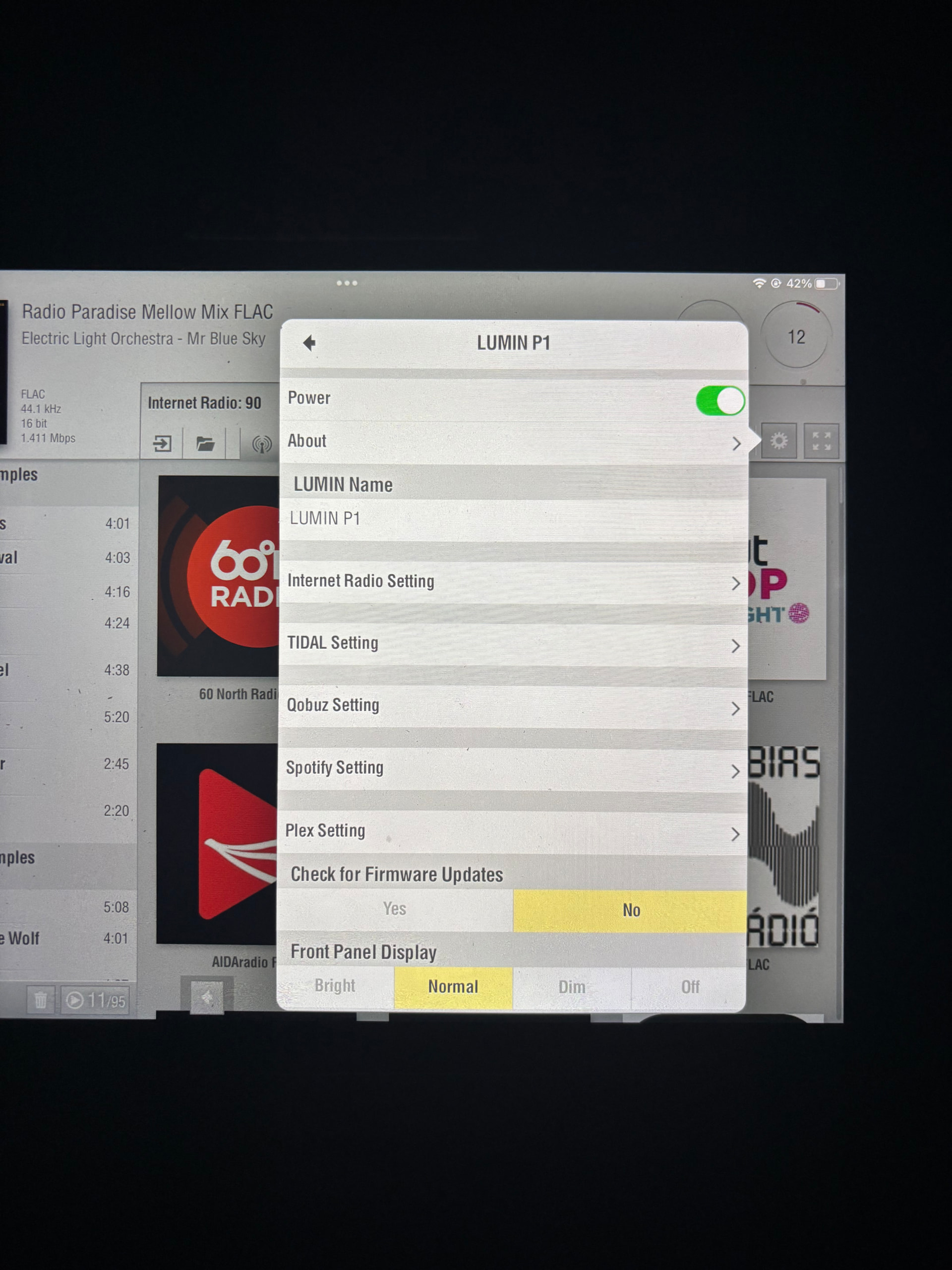

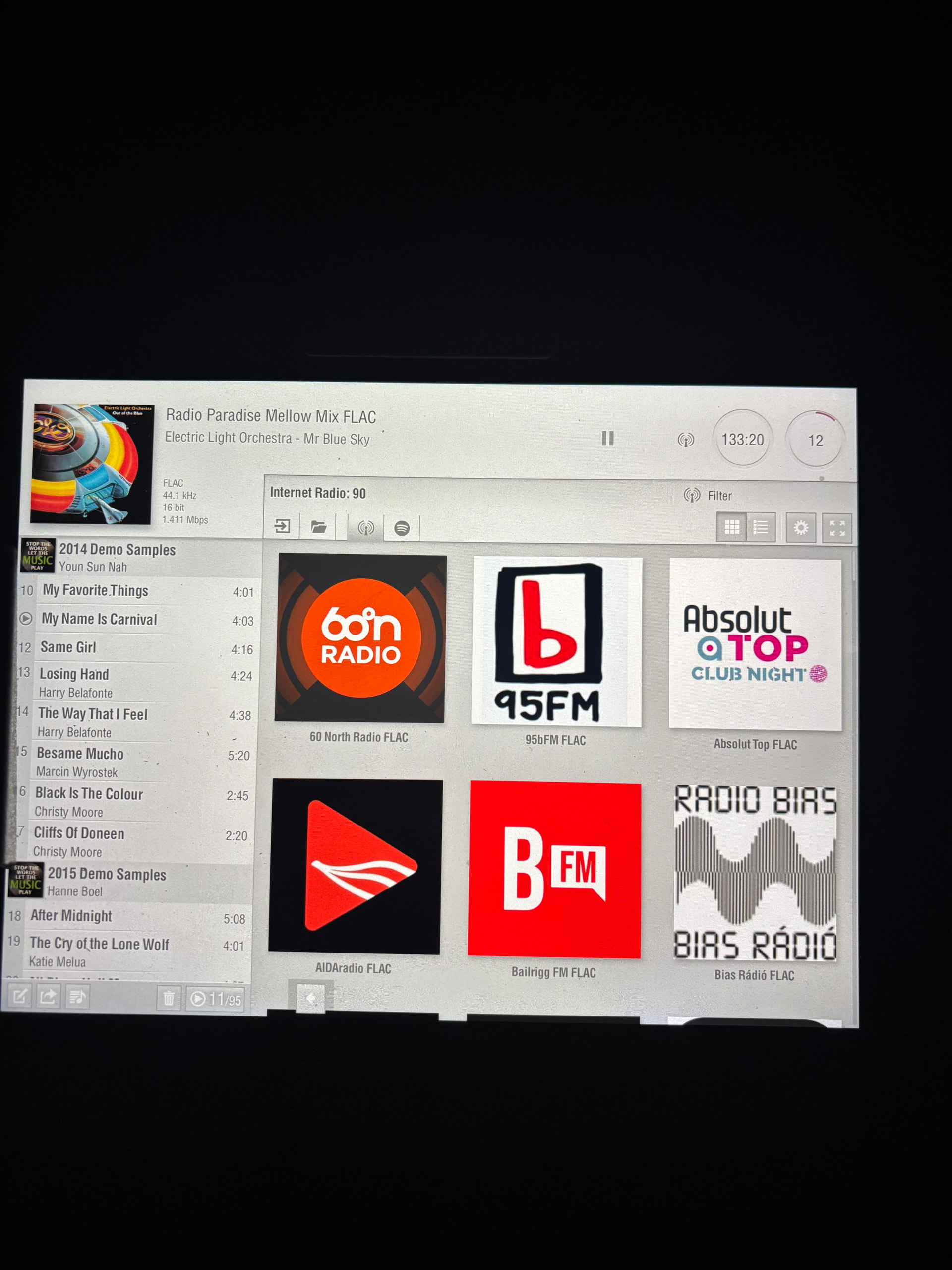

FR , I took a few photos of my settings. Have you tried internet radio yet? At the top right of screen you should see a running total of the time you have been listening and far right top is the current volume.

Did you check whether you may have accidentally plugged the Lumin into the NDS Digital Out socket (the bottom BNC socket) as per NeilS suggestion?
I don’t think I saw a reply?
When I use my Nds bare, all is ok. I have sound.
But not when the streamer is Lumin.
And yes, I plugged into input on Nds, no output.
