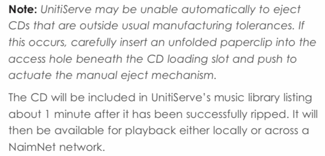

Is the CD still inside the machine? If so you need to find the little hole on the faceplate and inset a paper clip end to manually eject it. Try to turn off the machine in the normal way after that. Fully unplug and wait 10 to 15 minutes before starting up again and then keep your fingers crossed.
Yes the CD is still inside. Ive tried to eject via the little pin and nothing has happened. It’s now turned off and has been for over an hour.
Apologies if you are familiar with the manual eject process but if not here is what the manual says. I had one occasion where I had the same issue but can’t remember if the manual eject works when the machine is ‘off’. It was a stubborn CD that refused to eject and took a couple of determined prods to get it out. Failing that you may need to contact the Naim help desk to get advice on the best way forward.
