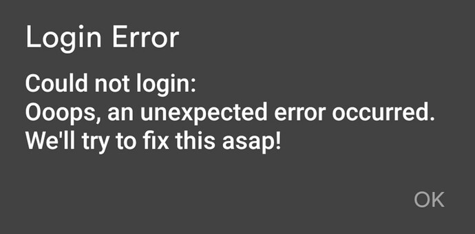

Wondering if anybody else is experiencing issues with Tidal / Naim app login.
I noticed yesterday that I was logged out of Tidal in Naim app. I tried to log back in and I am getting an error message. Same situation with iPad and Android Samsung phone.
Android example below:
Recently I downgraded my Tidal subscription from HiFi Plus to HiFi as I don’t need access to MQA with Naim. So I thought maybe this change in subscription is the issue. However, it all changed fine, even the monthly charges have reduced on my CC.
I tried logging out and in to Tidal on Tidal app and PC app and it all works fine. Qobuz also works fine in the Naim app, I can log out and back in. Streaming Tidal direct from Tidal app into Naim also works fine.
Today I unplugged the router, modem and all Naim gear. Deleted all apps and reloaded and still same issue.
Everything is running the latest software versions.
Any other ideas I haven’t considered? Any help would be appreciated, thanks.

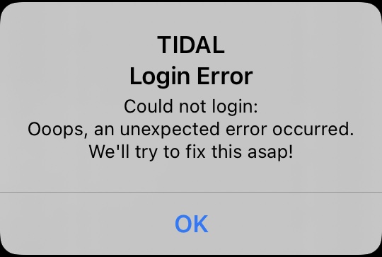

Thanks @Suedkiez, last night I did a forum search and found the info you are referring to, I tried few resets but no luck, just reset the iPad and still no luck.
Hoping the Naim team (@Richard.Dane and @Naim.Marketing) might have some ideas, I assume the error message comes from Tidal.
iOS error message using iPad
