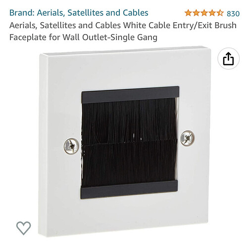

You can fit neat faceplates like this so any plugs can be passed through.
Yep, will be a large aperture trunking, power cable, 3 x hdmi and another to the muso which doubles as a soundbar.

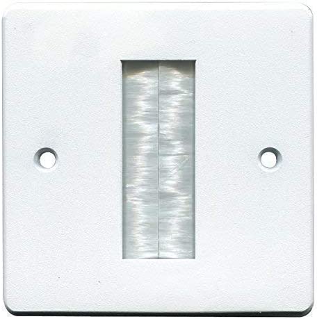

This, but we have far neater versions with a thinner vertical aperture.
Can get any cable end you like through them, HDMI no issue.
Ours are similar to this….
The brush faceplates are also available in double width.

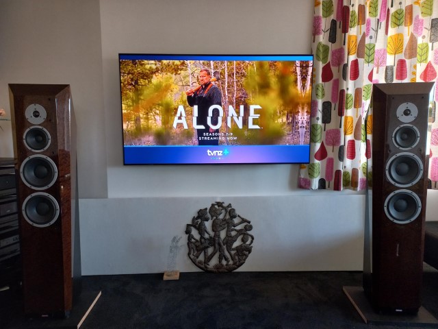

When we reworked our lounge we just built a wall around the kit so it all sits flush including in wall speakers. That means there are no visible cables at all and it’s very easy to add and remove any as required.

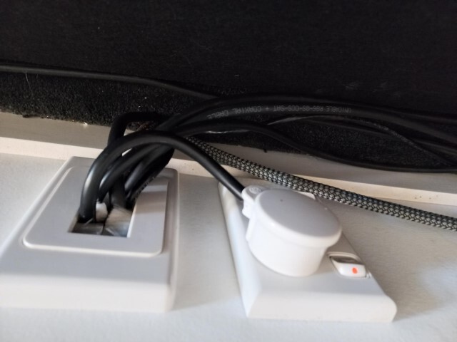

The acoustic ‘ceiling panels’ behind the speakers were installed for other obvious reasons, but they now double as cable concealers for the stuff that should have been below the floor.
