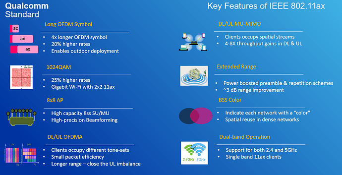

11ax gives longer OFDM symbols and 1024QAM which give up to 4x throughput when compared to 11ac. It also has some other tricks to make longer range and small packets more efficient. It’s also better at splitting streams for simultaneous multi-client connections.
It should help with higher density but also with lower user numbers for higher throughput.
