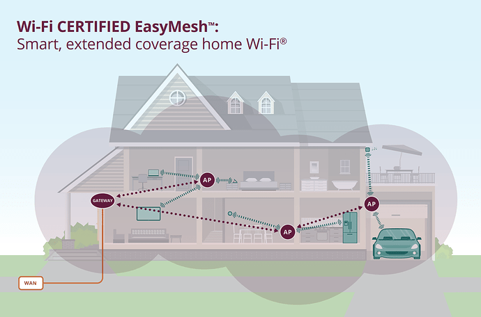

True Hybrid Wireless Mesh Protocol (HWMP, 802.11s) Mesh systems use many access nodes and route the the data across the nodes.. these are only really used in commercial setups over large areas and require extensive setup.
On the other hand consumer proprietary and consumer EasyMesh type systems, such as the BT, are not true (802.11s) mesh systems, however they are significantly simplified, and optimised for home networks, and are limited to the number of access points (and don’t use nodes) , seemingly around three, and collaboratively work with each other. However unlike true mesh systems, EasyMesh type systems are a doddle to setup, ie they are plug and play and are suited to smaller domestic areas like houses and gardens.
Wifi extenders are an old technique where a remote access point has its data sent in band across the WLAN, this is inefficient and can lead to poor performance on the extender, or combined wlan, depending on configurations and setup.
However one should remember with mesh systems that although hugely more efficient than extenders, still suffer a throughput hit across wireless hops. With EasyMesh systems because you have only a small number of access points this is unlikely to cause a noticeable issue. True Mesh systems require careful planning here.
Another consideration that is sometimes mis understood is Wifi roaming between access points/nodes. For this to happen quickly, a protocol called Fast BSS Transition or 802.11r needs to be supported by the client AND Wifi system. This allows the initial authentication association to be preserved as the client connects to the new access point or node.
However for this to work, the client along with the Wifi system has to support 892.11r correctly and in which case roaming will be seamless.. if not there will be a lengthier interruption when roaming. Some devices have no or deficient support for 802.11r. Wifi logs, if available, will indicate roaming or re authentication. Some older client devices might need firmware, software upgrades or might not be able to support at all.
Also another consideration is IGMP, depending on how IGMP is internally setup and implemented in your EasyMesh product, you may have a discovery delay when you roam.
For those who are interested, a précis from a usability perspective on EasyMesh. Essentially if going into consumer mesh systems don’t rely on being able to mix and match access points anytime soon.
