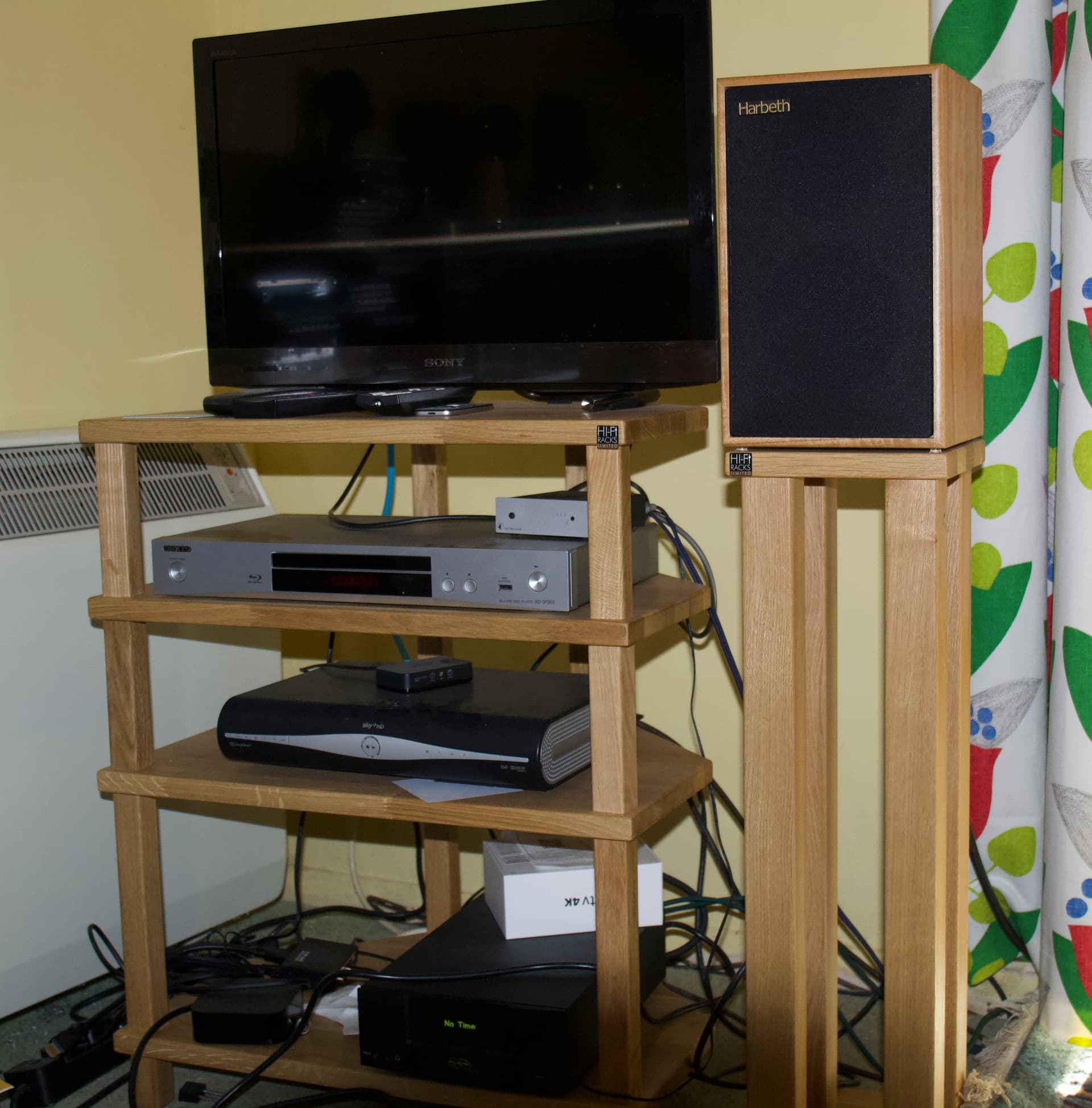

But it seems SkyQ (as @Ian2001 kindly pictured above), which is a cheaper Sky service than Sky+HD, doesn’t have RCAs, as it’s all digital.

My experience is that the sound is better from the newer box is better , I used a UnitiQute as a DAC
