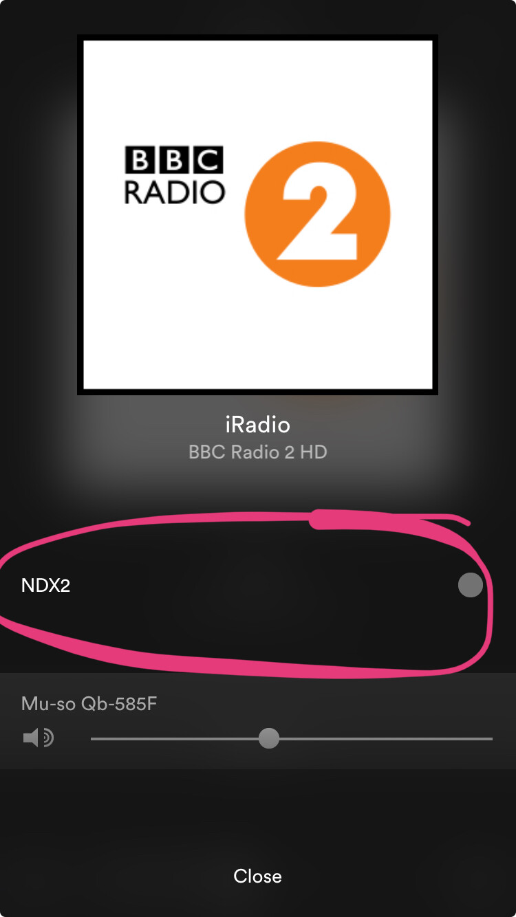

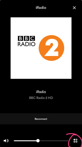

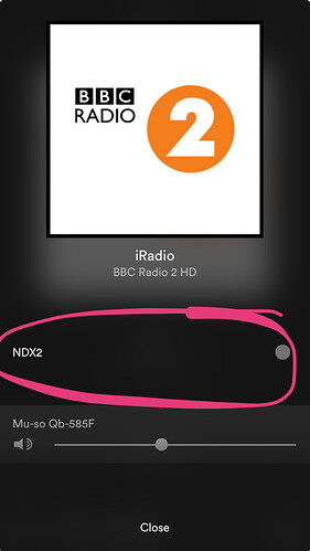

Embarrassingly, I’ve only just discovered that you can simply join a Multiroom session from the top dial of a Mu-so…Just happened to turn the kitchen QB on and noticed the multi-room icon, one press and it joins an already playing device in the house……(not sure what would happen if two separate devices were already playing?)
I have always initiated Multiroom from the App, until now (for the Mu-so’s anyway)….! :flushed:
