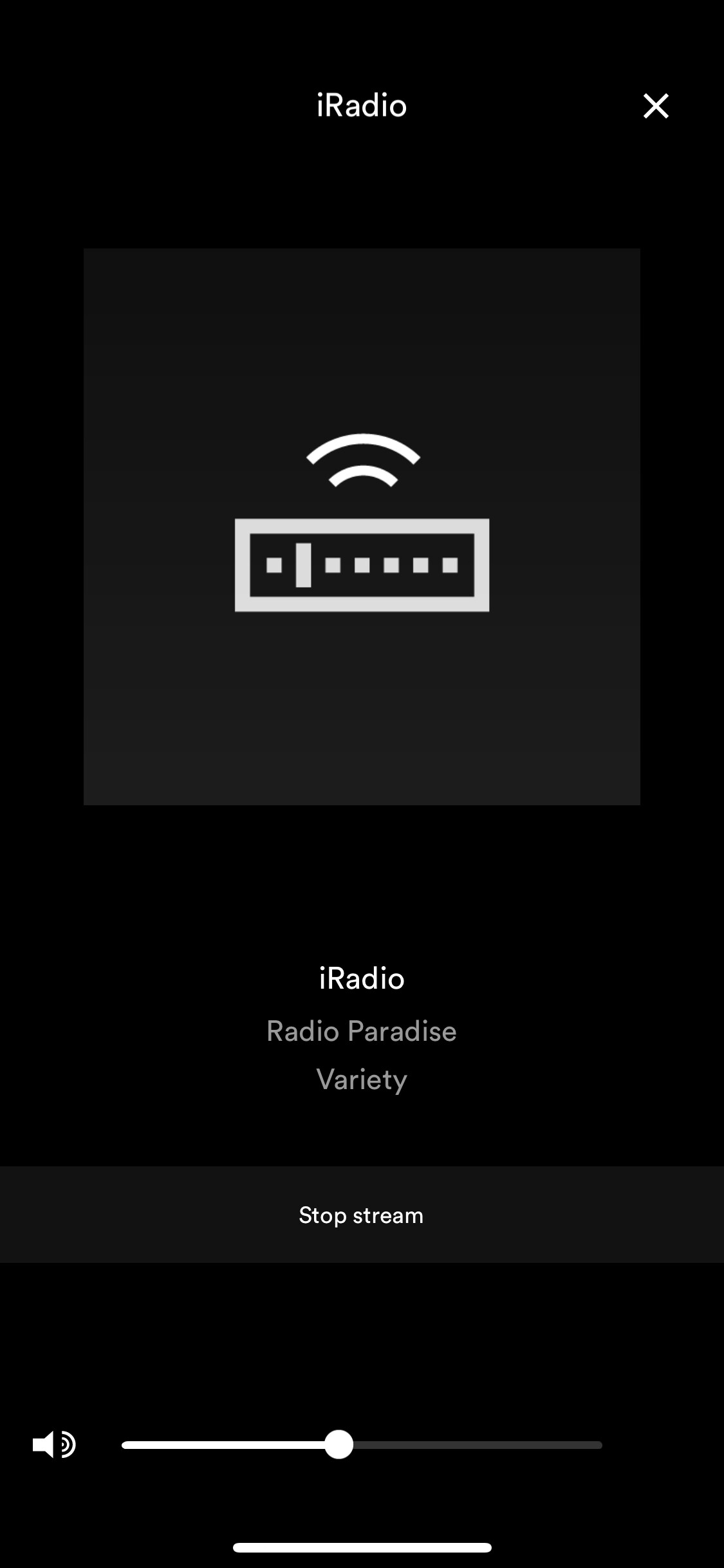

Come back home, and it’s gone. See pictures below detailing 1) I have two connected Mu-so devices 2) the multiroom button is simply not present in the Spotify view 3) the multiroom button is not present in the internet radio view

Multiroom is, and was, turned on in the app settings. If indeed the setting is to be found under the “inputs” menu, see photo below. I also did a firmware upgrade as part of the initial troubleshooting process last week. Sincere thanks for the suggestion, unfortunately it appears to already be on and the multiroom button is still missing.
