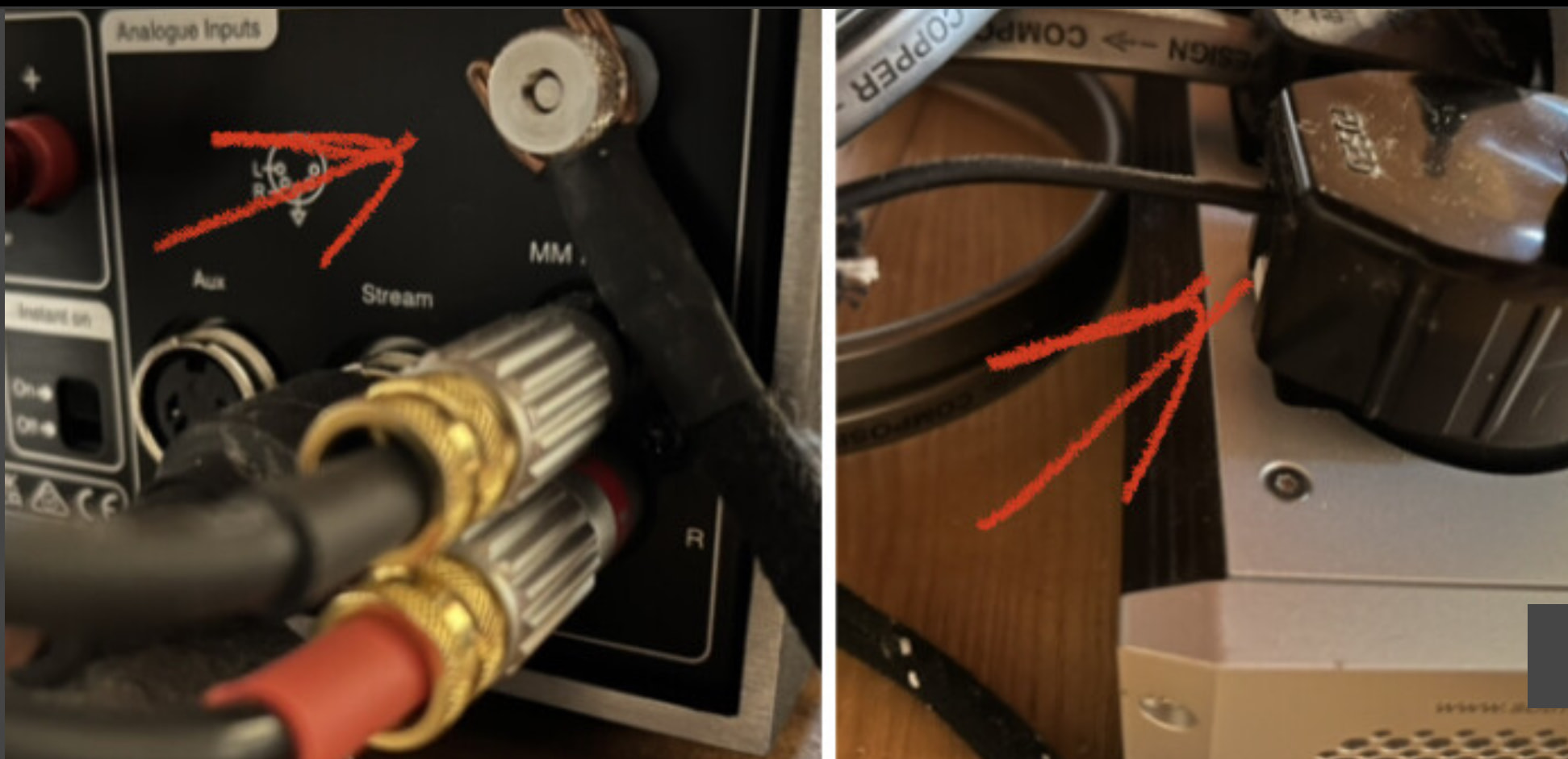

I should also add I did try connecting a grounding wire from the N50 (at the grounding post) to the electrical outlet faceplate screw (which I think should connect the N50 to ground independently?) It did nothing.

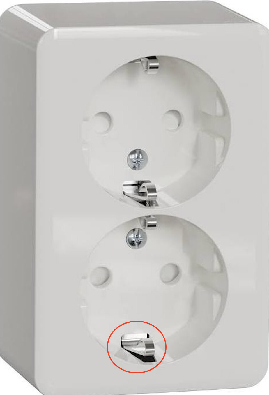

@b-lilja Not sure where you live but have you tried connecting the ground post on Nait 50 to a mains ground connection somewhere? Note that some ground posts on electronics are just signal ground without connection to ground. If in Europe you can hold the cable against the ground pin on the socket.

When my LP12 had a Lingo 4 it was fine with the N50 but the upgrade to Radikal 2 did bring a feint hum. I just added a wire from the N50 ground post to mains earth and silence was restored

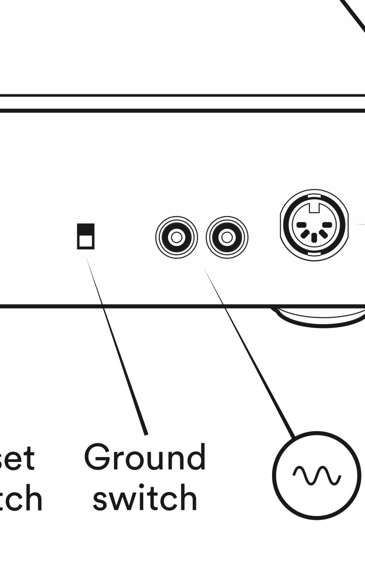

yes it could suggest that - or a capacitively coupled ground loop - ie there is a not a low resistance path to earth in your source - so your N50 input has a floating ground.
Your Creek might not be expecting a grounded source. Often there are slide switches on phono pre amp stages etc to handle this, or you can strap the ground from the phono stage to the grounding tag on the N50.
