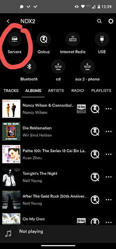

It’s Servers on the main screen, and if you click this, you see Local Music. This is on Android:
If you also have a UPnP server, you find both Local Music and the UPnP server under Servers

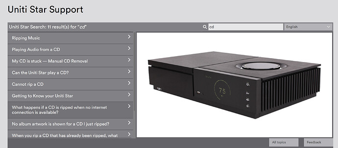

Unfortunately, this is as far as my knowledge goes. I only used a Nova briefly in the past, and don’t have a Star and never tried its CD ripping functionality. Based on my limited knowledge, it looks to me like @PhilippVH’s post directly above is on the right track. I am sure a Star user will be able to help further. Until someone shows up, maybe the online help is helpful? Go to https://www.naimaudio.com/product/uniti-star/support and search for “CD”, then you will get a list of topics to read:
