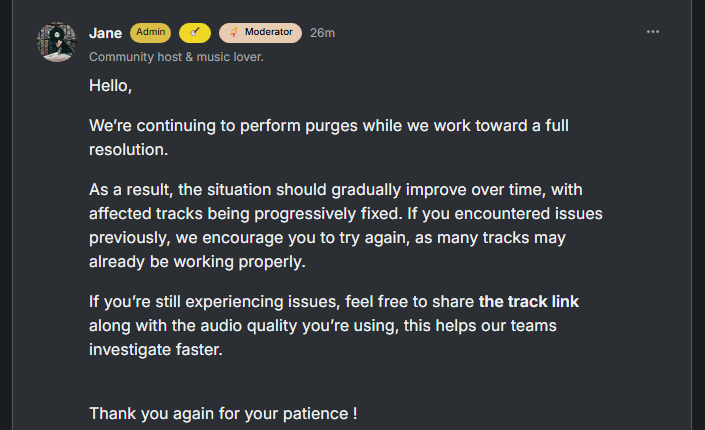

Just FYI: A message from Qobuz support staff, some Qobuz users, including myself, suffer this issue during the past weeks.
I notice that this issue manifests itself more frequently if you primarily play back playlists.

The first two issues, albums and tracks no longer available I think are down to Qobuz not Innuos, it is annoying though. The last issue of tracks stopping early or skipping tracks etc seems to be a Qobuz issue which they have reported was a result of a ‘caching anomaly’ which they are working towards resolving.
