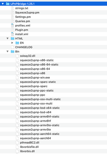

Here is the screenshot of what I have downloaded and unzipped:-

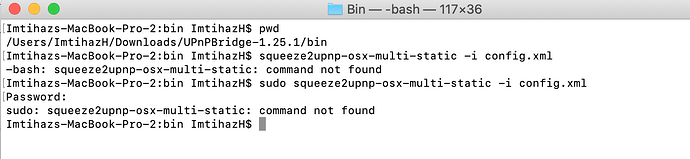

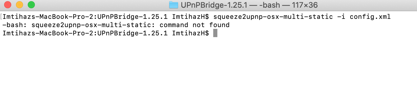

Still no success. What Terminal command do I use? I got the following:-
I user shown has admin privileges.
Thanks,

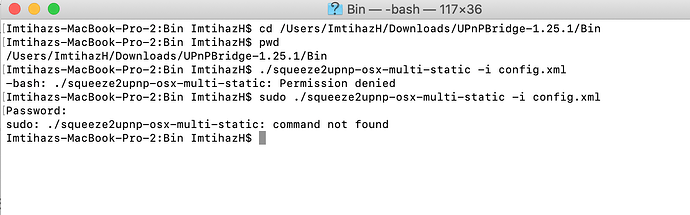

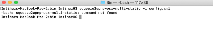

I noticed I was not in the Bin directory. Tried again:-
Whilst not a Mac person I think you need to add ./ to the front of your command, at least that what you would do in Linux.
This forces it to use the current directory rather than search the path for the program as the directory you want to use won’t have been added to the path.

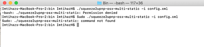

Thank you. Did that. Still no luck.

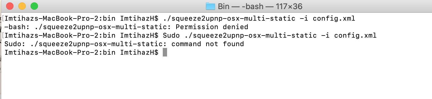

Are you logged on to the Mac with “admin” privileges?
Jack,
Yes I have admin privileges. But just in case I tried to execute the command with ‘sudo’ and it prompted for my password. See screenshot above.
Thanks.

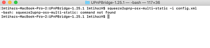

You sure you are in the correct “Bin” directory…you may be in the default Mac bin directory looking at your prompt. If you enter “pwd” it tells you exactly where you are. You should be in a directory that is something like your home path then /UPnPBridge-1.25.1/Bin
Jack,
I thought about that as well. Tried again, see below:-
Thanks.

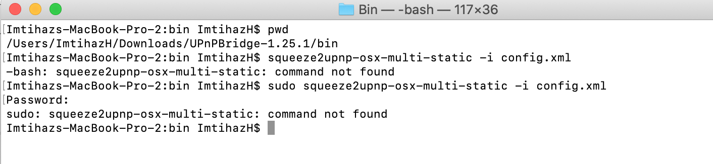

just try…
./squeeze2upnp-osx-multi-static -i config.xml
I did. Still no luck:-
Thanks.

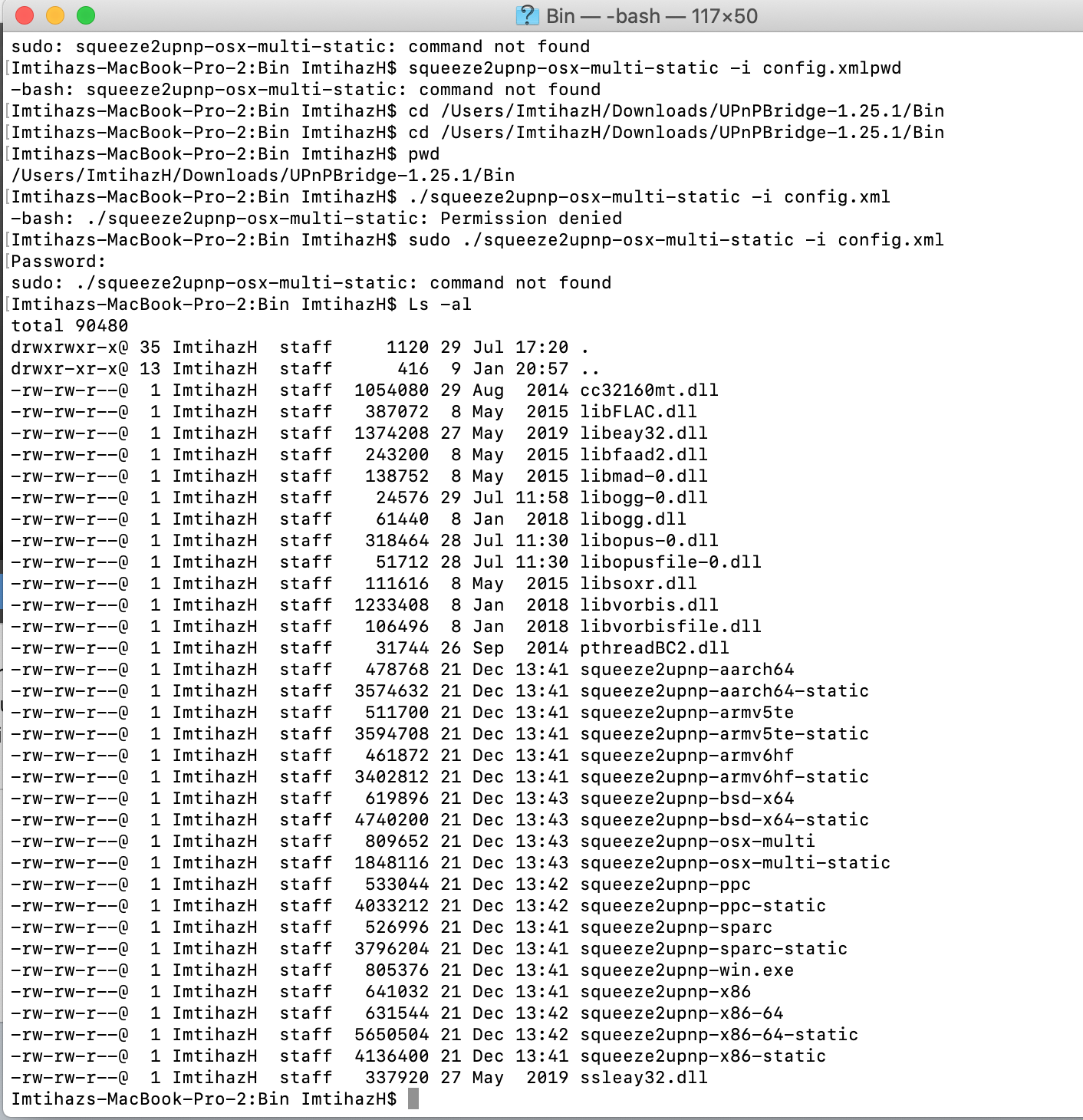

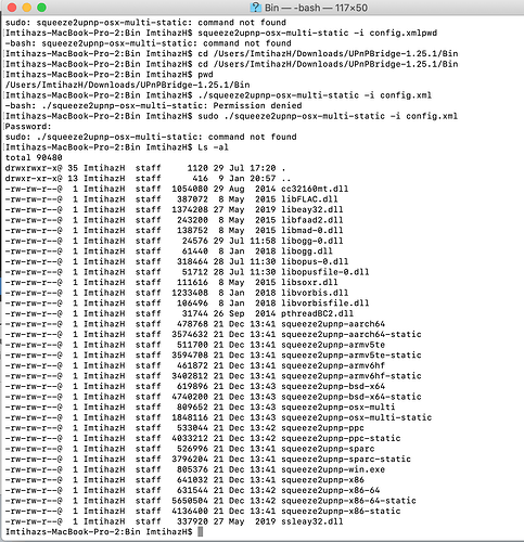

That’s very strange, that should have worked…can you do a “ls -al” and post the output please?
Jack,
Find the results of Ls -al:-
Thanks.
