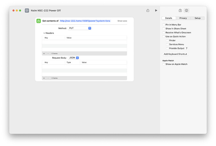

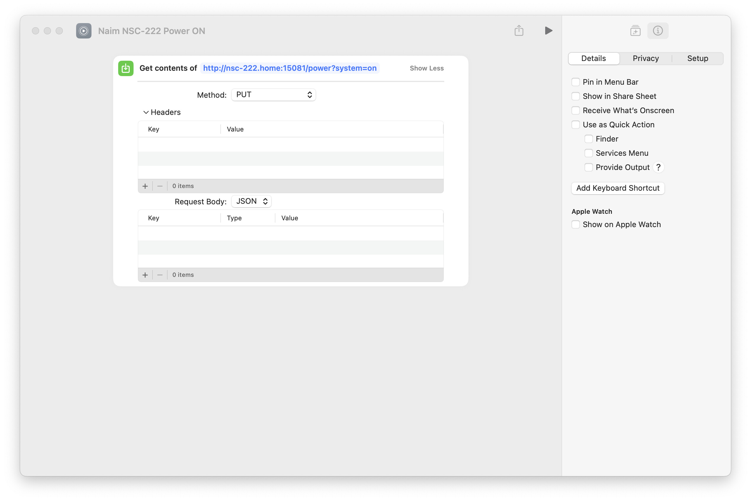

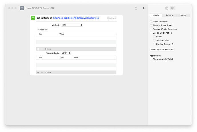

Think you’ll need to change HA to do PUT requests, seems to work with my NSC-222 using Apple Shortcuts.

Well that is odd… I created some apple shortcuts and they work fine, but not from RestMan or Home Assistant.
Thanks for reminding me they’re put requests by the way! Home Assistant was configured correctly but not when I was testing from a web browser.
Network seems fine. I haven’t included anything in the header or body. I will investigate further.
