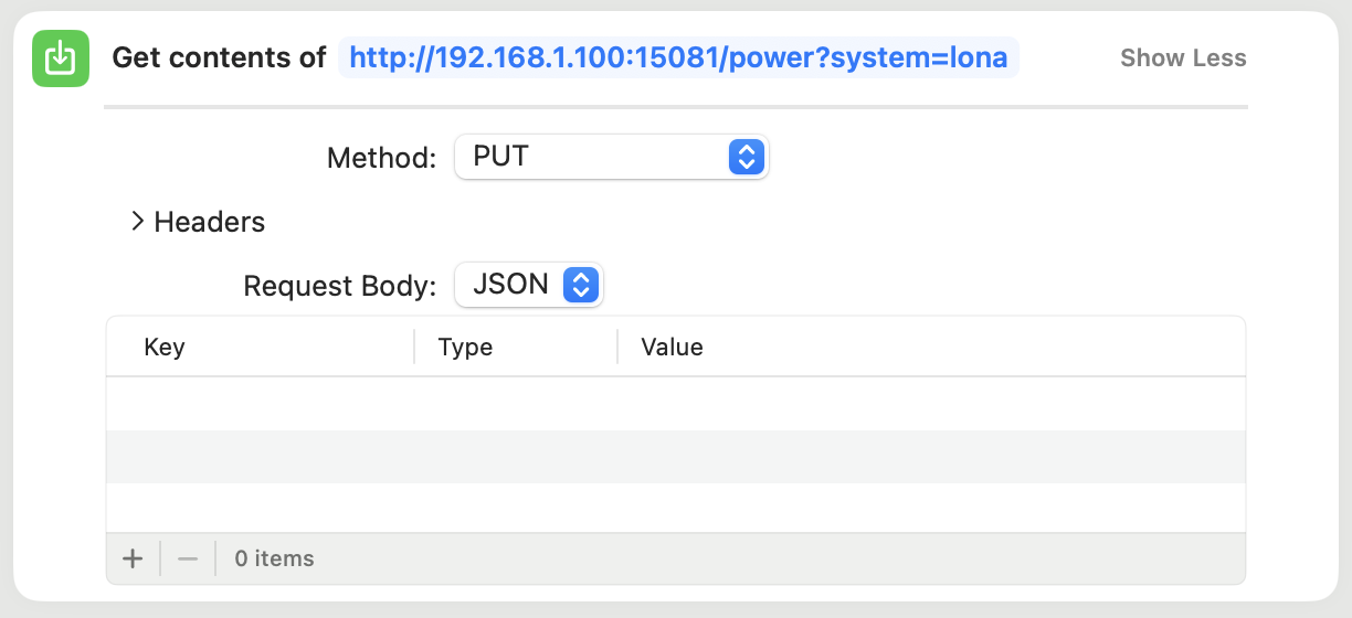

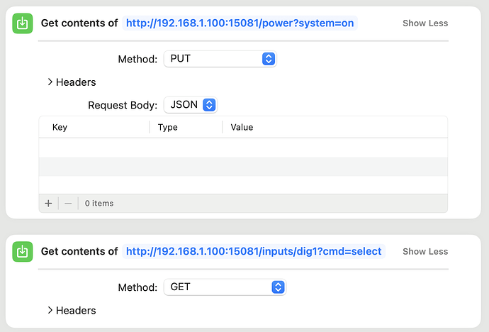

As much as I love my Mu-so’s (2 and Qb 2), I have two minor annoyances:
The Mu-so 2 is connected to an older TV (no HDMI-ARC) via Optical – selecting the digital input via the app or by pressing the source select button on the remote repeatedly gets a bit old, especially for other family members;
The Mu-so QB 2 is in my bedroom (with lighting off). When it goes into standby, it says goodbye with a light flash, which is annoying in a dark room when almost asleep. So I like to turn it off manually after listening, but IR from the bed is weak and the standby button in the app is hidden one level deep.
To make life a bit easier, I created a few Shortcuts to live on my iPhone, accessible one swipe from the lock screen without unlocking the phone:

These IP control commands also work for the Uniti range and can also be used in home automation platforms like Homey and Home Assistent. I could not find any official listing of Naim IP control commands - so this is all trial and error.
Play send a GET command to: http://[Naim IP]:15081/nowplaying?cmd=play
Pause send a GET command to:
http://[Naim IP]:15081/nowplaying?cmd=pause
Stop send a GET command to:
http://[Naim IP]:15081/nowplaying?cmd=stop
Mute volume send a PUT command to:
http://[Naim IP]:15081/levels/room?mute=1
Unmute volume send a PUT command to:
http://[Naim IP]:15081/levels/room?mute=0
Set volume to a specific value (“25” in this example) send a PUT command to:
http://[Naim IP]:15081/levels/room?volume=25
