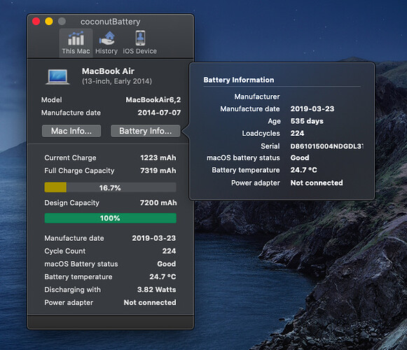

If you have a mac of some sort coconut battery can be helpful (correction, and windows)
We used it to get apple to do something with our daughters 8 as the phone said it was OK, it wasn’t . They agreed to replace the battery for 40 quid. They are far from genius’s
I know its an Air but the phone diagnostics is similar. You can see its an older MacBook but i replaced the battery last year

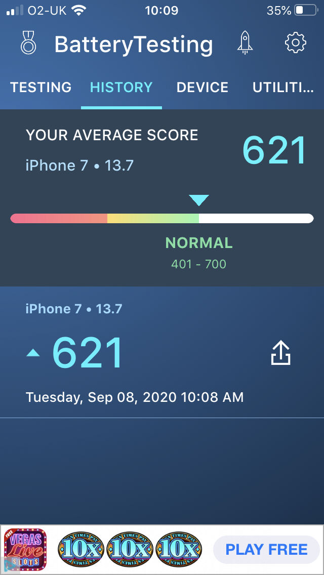

Tried this app and it reports back as normal.
Cant use Coconut, dont have a Mac. :+1:

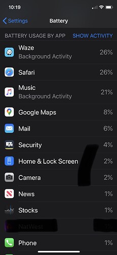

If you check ‘battery’ under settings, you’ll see which apps are sipping the juice the most - in my case, it was Siri (using nearly all that 80%), and after turning it off, all was OK. iOS update to 13.7 and a full power cycle seem to have also helped, and Siri is now back on (needed for CarPlay), with no overnight ‘sucking the battery dry’.
