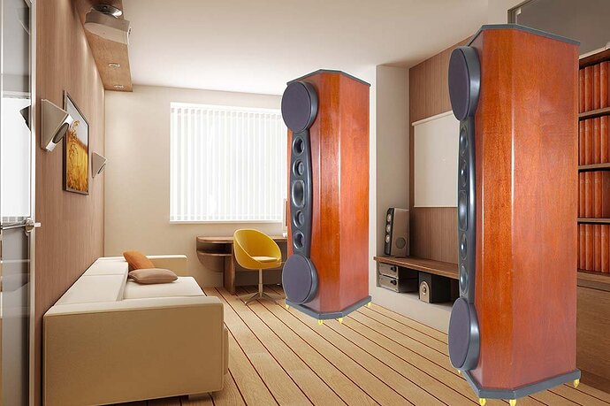

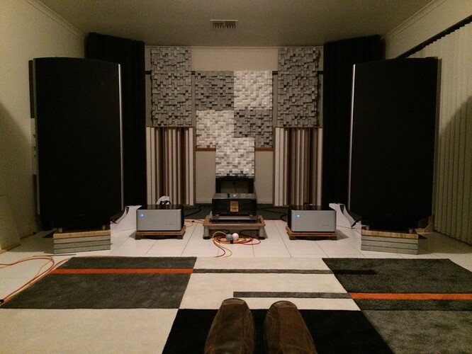

I wonder if the room need some acoustic treatment in that case ?
If I had to choose between this :
Or that :
I would choose the first to really enjoy the music in a lively not dead room.
I think a bit of the problem here is that people talk of a ‘dead’ room and assume lots of acoustic panels , or they see a picture of a well treated room and assume its ‘dead’.
‘Well treated’ and ‘dead’ do not have to go hand in hand. To get a well treated live room you have to use the correct panels , in the right quantity and in the correct position.
Just sticking up loads of full range panels will give a dead sound.

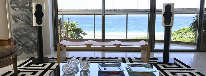

And the view
