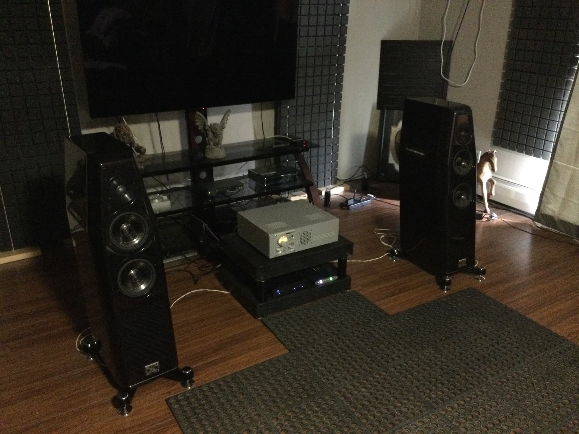

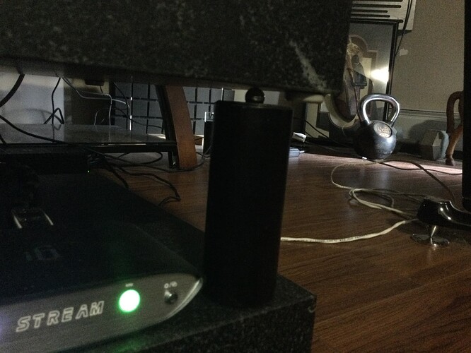

I have made my own ā€œSuper Fraimā€ out of two granite slabs, or Layout tables. Under the bottom slab there are three homemade cups and balls.Between the bottom and top slabs are three 2 inch diameter steel posts, with balls on top, sitting in holes drilled in the posts. The slabs are 150 pounds each, so this thing is SOLID.
No Naim pieces any more, but Nagra integrated sits on top, IFI Zen stream and Musical Fidelity MX Dac underneath.
Total money invested in the rack…$200 Canadian dollars.

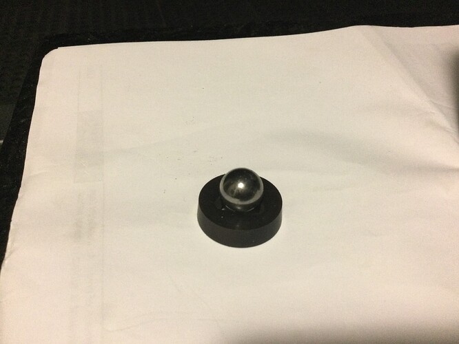

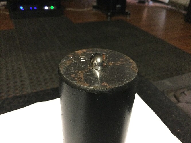

Here are the posts and cups/balls I made that sit between and under the slabs.
Interesting.
What are the cup and ball made of?
A steel ball?

The balls are steel and the cups are carbide, I cut a triangle shape in the middle of it with a wire EDM machine at work. The ball sits on three points just like the ones you buy from Naim.
