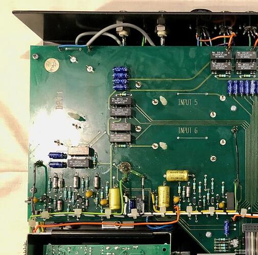

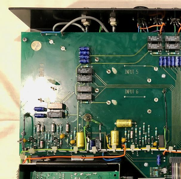

I have an issue with the phono input of a recently acquired 52. I upgraded from a 82/HicapDR last month. They sounded great as is and a nice step up from my 82. I only tested the CD input - it didn’t come with phono boards. After a week of listening to the 52 I sent the Supercap off for a recap. I figured the Supercap is going to need a service soon so best to get it done while I still had the 82. They were both last serviced close to ten years ago. Now that the SC is back I put my 82’s K phono boards in the 52 and it sounds a bit off and constricted on the phono input. Lacks punch. Same with another set of phono boards that better match the output of my cart. Vinyl on the phono input now sounds like a downgrade from the 82 while the CD & tuner inputs are still an improvement. All outputs on the 52 might be a little less. Turntable is a Rega RP8 with Audio Technica OC9XSL. Any ideas? Does that little jumper wire in the upper left (under the blue wire) need to be snipped? or is that just on the tape input? I bought this from a dealer who said it didn’t have any problems.

But what about those wire jumpers on input 1? Do they remain intact with phono boards or snipped? I did a search and didn’t find the answer.
Dont snip anything, you are not experiencing a jumper problem. Your 82 might not have been able to delineate the weakness in the cards or worn components, your 52 with fresh SC certainly will. I would get a second hand phono stage and some second hand chord signatures or better to connect it. I can readily hear differences repeatable and describable in my system with the slightest change, even a 1 mm record mat, the 52 is the sh*t. don’t used the cards, or get them rebuilt vs new ones. The other option is to get MM cards and a nice SUT or head amp. Its a lot to ask two small cards to do 2 gain stages, I have stage line MM that I use on the 52 if I have a blown tube or issue. Need a vinyl SS back up. With a great sut it sounds great even on the 52’s power. I would use that hicap DR.
I’m copying @NeilS and @Richard.Dane , one of whom will be able to advise on the links. This is the first thing I’d look at. Servicing is far less of an issue with preamps and it’s not something I’d be worrying about. I’d also not be worrying about using the internal boards. Naim boards are excellent and more then good enough for your Rega and AT cartridge. Back in the day people were using Naim amps with built in boards with top of the line Linn, Roksan etc. decks, with great results.
IIRC, you shouldn’t need to cut any links here.

Not necessary to cut any links on input 1 in your NAC52.
