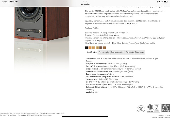

I have some atc scm20’s on demo which I am trying with existing rels s510’s. I find it a faff getting the settings right.
For the act 20’s I can’t seem to fathom the lower frequency.
