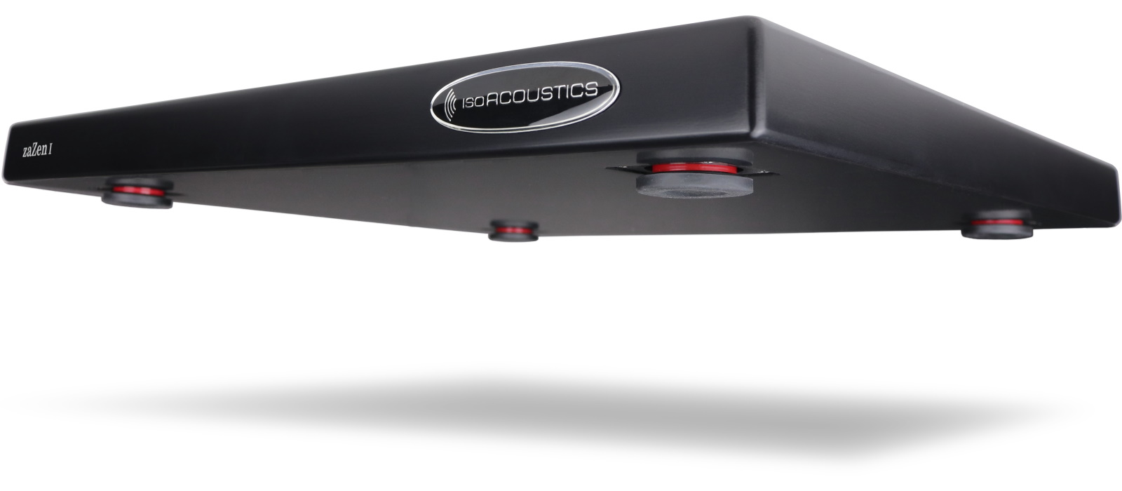

As a compromise how about something like an isolation shelf you could place between the amp and the source? IsoAcoustics zaZen springs to mind.
You’d still need to make sure the feet didn’t mark the Naim casings, as they do mark very easily and quickly, perhaps some small squares of thin plastic?
