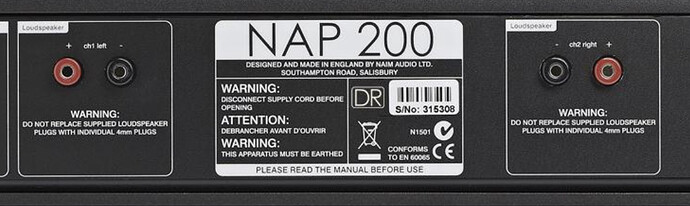

Are you sure? It’s a common mistake to assume that the terminals on the L of the amp would go to the L speaker, and those on the R of the amp would go to the R speaker, as viewed from the front.
So I’m looking at the amp facing me, front facia, I’ve got left speaker connected to left and right to right as I see it.
Hi. If the signals are correct going in to the 202 then I agree the SNAIC to the 200 cannot be wrong. (You say DIN cable, I assume Naim SNAIC?) That leaves checking the the output of the power amp. Looking at the back of the amp from the back the right speaker is on the right. CH 2 Right. Check this and report back.
should it be left right as if i was viewing the rear? thats a bit strange as it means my speaker cables cross each other
No. Correct and yes they may cross each other. CH 2 Right on the right looking at the back.

bloody hell, looks like ive just taken for granted left and right. Seems i have plugged my speakers in the wrong way. Is this a naim thing because my meridian was left and right from the front not rear.
thanks for the help, I fell like a proper ejit
Don’t feel bad, as you’re not the first person to be fooled by Naim’s slightly odd configuration, and you certainly won’t be the last. ![]()
just swapped them. Gonna need some new speaker cable legnths.

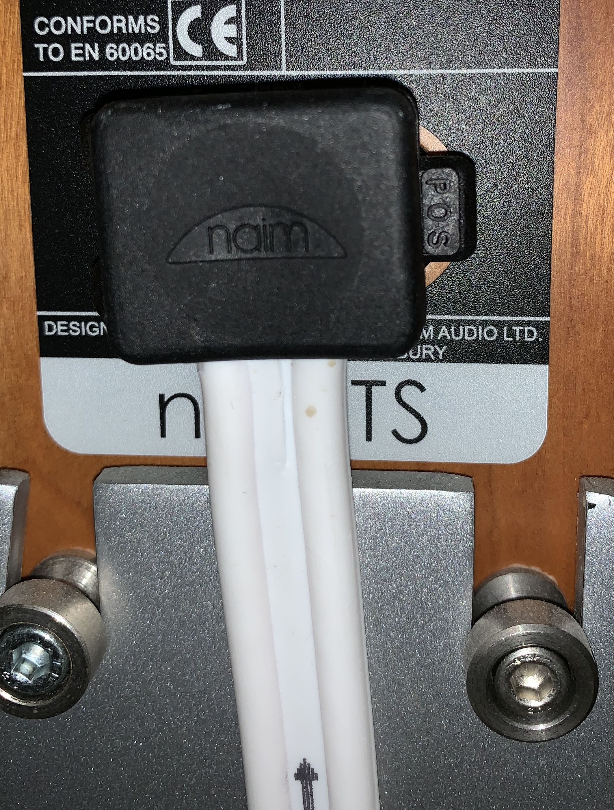

I have a related question.After I move the system, zip forgot which Pin should be Red and which should be black… I hope I an nit running the wrong polarity
As long as you are consistent, it won’t matter, but normally, red is + and black is - unless, of course, if you have Naim plugs in which case this doesn’t apply.
I am using naim plug and AC5…
