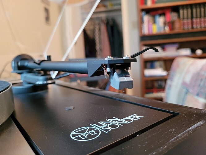

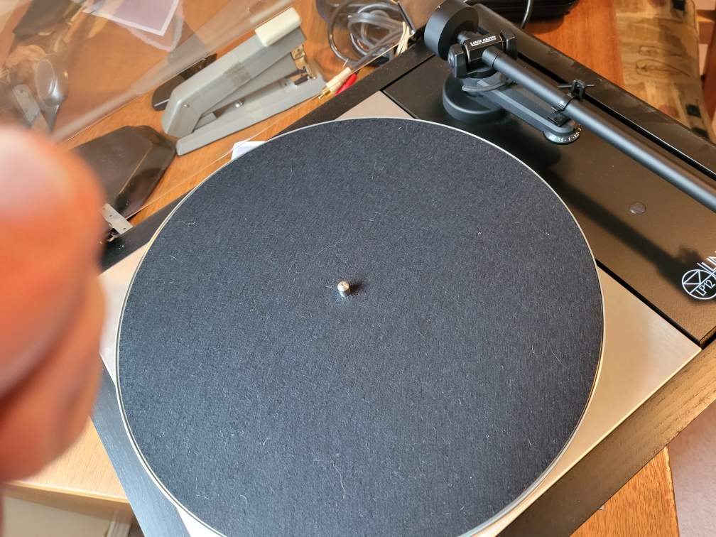

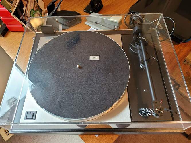

I have a chance to replace my Rega P3/RB300 (not the 24v version) with a Linn Sondek LP12/Akito. I’m not sure what the exact age is but it has a 81,000 series serial number so from what I can see that lands it around 1989-1990. The unit looks to be in pristine condition (9/10) with a black ash plinth, but the age does concern me. Having said that, I’ve always wanted an LP12 and the black ash is a bonus for my ascetic tastes.
Any thoughts on whether this would be a good upgrade from the P3? I was originally looking for a newer P6 but this opportunity has just kind of landed on my lap.

The old Akito would need to be properly appraised. Any sign of bearing issues and it’s fit only for scrap. Having said that, some have excellent bearings and the best ones can be surprisingly good. I was once given an Akito that was supposedly the best one particular dealer had ever come across and it was really rather a nice arm. I think the problem was that many succumbed to owners over tightening things and wrecking them in the process.

Thank you to everyone for the thoughts and advice. It’s quite a bit to unpack given the variables. From what I gather this LP12 is bone stock (Akito/Valhalla). I don’t necessarily have a budget at this time for upgrades but I’m mechanically inclined and would look forward to it in the future. I also have a local dealer (Vancouver, BC, Canada) so I’m certain I could get technical support and parts.
The seller is looking for around $2K CDN which is equivalent to £1,166 GBP. I was thinking more like $1,600 CDN or £930 GBP but it’s still a lot for a table with unknown condition. Other than the tonearm bearings is there anything else you would advise me to look out for? Any other advice would be welcome as well.
