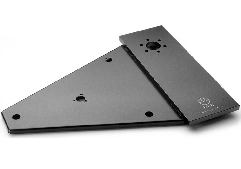

the Majick sub on difers from the Kore by the addition of a glued arm board, so if you moved to Kore for your arm as you mention you would need a drilled arm rest on the arm board

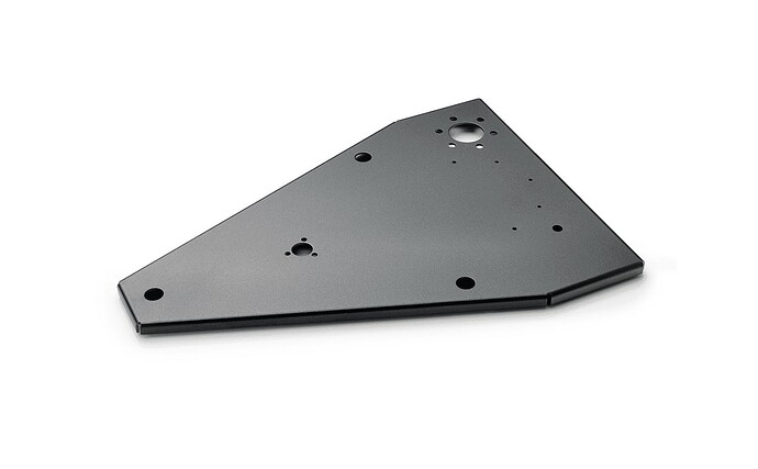

Neil; I think I get your question; since the tonearm is is affixed directly to the sub chassis, why choose the Kore over the Majik? I too am struggling with the why and how a Kore will be better. There was some discussion on another LP12 fb group today with the only answers being a Kore is the next step in the progression-which does not answer the how or why it is better than a Majik.

Majik Sub has provision to bolt on a laminated armboard whereas the Kore has an integrated machined metal armboard like a junior keel if you like.
Quite different beasts entirely.

Hello and thank you all for your help, I believe I now have a handle on the differences between the majik and kore essentially it’s down to materials, the majik uses the laminate armboard and the kore it’s machined aluminium, if I understand than regardless of how well bond between the majik and tonearm is it will never be as direct as the metal kore, will put the build on hold at the dealers until I source a nice ekos and kore, I don’t want to have it built and then have to have it taken apart and rebuilt, thank you all for your help it really has been appreciated.

Now here’s a thought, how about if Linn were to produce a metal armboard which could be bonded by the dealer to the majik sub chassis, this would be a cost effective upgrade perhaps not quite up to the factory manufactured kore but would be pretty close, how about it Linn.

The Kore is not a Majik with a bonded armboard.
Yes understood but both sub chassis 1.5 mm aluminium same construction, it’s the alloy armboard bonded onto the kore chassis that’s different so if they produced after market alloy armboard for the majik it would surely be pretty close to the kore, obviously it would have to be done at dealer with same adhesive as kore, what’s your thoughts.
Thanks. I was laboring under the misunderstanding that it was, but then again, much of my life is spent that way. Other than an integrated arm board how are they different?
As @Neil1956 said… Very similar, AFAIK - but the Kore incorporates the Armboard - which is metal, not fibre board. But - the Kore doesnt have the Arm Mounting Ring built in, like the Keel does.
I could be wrong but I understood that the Kore was a slightly better construction but maybe not.
