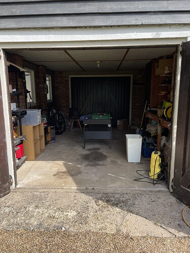

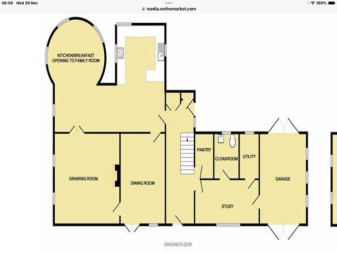

Hi all, plenty of threads on listening rooms recently and I would appreciate a little gentle counsel from the learned folk of this forum.
I have an integrated garage (5m long, 3.6m wide & 2.25m high (20cm between current ceiling and room above)) and plan to turn it into a dedicated listening room.
My teenage daughters room is above so I want to achieve 2 things:
  1. a level of sound proofing - the more the better to maintain family harmony
  2. the best acoustic design I can achieve in the room
Phase 1
  • Brick up doors at one end (it has garage doors front and back)
  • Part brick up the other end but have a large set of French doors
  • Brick up the three windows on the side (they will be right where the first and second reflection points are. (I’ll sacrifice a little light for acoustic purposes and hope I get enough light from the large French doors.
Phase 2 - the walls
I will loose some space with building regs and insulation as the garage is only single brick skin
  • in- between the outer brick and the final fit plaster board I will need insulation. I could just use standard materials but what are my options
  • use a product like acoustiblok to sound proof - any other thoughts or experiences would be appreciated .
Phase 3 - the ceiling
  • again use a product like acoustiblok or something similar - thoughts welcome
Phase 4 - the floor
Current floor is concrete
  • should I ignore budding regs and just give it a decent screed so floor is solid
  • follow building regs and put insulation down that would have to be boarded over - is this a bad option acoustically?
Phase 4 electrics
I have dedicated spur on a separate mains for my hi fi but it’s a long way from the new planned room. I would need to go outside via a c15m run and dig it into the ground - anything I need to know when doing this? (An electrician not me!)
Phase 5 - wired connection
Internet socket is a good distance from new room - is it as simple as a longer internet cable from my router via a ciso switch ( I have a Phoenix net do I need that close to my hifi or the internet end? Or any other considerations (not sure if it’s possible sensible to have a second internet entry point to my house)
Appreciate any input
Thanks

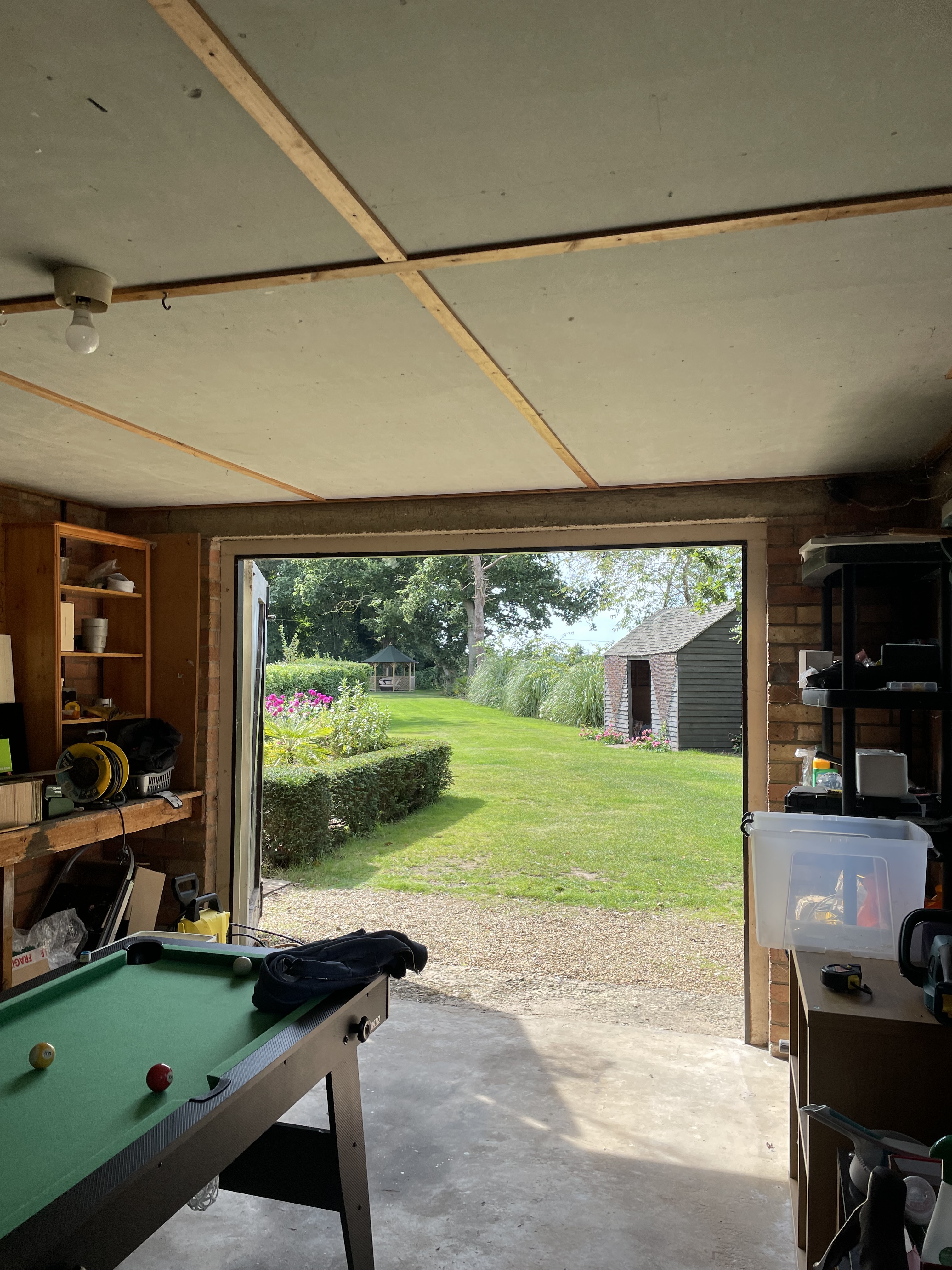

Consider clerestory windows. i.e., high level ones that you can’t see out of but they do let in the light.
First cautionary question before touching that ceiling is, is it asbestos? From superficial appearance, and given the current function, that would seem to be a distinct possibility. If you don’t know then nest contact a local asbestos testing service to check. Absolutely vital if you might cut, break or drill it at all. Some forms of asbestos are particularly hazardous if dust is inhaled, even in very small amounts. But this seems familiar - was it you who started a similar thread a few months ago?

Aluminium faced polyurethane foam board (e.g. “Kingspan”, but there are several cheaper brands just as good) is the most cost effective thermal insulating where space is a consideration. I’m not sure what Building Regs currently require (and for use in winter I wouldn’t want lesser insulation than that), but likely at least 100mm. It has minimal acoustic insulation properties, for that mineral wool is better, and the higher the density the better (slab type, 45kg/m3 upwards). For same thermal insulation you’d need of the order of 30-50% thicker than Kingspan type (depending on the specific mineral wool product).
You won’t be wanting to lower the ceiling height at all, as room is already quite low and you likely need to insulate the floor, raising it. Replacing the ceiling boarding with a staggered double layer of acoustic plasterboard would be helpful if the joists are good enough fir the weight, and with a thick layer of high density mineral wool 45kg/m3 or even 60 lying close-fitting on top, the thicker the better but with an air gap above as well. Adding an Acoustiblok membrane above would be good - though as that can be done above current bedroom floor it could be added as an extra if the mineral wool approach proves inadequate. I don’t have comparative info as to the effectiveness if one used as an alternative to the other.

Regarding insulation, what sort of construction is it? With cavity walls you can usually apply internal insulation boards or just plasterboard directly to the wall if required. If solid, you can’t do that as any future damp would be trapped inside the wall, causing problems. So you would normally build a timber frame to hold the insulation with a void behind it, which loses more space.
Looking at your photos the ceiling looks low, although there may or may not be some space above those boards. It’s hard to see how you could add acoustic and thermal insulation without reducing the ceiling height too much. You may have no choice but to dig out the floor, and lay insulation with a new concrete screed on top. Building regs usually require about 100mm of floor insulation, although they may allow less where that would be impractical.
