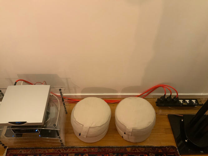

A very old Russ Andrews for me, wayyyyyy off to the side :smiley:

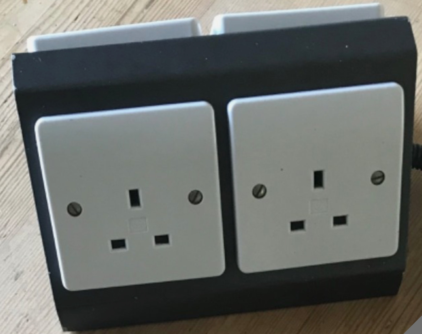

Ok. So whilst I’m waiting for the Mark Grant one to arrive, I thought I’d investigate building my own! Had t really considered it before posting but I now really fancy having a go having seen other people’s efforts!
I liked the look of the Russia Andrews back to back block and I think it will look very neat with my system. I’m thinking of these components and realise people will have thoughts!

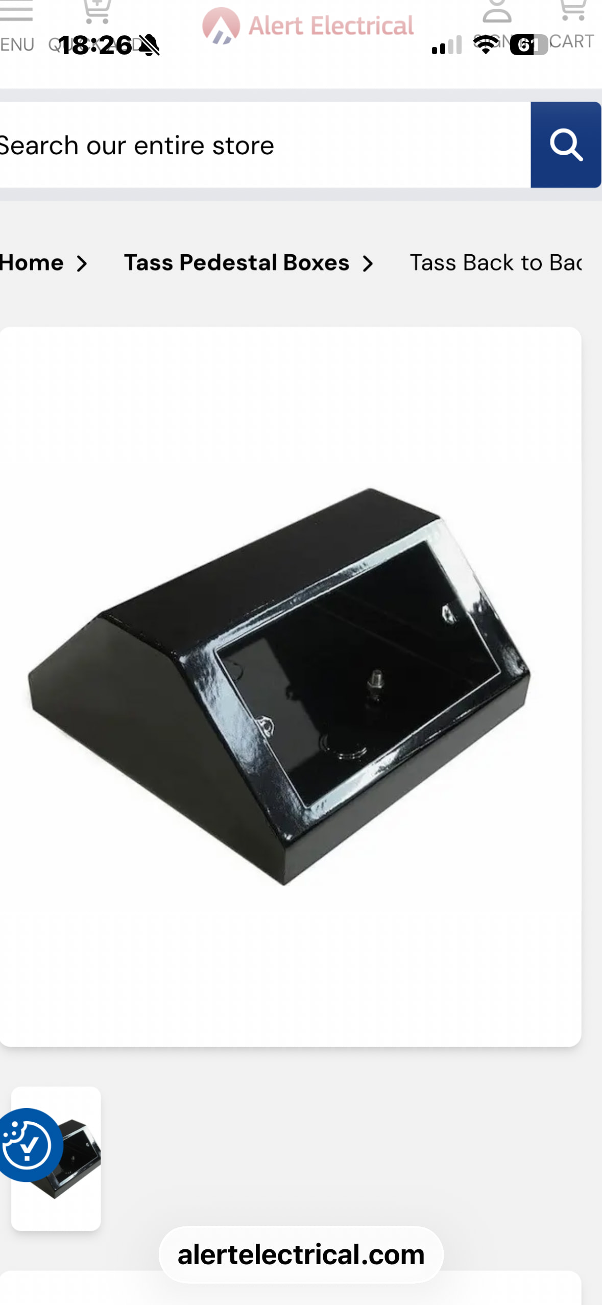

This is what I was aiming for (or similar), but having now invested a not inconsiderable sum on full fat power lines (yes I know!), I have realised that this configuration would not work as they are so stiff they would lift the block off the ground. I could raise it up but that would look daft. I could invert the plugs like Russ Andrews does, but again I think that would not look as neat as a flat block. This solution would have worked beautifully with the power line lites, but I have replaced them all.
I really wanted to make this block (I had sourced all the components - about £50 and borrowed a stripping and crimping tool) but it’s not going to work. No point building something like the Mark Grant one I have coming, so unless things change my little project is at an end. Thanks to all for advice and interest.

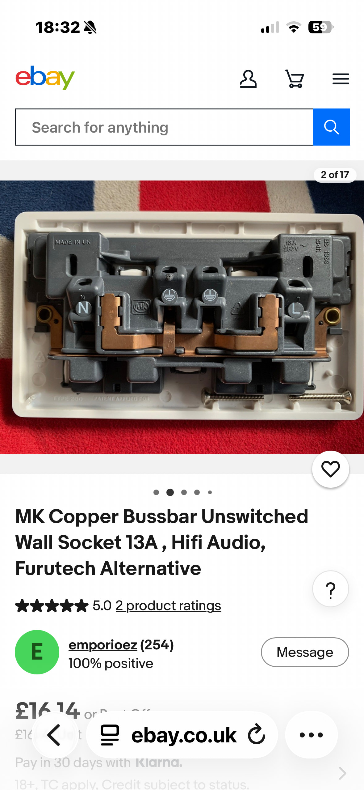

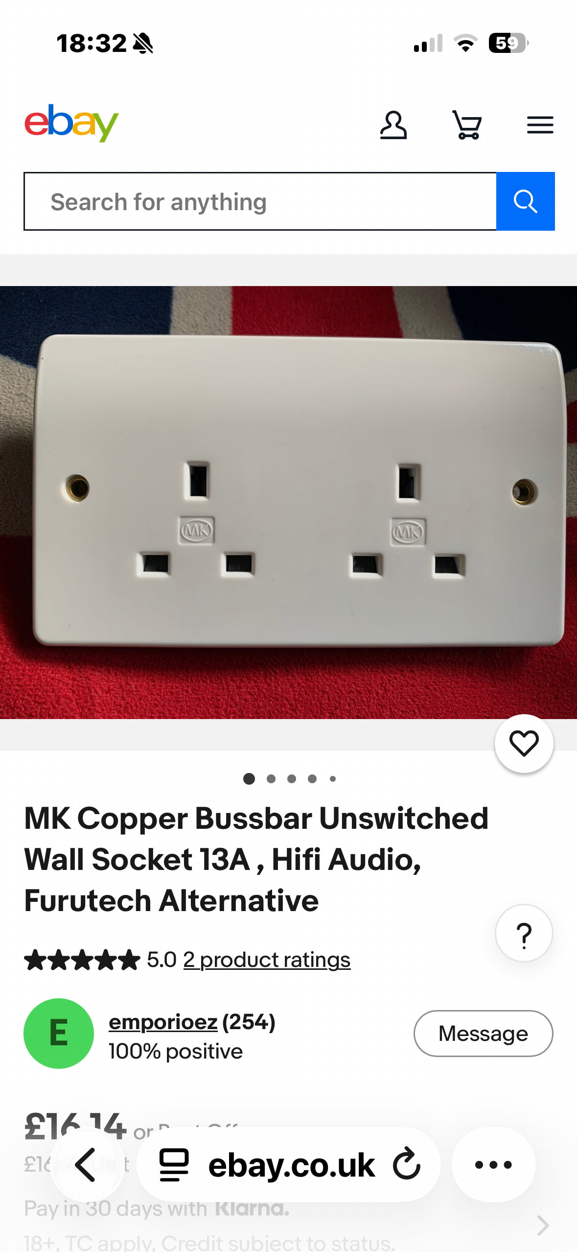

It was 8 months because I wanted everything right. Start off with the question ‘what is the best postion for the mains plugs relative to the system?’ My answer was 1.5m up on the wall, to let the Power Lines drop perfectly without touching anything. So I want a block of 6 sockets 1.5m high, directly fed from the cu, isolated from the wall, using the best sockets, connected together using 3x c101 copper rails all housed in pretty exotic hardwood… takes time, no rush and 17 years later it’s still there and I haven’t thought or seen a better method.
