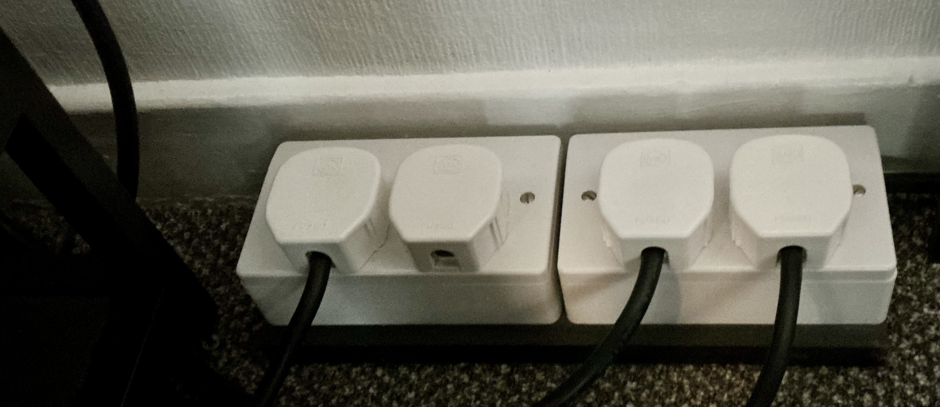

Looking at todays Forum Factory visit photo’s, I was pleased to see the Naim Dem Room power block is made with 3x unswitched double MK Logic Plus sockets. Looks like they recognise quality over BS. … just like myself..
Yes that’s why I posted it. It looks just like @Skeptikal s and yours.
“Looks like” is about all.
Naim’s sockets are MK Logic but not Skeptikal’s, but they do look like good quality.
His photos show he has wired them in “daisy chain”, the downside of which is the amp load from one unit can affect the others, hence the discussions on preferred socket order.
I suspect Naim also have theirs wired the same simply because there is no space inside the box for junction block(s).
As I indicated in my previous post, mine is wired in radial.

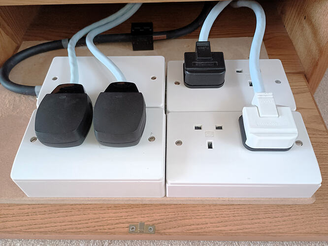

Hi @Skeptikal ….. you might have MK sockets, and if so that’s my mistake, …. but for sure you don’t have 2 Gang, this means double (x 2) outlets, yours are 1 Gang.
My first block had double gang MK LOGIC PLUS double unswitched but my New one has three single 1 gang MK LOGIC PLUS single unswitched sockets.
:thinking:

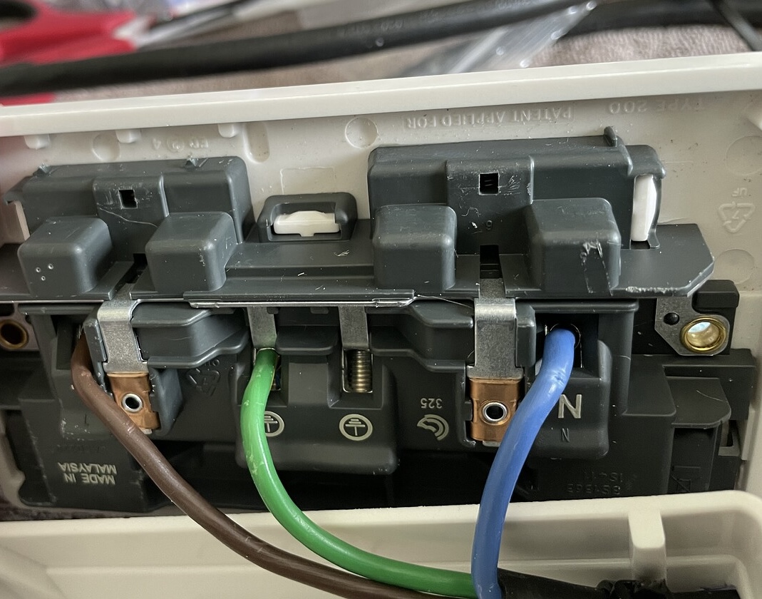

Yes I was referring to your latest single socketed block pictured in this thread. I did not see the slight chamfer along the top edge of a MK Logic and the rear side looked different from my spare sockets so assumed they were not Logics. My Spare MK’s are previously used made in UK versions so it must that yours shown in the pics are new and made in Malaysia.
Correct :+1:
These are with traditional.
Terminals.

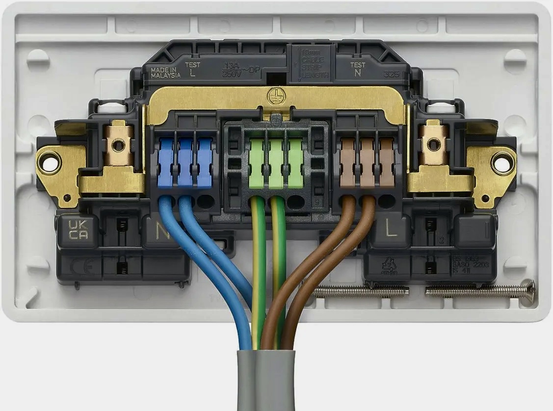

I wouldn’t touch the new Rapid Fix efforts. :-1:
I believe that the Rapid Fix spring loaded contacts make a much better contact area, and over their life they maintain a continuously constant contact with solid core wire as they cannot suffer with loose screws (that they don’t have)
I’m not sure how they behave with multicore flex, I guess they will be better or must be used with ferrules.
