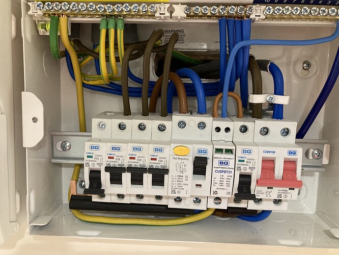

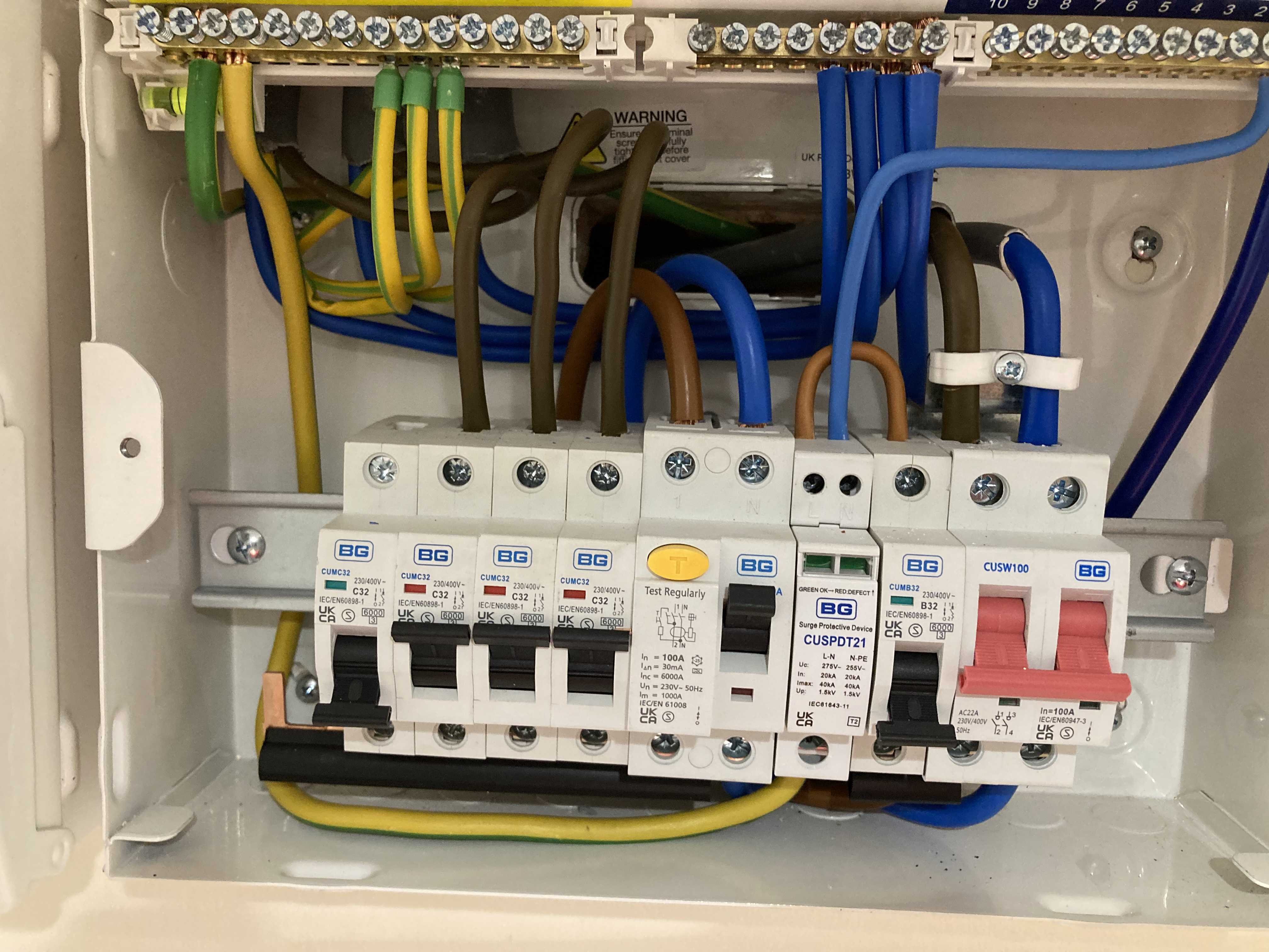

Hi Mrhappy I notice you mention star earth with regards to your circuit could you elaborate on the wiring layout.
Silverback, the sockets are side by side and the 10mm t+e feeding each one is of equal length. The earth conductor in the 10mm t+e is 4mm, so I have added an equal length of 4mm earth cable from each socket to a single 10mm earth cable that runs back to the same consumer unit bussbar as the sockets.
Okay that’s clear, I have 3 unswitched sockets fed with 3 equal lengths of 10mm t+e running off a new totally separate consumer unit.
Not sure I totally understand why you have added the extra Earth cable , have I missed something here, just curious.
Not at all, what you’ve done is correct, but I wanted to add the star earthing that I kept hearing mentioned.
Thanks for the reply, understand a little more now.
My electrician who is a good friend couldn’t be stop laughing when I asked for his help, “ you lot are crackers!” accompanied my more laughter but it was something I always wanted to install, so we got there in the end, every little bit helps.
