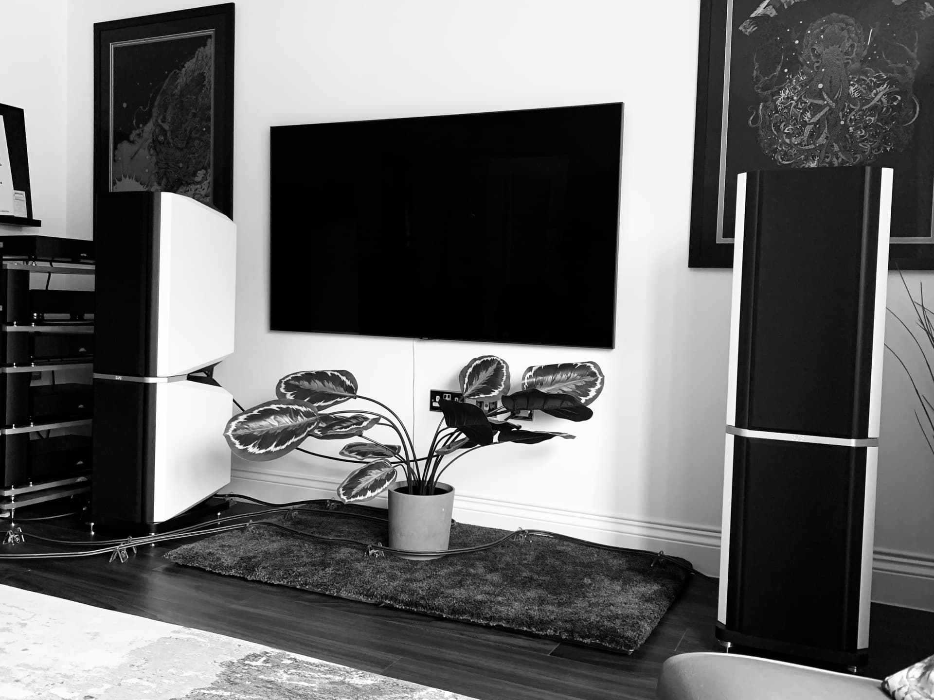

@PeterR would you consider the Fraim to be a side wall? The actual wall is about 70cm behind the front if the Fraim! The stack is quite high though, not 808 high but about 20cm lower.
Any chance of a picture please? ( you know you want to :rofl:).

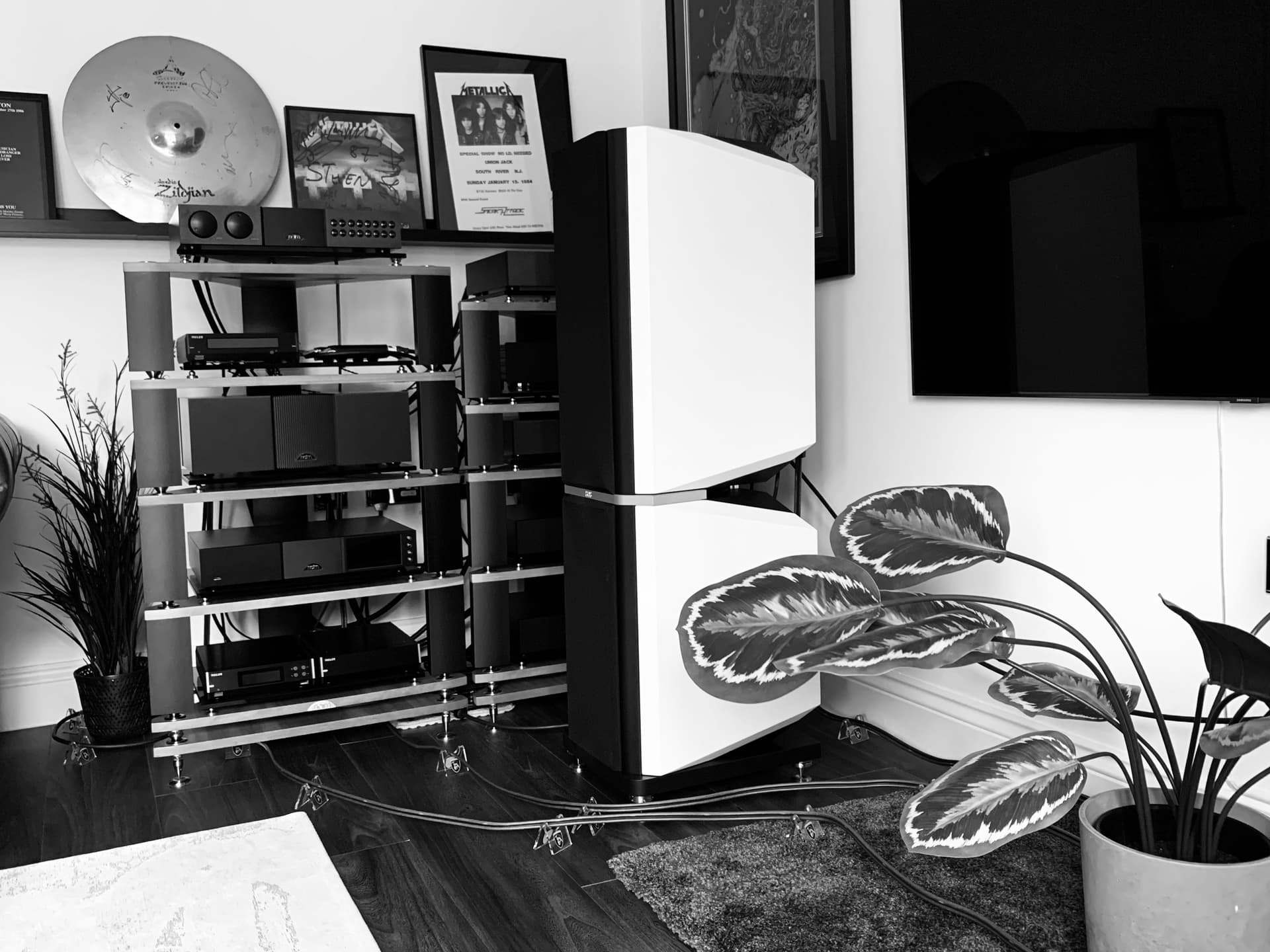

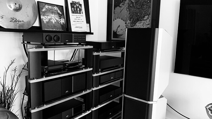

@PeterR just lying in bed with my 5 year old so the above are pics from my camera roll! Probably not ideal and pre moving the fraim side speaker in a bit. No front on shots it seems!
Whilst everyone analyses the layout I’ll just say that those look like very fine speakers :slight_smile:

Whether tweeter or sides used for distance between speakers, those fine differences will be overshadowed by room specifics. And getting the right speaker out of that corner will probably be more important, if you can

@Suedkiez move the non fraim side speaker in further you mean? Its further from the wall by about 10cm than the other is to the Fraim. I guess the Fraim does not count as a wall??
The Fraim on the left is much less of a mirror for 1st reflections than the wall/window on the right*. I can’t imagine not having pretty bad 1st reflections with the right speaker. It might help to toe them in a bit - even if Kudos generally doesn’t want it, but your placement options seem pretty constrained and you are going to have to find the compromise that works best / is least objectionable. Best to try in any case. Or maybe some absorption panel on the wall.
(Edit: Though in the 3rd picture they apparently have more distance than it looks in the 1st pic)
For any other speaker squeezed into the room corner I would also be concerned about bass boom, but the Kudos being pretty tolerant might be able to take it.
It all depends on the room. With a system and speakers on your level I’d measure it if it was my system and room.
* Though it’s probably not ideal to blast the Fraim and units with sound if their construction is trying so hard to keep vibrations away. But I get it, real-life constraints, you do what you can :slight_smile:
Hi Steve, tell me about the Zildjian…

Hi Steve, your front wall ( speaker wall) looks less than 4.5 metres in width in the photos?
In my view the speakers simply aren’t allowed to breathe properly.
The location of all your boxes on medium level Fraim is literally occupying the left hand corner, which beyond constraining the left 808 surely induces unwanted vibration into your Fraims. Beyond dropping the height aided by standard levels or 3 stacks even, is it at all an option to move the stacks completely away from the speakers??
Obviously working on the ‘the popularity vote’ here :face_with_hand_over_mouth: Peter
Those speakers need room to breathe Steve, they must boom where they are now. I would sacrifice some of the space between the speakers to get the speakers more into the room.
Can I ask, how close are they to the rear wall?
Can I also ask, what is hiding on the left of the system as you look at it?
